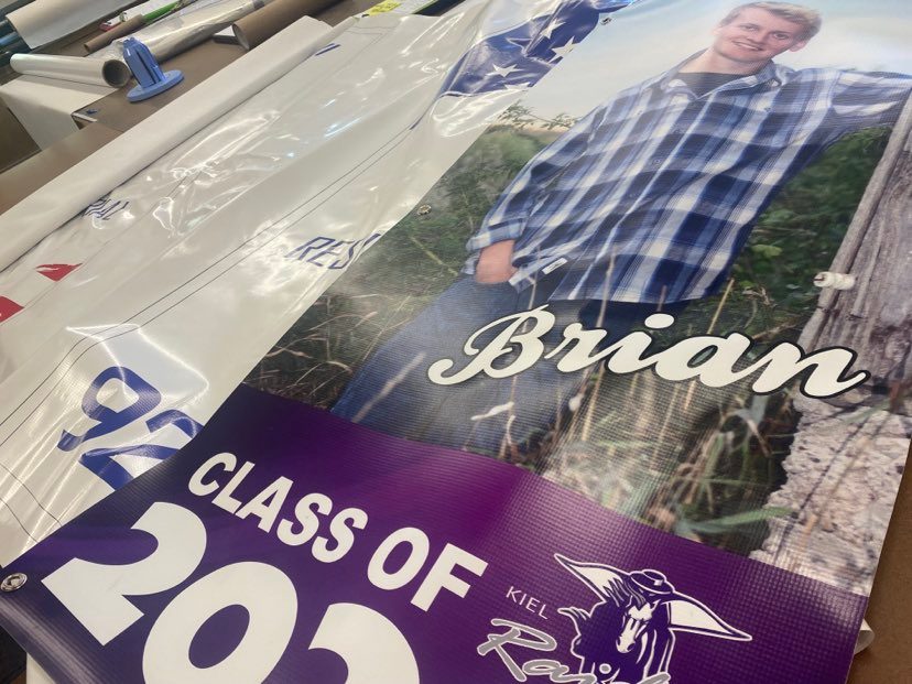

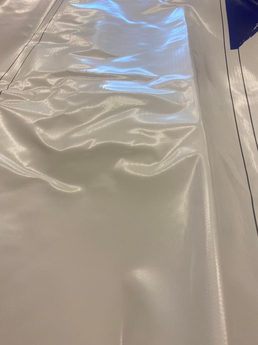

Besides the printer issue which Ikarasu seems to have figured out, here is what I'm talking about. The white banner material is the stuff I bought. The Brian banner is from Signs365, it's smoother and lays better. I do realize mine is gloss and theirs is matte...I think I would like to switch to matte also. Am I being too picky maybe?
those photos look like a setting issue instead of a material issue.
As suggested, try adjusting your setting
Yes, we dropped the GLOSS banner and use MATTE, works better and if we ever have to outsource, there is better likelihood of banners matching
