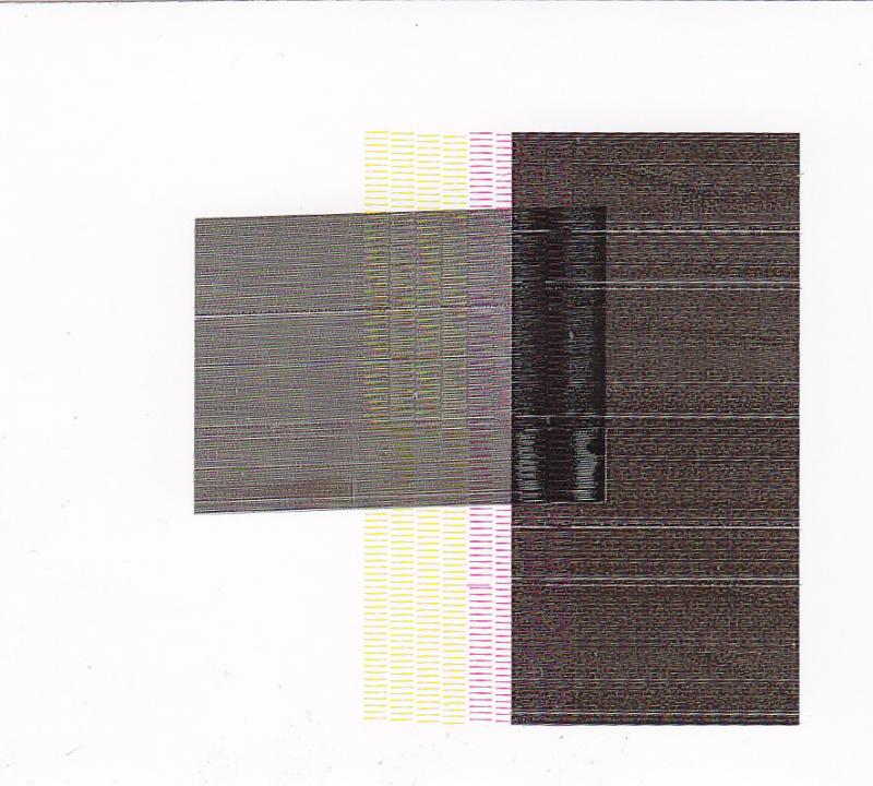

I changed the manifold on one head of my SP-300 and now that head is working fine.
Please take a look at the test print and let me know what you think is causing this problem.
I have also replaced the cap tops, wipers and cartridges.
I pulled the ink from under the cap tops and it flowed with no problem into the syringe.
Thanks Jim

Jim Hill
Pease take a look and let me know what you think
Not sure how to correct this problem and I really need input and advice before I start making any adjustments.
Thank You. Jim
otctech
Check all your cables running to the head and make sure they're attached securely.
I've seen this when I didn't have one of the ribbon cables on the head properly seated.
I've also seen this when I had a bad head once, and a bad head board once.
Jim Hill
Otctech Thank You !!!!!!!!!!
I had removed only the lower part of the ribbon cable off of one head but some how when replacing the dampers I must have just moved the upper ribbon cable enough and that was the problem.
I had already looked at the bottom part of the cable to make sure it was plugged into the head but I did not see the top part of the cable which was just not plugged all the in.
The printer is now printing perfectly again thanks to you and a few others who have helped me learn to replace the dampers, wiper, scraper and a manifold on one head.
I could not have any of this without the support that this forum provides.
Special Thanks Jim Hill
