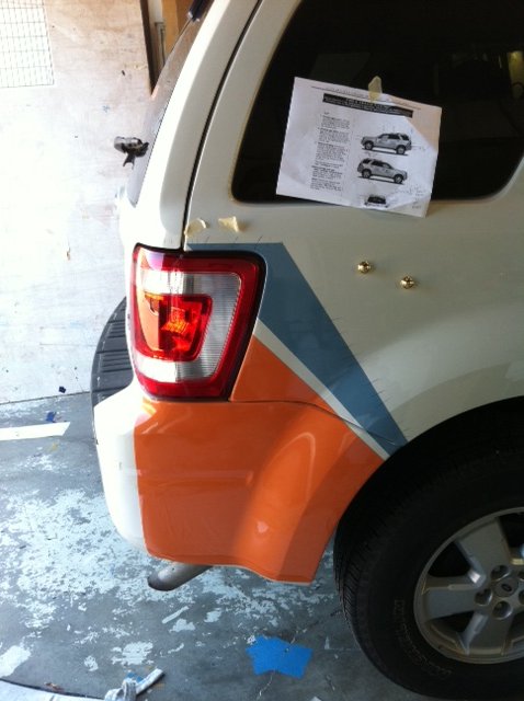

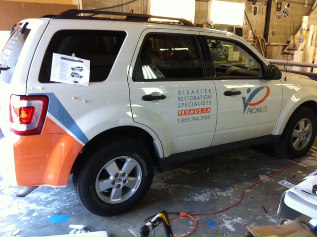

    yes...common sense takes over when you stare at it long enough. I have never done something like this before. I have put wrap material and lam on the sides of a truck like a photo or logo but never in the true sense of wrapping. Holy cow I have a lot respect for you pros. I am just doing this rear quarter panel with a spot orange amd I cant beleive how much lifting and reapplying it takes...mind you theres all sorts of issues in this area.
    I got to figure out how to charge for this, it takes a long time...... now off to the second side
    here is a couple of pics. the side graphics I had to digitally print completely as the colours dont exist in pre made vinyl

    with experience that should not take longer than 45 minutes to an hr. you'll get there :)
    By the way from the pictures looks like you're doing a stellar job.

    yea well on close inspection as the orange nears the bottom it is far from stellar. The vinyl by that point is so worn out from lifting and pulling and lifting it is really hard to get it down without some form of crease happening. I am at the bottom on the other side now and the same thing seems to happen. there must be a secret to doing the the last 2 inches of vinyl. At least it is at the bottom and sort of curved towards the underside.
    I am to old for this crawling around stuff. I have 2 more of these escapes to do and am considering calling in a seasoned pro to put that orange down. Might be worth it
