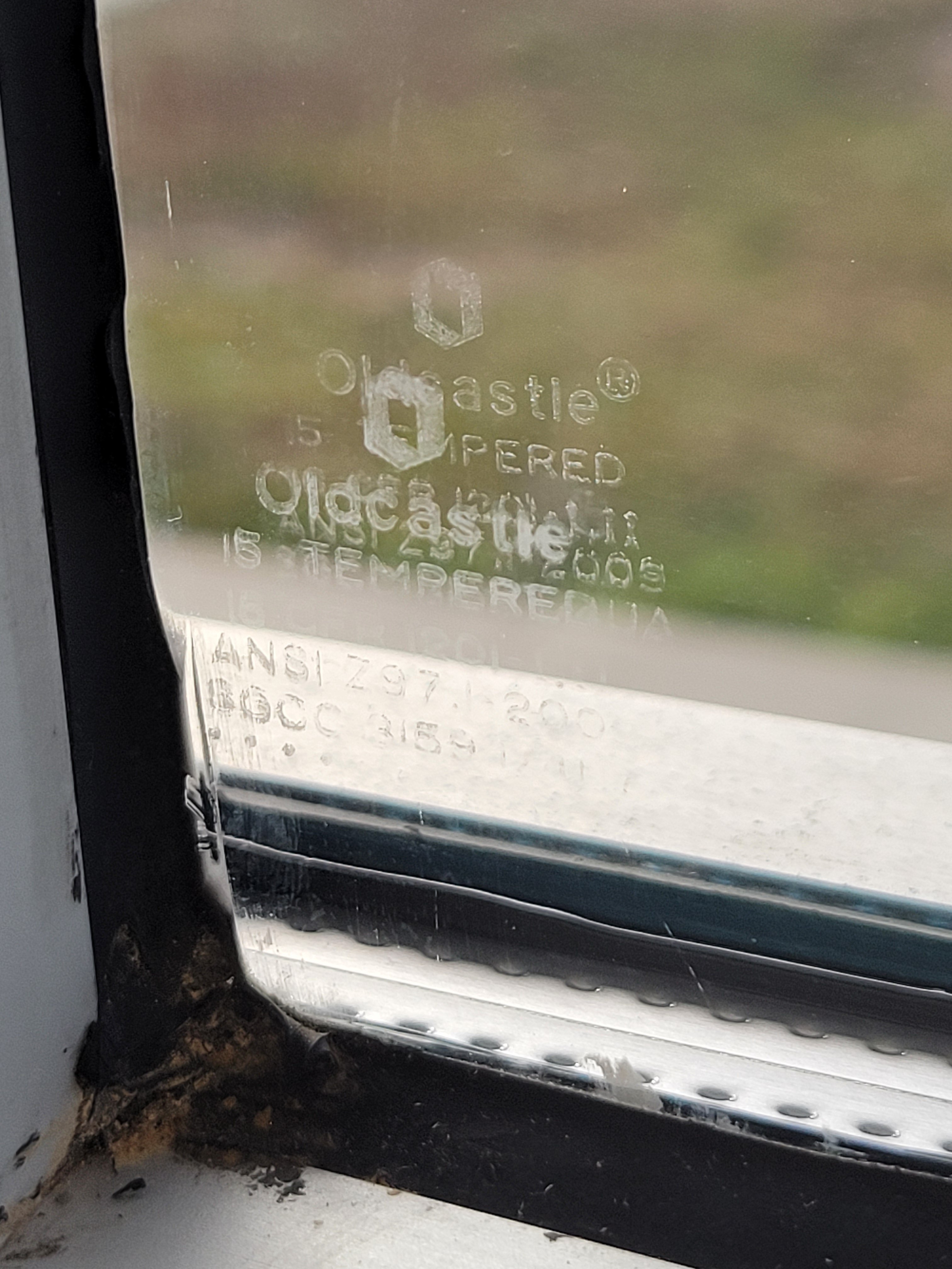

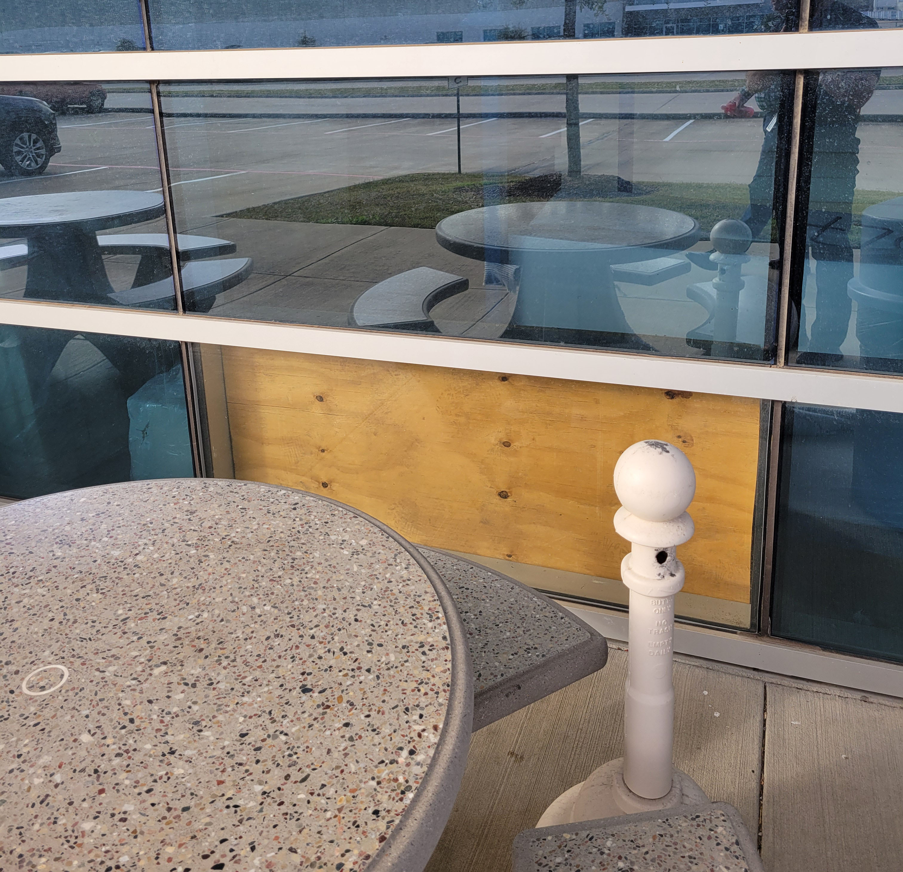

A customer replaced a storefront glass panel, the original glass has a blue tint while the replacement glass does not have any color. Customer wants to get as close to as possible to the blueish glass using window film. Doesn't have to be perfect match. Any ideas on what film would work?
Original glass is Oldcastle brand

Can you tell if the original glass has a tint film? Might be SolarBlue tinted glass. Go to Old Castle's website and send an inquiry about how to match it, might get lucky.

Print on some clear, a color fade from 0 to 100% cyan, slap it on the window (remove the board for a fair comparison), and see if anything hits that hue. Or hop on amazon and look for some slight blue tint.

The original glass does not have tint film, the actual glass is colored. I've reached out to the glass company, the replacement panel is from Oldcastle so not sure why they didn't match. Landlord, builder etc have no clue

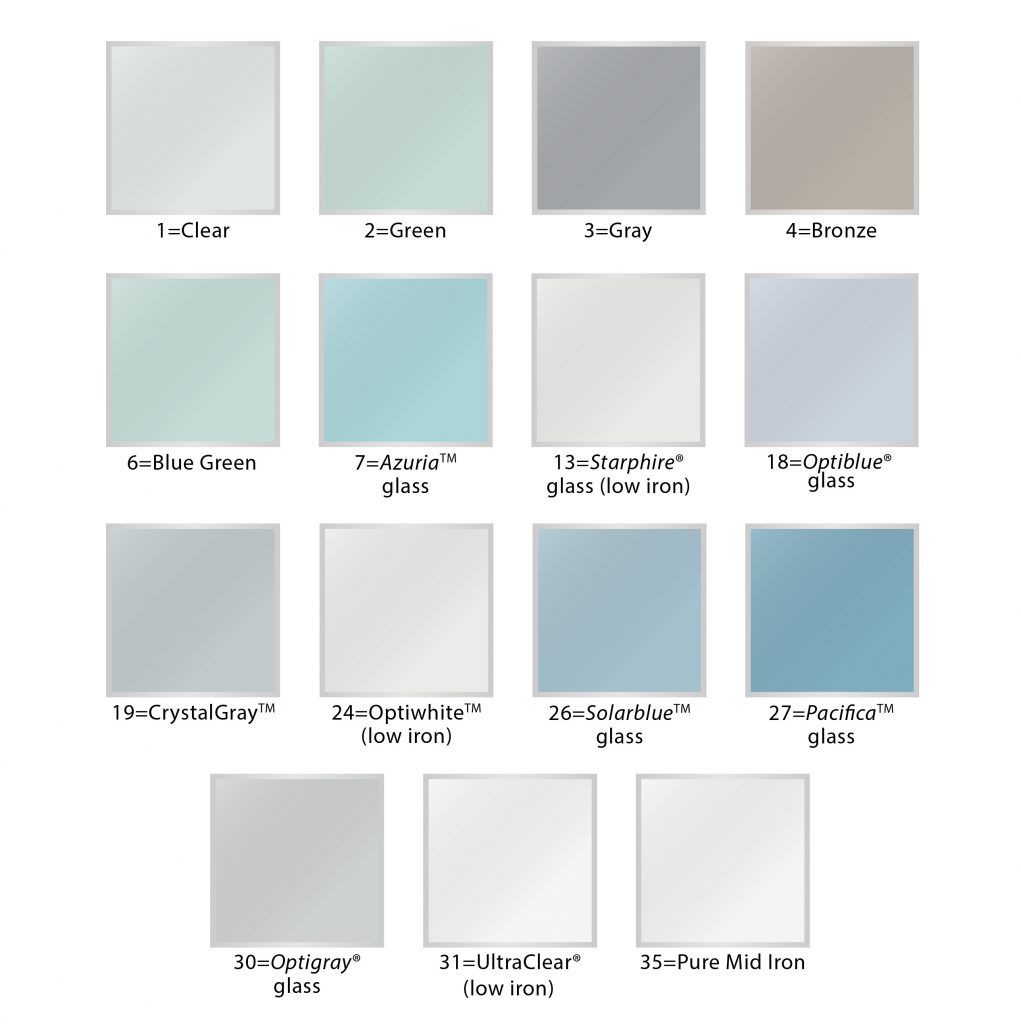

The tint films available are most likely going to end up being way too intense blue, or too dark to come close to matching. Best option is finding a glass distributor in the area and have it matched, it's probably Viracon, they're the biggest mfgr in the business for colored architectural float glass, and have standard base colors, the chart should give an idea of what color it is. If the building owner has access to the architect or contractors to get the info on what was used, it would make life simpler. If they don't want to go through the expense/ hassle of replacing it again you'd probably get a closer result doing what JBurton suggested, match the color & density on clear film, which may, or may not be easy to hit the color, but it'll probably get you closer than a tint film.

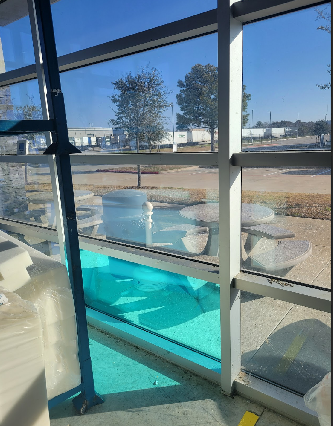

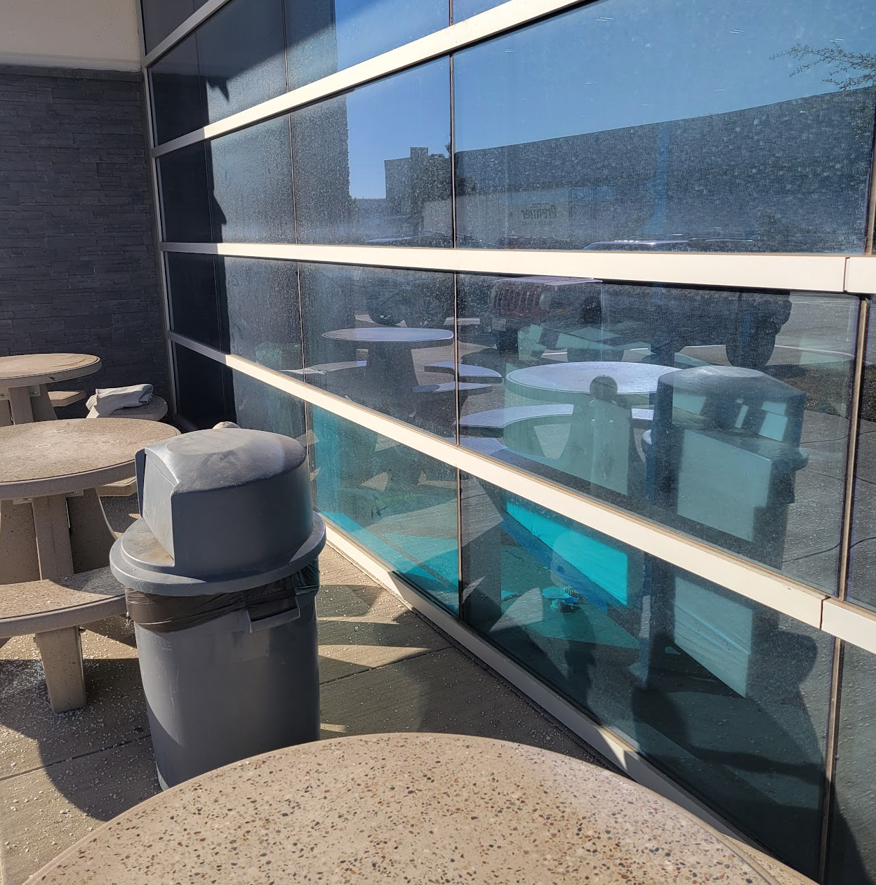

Install complete, glad I wasn't the one that selected the tint material.
Doesn't look too bad from the outside if there is nothing white by the window on the inside.
Amazon tint Film went on very easy but not sure how long it'll last/not fade/bubble up. Wasn't very sticky at all

Figured the blue would be way more intense, colored glass isn't made to make the world look blue like tints are. At least they picked it, and it's at ground level where its not super obvious.
