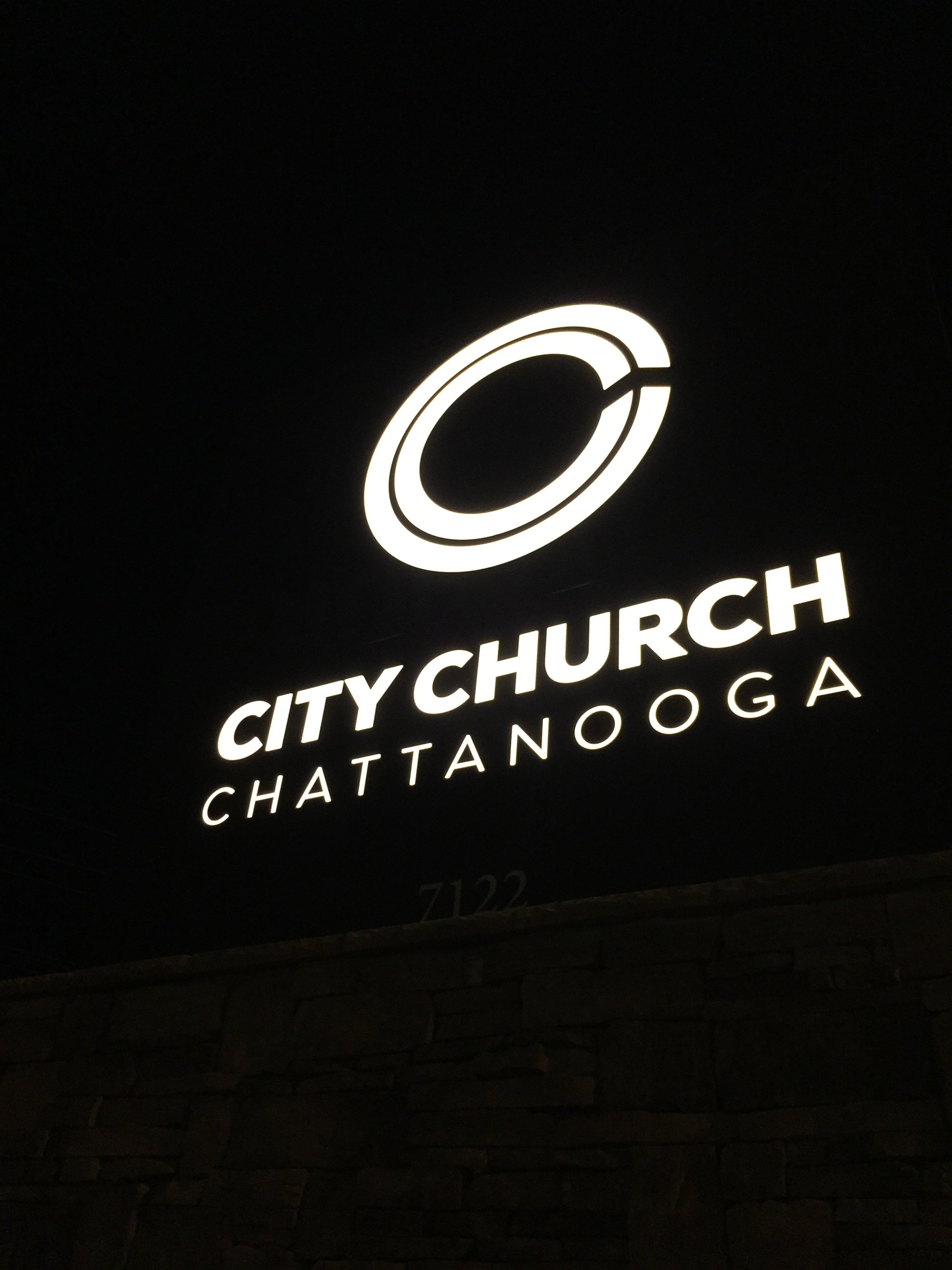

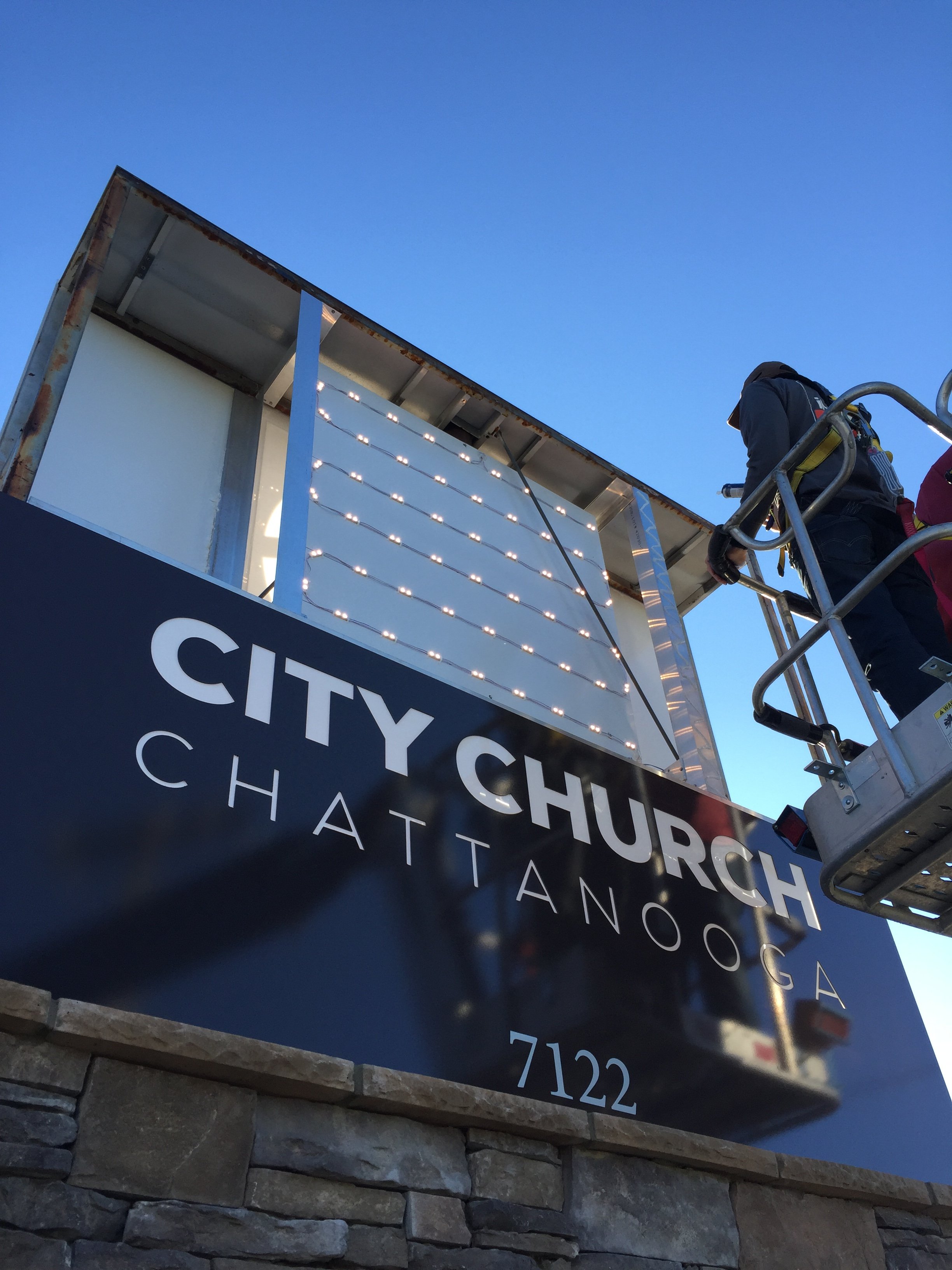

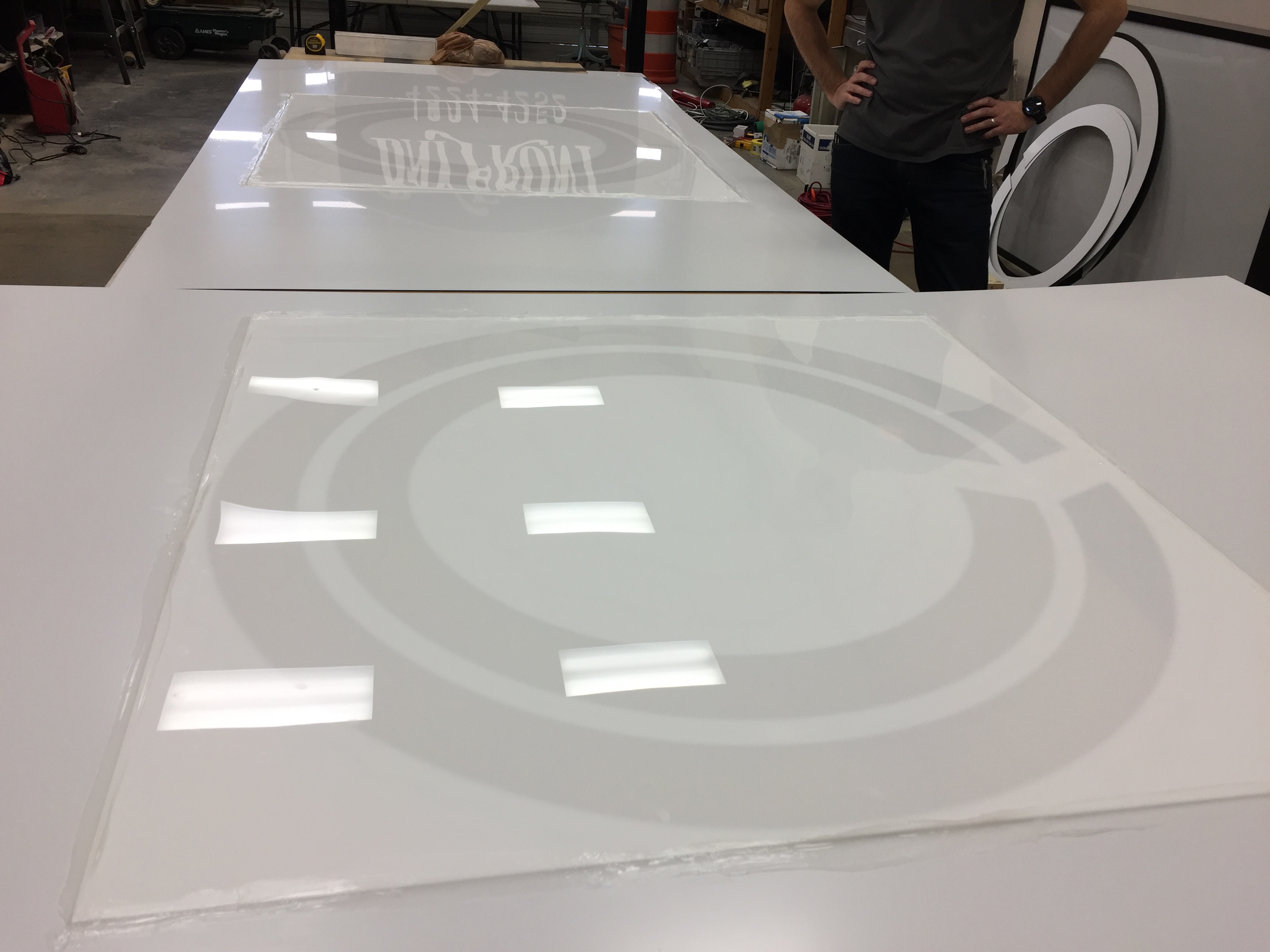

    We have had a failure with this sign. The acrylic white backer separated from the DiBond panels in areas. We used tape (not VHB) and silicone adhesive to mount the acrylic to back of ACM panels.
    The two acrylic panels per side were 4’x4’ for top panel logo and 2’ x 7’ for bottom text. Overall sign was 8’ tall x 9’ wide.
    Since we can’t use a stud welder with the DiBond and secure with nuts and fender washers, what would be the best way to bond these dissimilar materials together for outdoor longevity?
    I would be so thankful for any help with this problem.

    You need way, way more vhb and way, way more silicon under that acrylic. Just putting around the edge won't hold it. Use 1mm vhb and large dobs of silicon so it spreads out under the acrylic.
    I'd split that bottom acrylic panel into 2 or 3 pieces as well.
    Run a continuos bead of silicon around all the edges.

    I had the middle piece of the “O” fall off sign. Along with other areas separated as well. I noticed all the silicone was stuck great to back of DiBond, no trace of it on the acrylic backer though. Great idea about making smaller panels for backer. Will do that, hopefully take a lot of weight off as well.
    We will definitely use VHB and a lot of it next time. We used Iron Grip Silicone from GE. I don’t want to use that again with failure had.
    What silicone do you use? Or two part epoxy? Worried about expansion of materials.
    Thanks again!

    Unless I am reading this wrong, shouldn't that sign have a retainer?
  9. BrianH311
    BrianH311 New Member
    11
    2
    3
    Apr 14, 2018
    Tennessee
    Usually, yes. This is an extremely old sign that had flush mount .080 aluminum faces.
    Being such a large sign, we are having to use two separate panels per side. If it were a smaller one panel sign we could have added retainer and slid in single face.

    A retainer can still be added to this sign. I am confused as to why there are two pieces of polycarbonate glued together.
  15. BrianH311
    11
    2
    3
    Apr 14, 2018
    Tennessee
    True. Hope to add retainer soon. Will post updated pics when finished.
    We are using 3/16” white acrylic for backer on each panel. The other white is the back of DiBond face.
    Sent from my iPhone using Tapatalk
