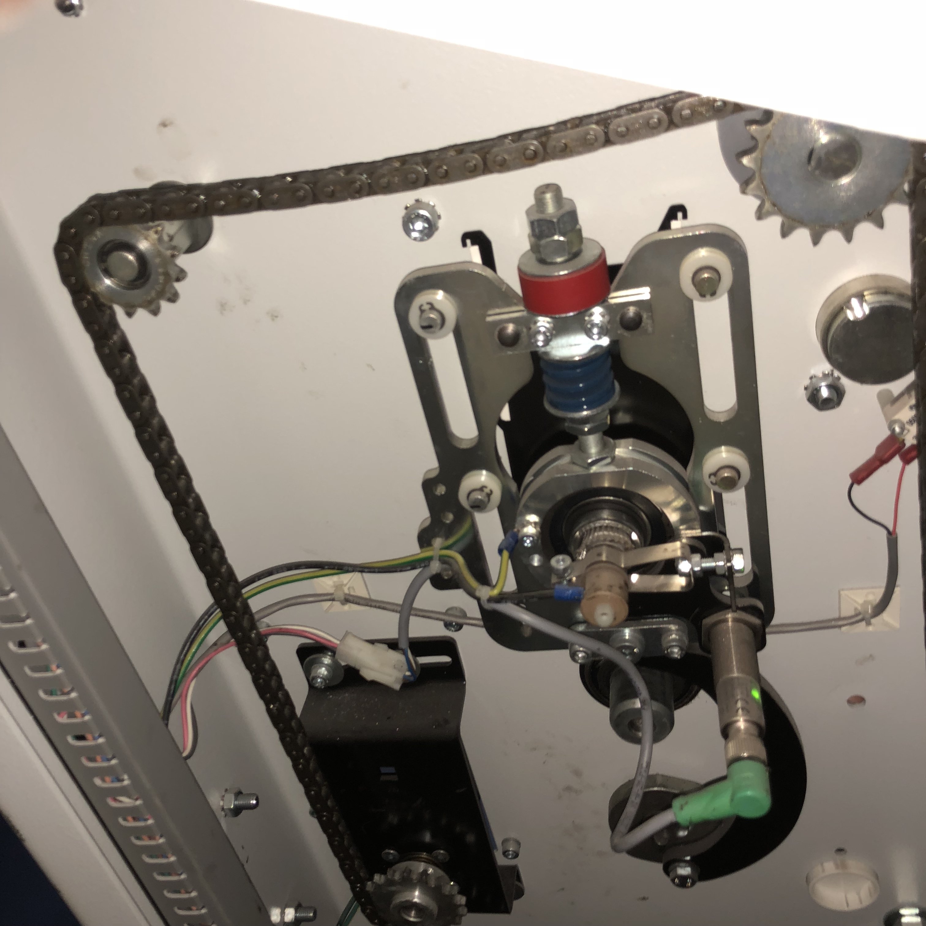

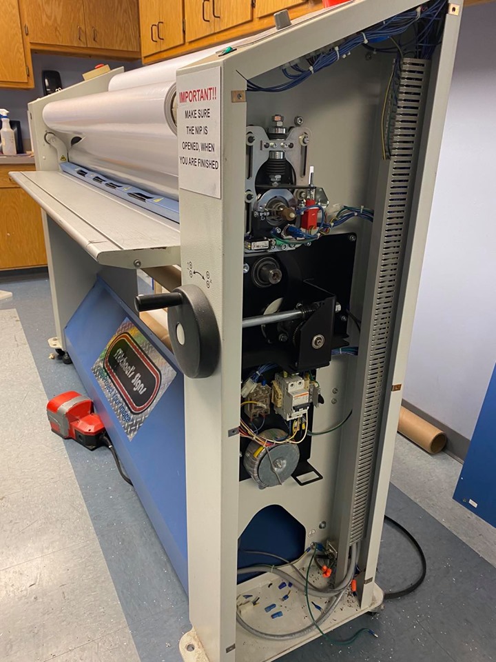

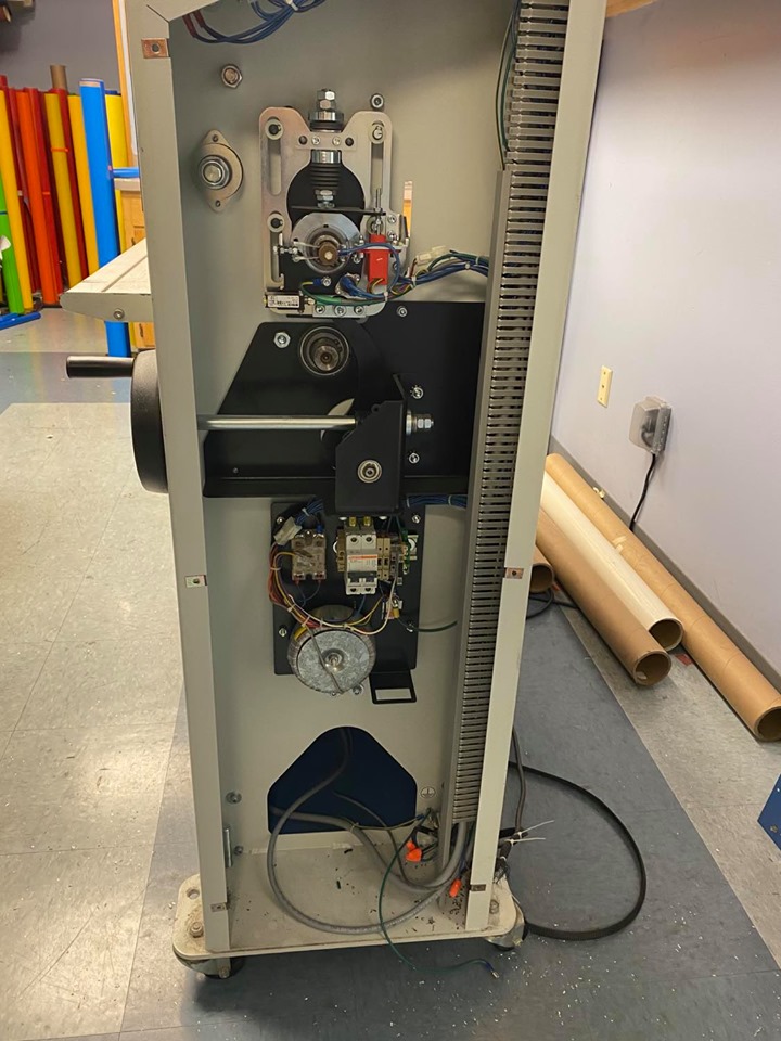

Hey guys can anyone explain to me what makes the nip rollers rotate on the seal laminators. This is the left side panel does everything look normal

my seal has been in storage unit for a couple years
if the chain is rotating, see if the shafts are as well
a bearing can be frozen, a set screw can be loose or missing, a woodruff key can be broken

I checked that, everything is rotating when i hit the foot pedal or forward and reverse on the panel. So i guess the control functions work. The heat works as well. *There are no sprocket or chain attached to the nip rollers. Does the media make the nip rollers rotate from the unwind reel? I’m So lost here. Hey I’ll pay you $40 to open up your side panels and take pictures i want to compare and see if my machine has something missing. Let me know if you have $Cashapp or vemmo.

thread piracy, but i'll abide. only the bottom roller rotates via motor, nip pressure rotates the system.

The NIP is set from the top roll. The lower roll is chain driven and turns the top roller. NiP correction is set on the top nuts in your photo. use a sheet of paper at both ends of the roller to determine equal Nip at each side. You should run a full roll with no drift
