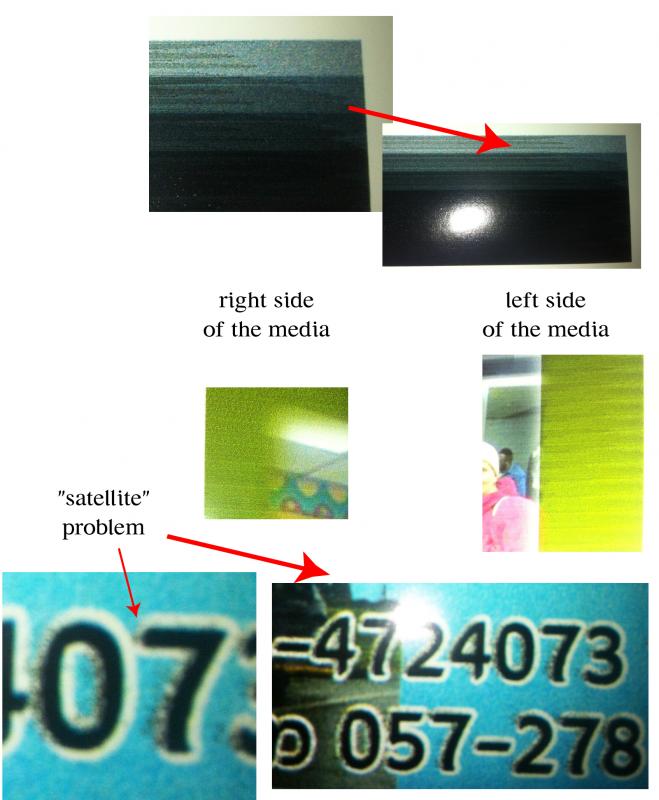

    got a wierd problem on our jv3-130 spII

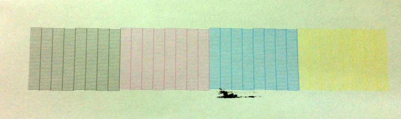

    heads test-print comes out almost perfect ( 2-3 lines in the magenta fires wrong)
    but, when i print the "dark" aries in the graphics, especialy the black, have 1-2 mm banding and, alot of "satellite" (lots of dots outside smooged outside the graphics) about 2/3 of the far side of the graphics.
    from what ive seen so far, the "lighter" aries in the graphic dont have bandings or satellite problems.
    few things changed since last "good printing":
    1)my boss moved the machine few days ago one floor up ( body alone and leges alone).
    2) hade problem with left side of the black head testprint (didnt print)
    and we replaced the filter with a smaller one with bigger "filter" inside.
    after few prints , the left black testprint didnt print again but after cleaning and fill-up, it printing good again.
    anyone have any idea why this happens?
    Thanks in advance,
    Refael

    no one answerd, mybe i wrote to much?...
    here are pics of the problem,
    any help will be much appreciated.

  3. JR-Folientechnik
    JR-Folientechnik Member
    149
    Mar 23, 2012
    Clean the machine! And try again! (moved machine!)

    took the head to the left side and cleaned the heads, did a cleanup, nuzzle-wash for 5 min
    no change...
