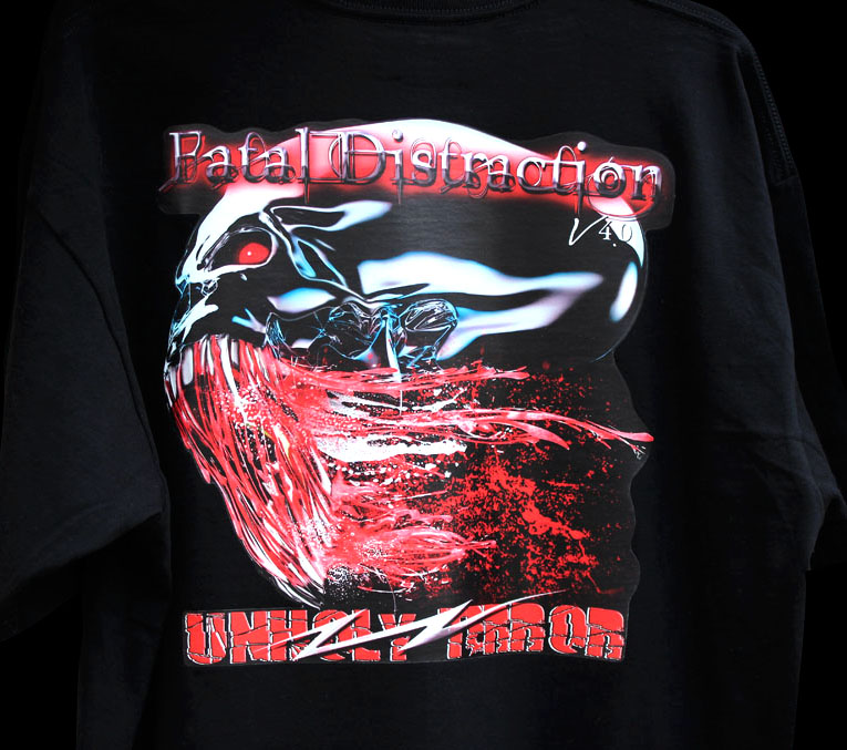

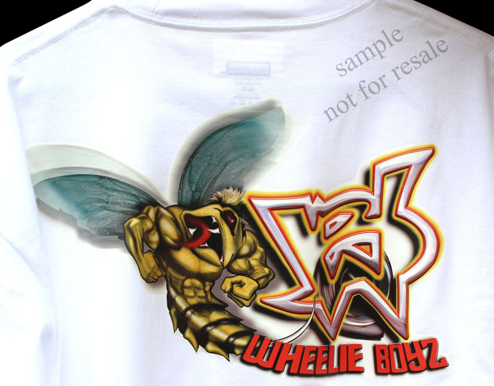

Just starting out and am using Rite-Media QEP Classic 15 x 66 Heat Textile Transfer #RM-QEP-1566 (still learning/testing)
Using the RM Quick Easy Print profile.
The saturation is awesome. (using premask and Teflon for mat finish)
settings:
res 720 x 720
mode: CMYK (v)
halftone: dither
interpolation: nearest neighbor
direction: bi-directional
head speed 400
color mgmt: Pre-Press U.S.
heat: 325 degrees F / 13 seconds
