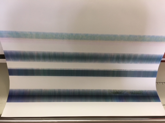

We have a Mutoh vj1604. Yesterday we went to do a print job and the following happened. we are stumped on the cause and would like any information on how to fix the problem.

Wow, do you know if there was any type of power surge or did someone trip over a cable? Have you done any updating of anything?

looks like a bad cable. If you've not been doing any service work on this, I would suspect the long trailing cables going up to the carriage from the main board.
Acrazy1

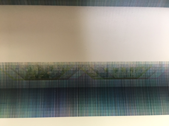

There was not a power surge that we know of. It worked fine the day before. Turned it on and tried to do the print job and got the print inside alot of plaid looking Stripes while printing. Trying to figure out where the problem is to fix. Can't find any thing that would give us any clue to what we need to repair.
bad cable on the carriage sounds possible. thanks we will look.
