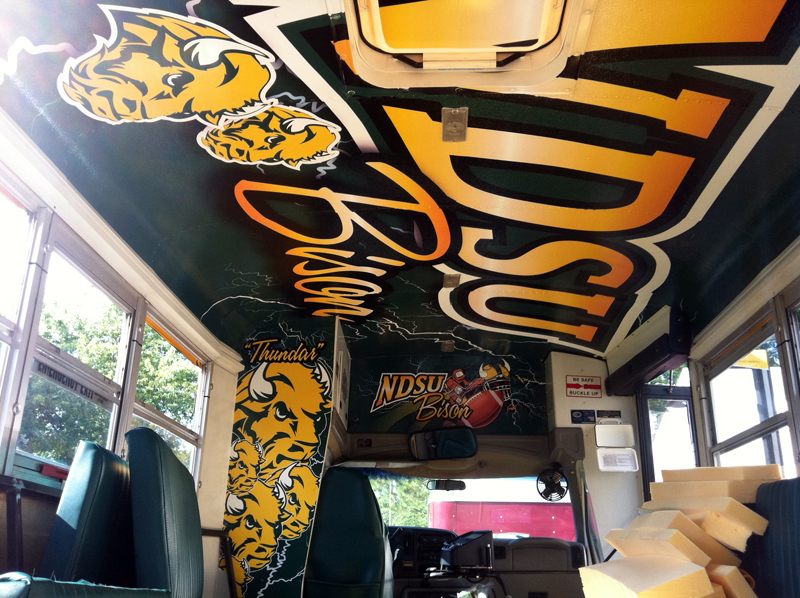

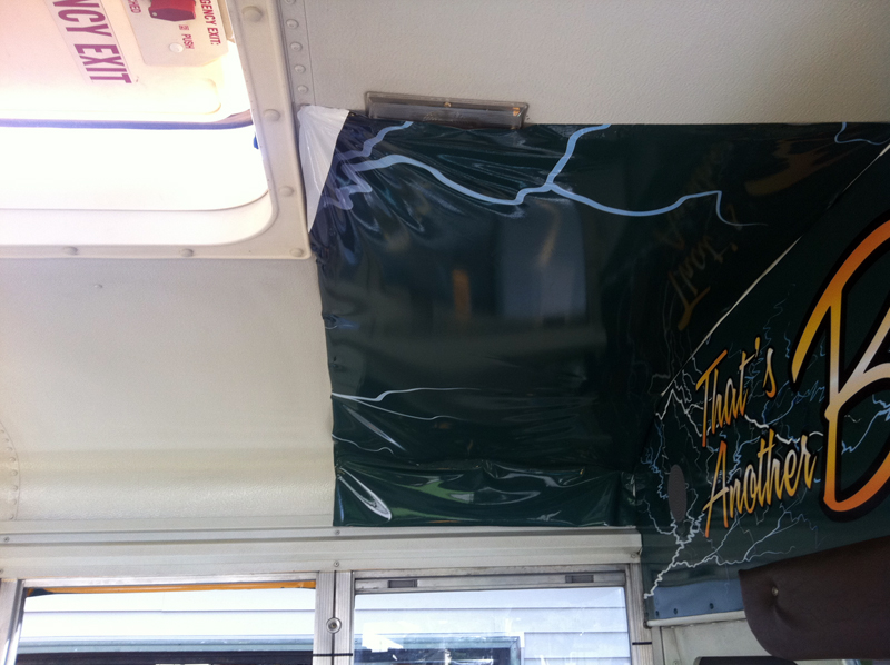

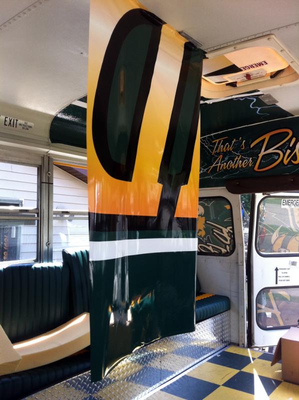

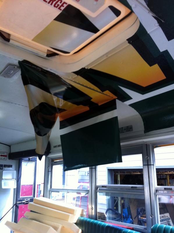

So I spent about 8 hours putting the skin on the ceiling of Thundar the Bison Bus. I thought about the process a lot and finally came up with 8 panels. Gravity sucked and only two hands means my neck and back are killing me. I have much more respect for Michelangelo. All I know is that cost is going to be twice as much as a normal skin I complete. One other thing.... never again. :toasting:
wow, nice job on a very intimidating install!
i'd have found a way to use sawhorse type ladders, plywood sheets and a creeper, so i could do the job on my back.
8 hours working over my head would drive me nuts.
i'm impressed!
