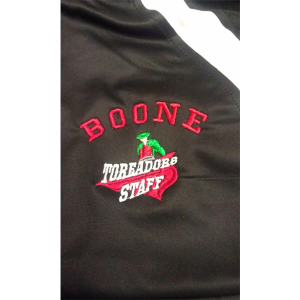

Also with John's the "grid iron" mask can present some issue to some machines out there. Embroidery machines have a minimum stitch width (for satin stitches) that is different and that's what creates problems for the smaller detail work. Now you can use extra needle penetrations to get the smaller detail work without running more thread, I've done that on some designs, however, for something like this, it would be lost. It's better if it's used not to add objects, but to define the object that it's on. The toreador stitch out is one that I used that on for the cape and the toreador. It cuts down on the total objects that have to be stitched out, but gives the definition of the objects.

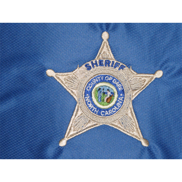

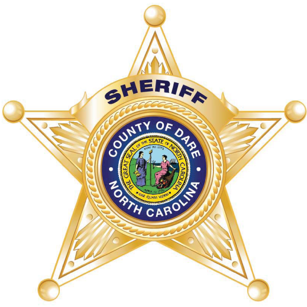

I found a better example of what I was talking about. This was one that I did for a member here a few weeks ago. I attached both the artwork they sent me and the stitch out of the file that I did for them.
The majority of the detail of the star is done with extra needle penetrations, so there aren't as many individual objects as one might think looking at it. More detail can translate to embroidery then one might think, but it's knowing what the limitations are for this type of production. Simple is best, but only thinking simple is also kind of limiting as well.
Oh, the copy: "COUNTY OF DARE", and "NORTH CAROLINA" are at that .15" minimum. That's pretty small, but you really don't want to go smaller than that.

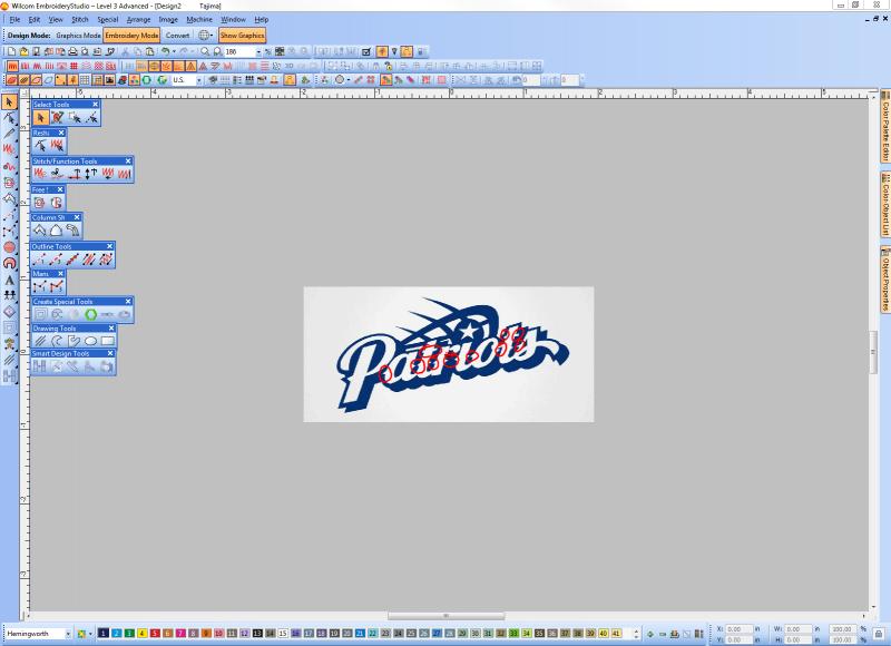

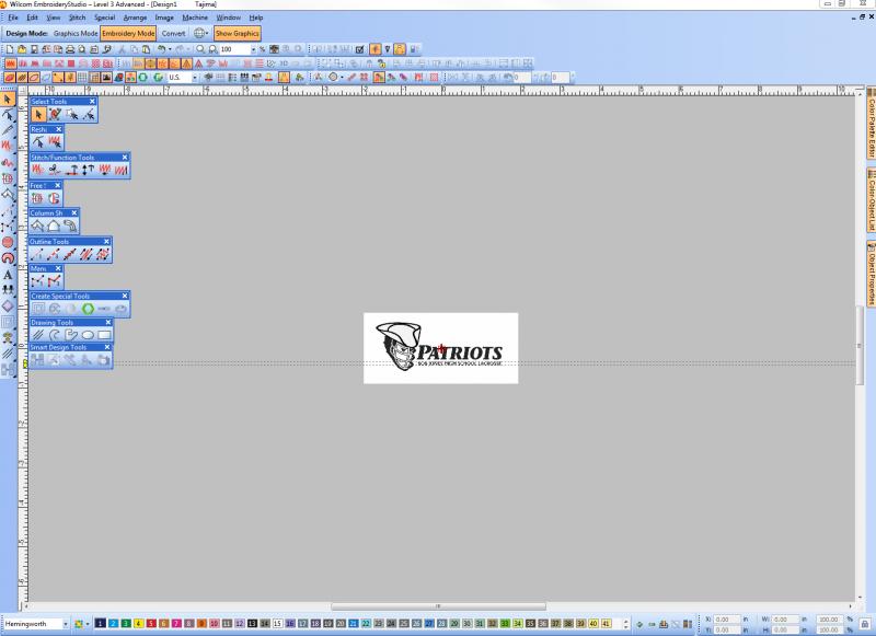

W-west it looks like you need a few more tool bars on the screen there.......
wayne k
guam usa
WildWestDesigns
wayne k
guam usa
Ha, I usually have a couple more on the screen as well (sequins and bling), but those actually go out too far, so I only leave those out when a design calls for those.
It does have a lot more then those as well.
