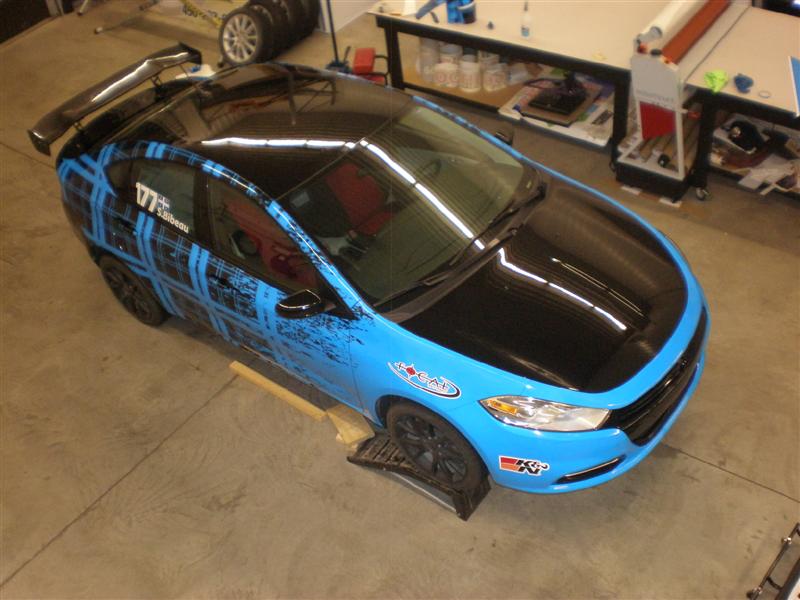

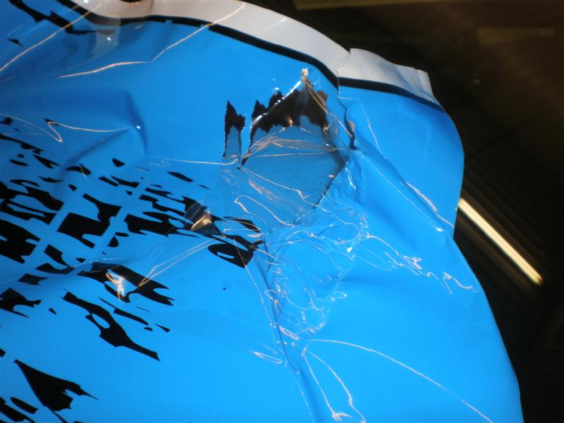

I'm a long-term Oracal user but recently I wrapped a car with their so-called "low initial tack" 3751 and it turned into a +20 hours nightmare. I'd like to give 3M a chance to get more business from me but after I revised their quote, I'm asking myself: "can I really afford this?" They propose to send me a 10yds roll combo (IJ180CV3 + 8518) to test so as far as material properties and printability, I'll see / test by myself (I own a Roland VS-540 with OEM inks) but for the pricing, it just seems out-of-reach, I mean way more than I pay actually for wrap material.

Ace, at my shop I print 3M and Oracal side-by-side with same exact results on my Roland printer. They both print great but what I hate about 3951 it's the adhesive's initial tack. I know they changed the "pattern" recently which may help a li'l but the previous batches in past years were harder to work around tricky corners. That being said, I trust these 2 brands, they never let me down (until last job with 3751). It was sticky as hell like if solvent had migrated into adhesive, turning a "regular" job into very challenging, vinyl ripping off, major static issues...

I've worked for years with 3951... this particular roll of 3751RA gave me hard times. I don't know what I did wrong (printing? drying?...) but trust me, many folks would have canceled the job and refund the client or re-printed the whole job to avoid wasting countless hours to lay it down properly.
I have just enough experience to admit I print stuff for other shops around for years... prints always dry in open air for minimum 24 hours prior to laminate step.
Can't figure where I failed this time... Oracal got a clip of the "fight" but haven't requested leftover parts for investigation (...) My contact has transfered the pics / clip to R&D for claims / expertises.

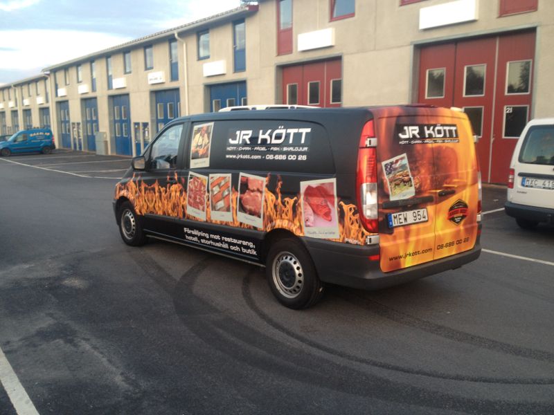

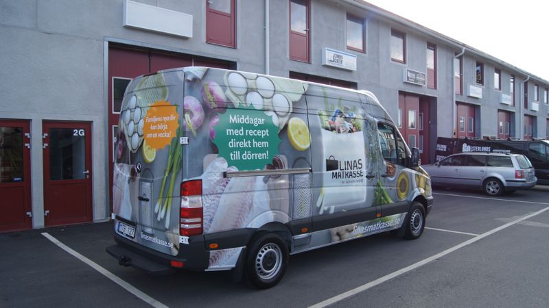

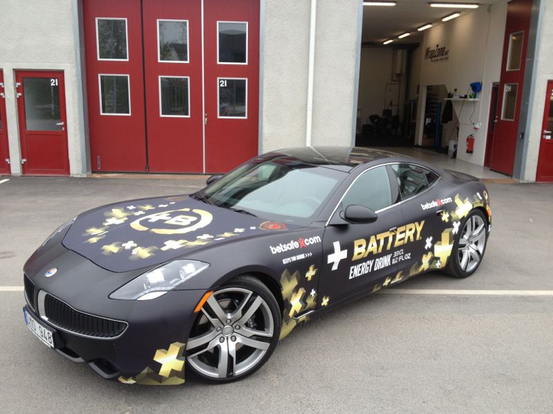

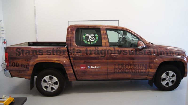

If you wnat the best hexis wrap vinyl ou should go with HX100 works really well and I definetly think they hold the same standard as 3M, I have no experience with avery som can't comment on that. Hexis also coming out with HX150 soon that we had the oportunity to try before release and that works even better.
What I like with hexis vs Orafol and many other print vinyls (if you ask me the Orafol/Oracal quality is just getting worse and worse) is that it is not affected as bad if you print with a lot of color and blacks on a solvent printer.
We used to use oracal all the time but they have had so many quality problems and have cost us a LOT of money in jobs we had to redo due to faulty materials. And Oracal have terrible customer care in Europe compared to Hexis
Attached is a few jobs we have done with HX100
