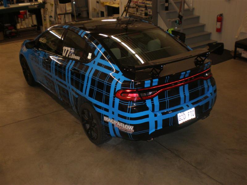

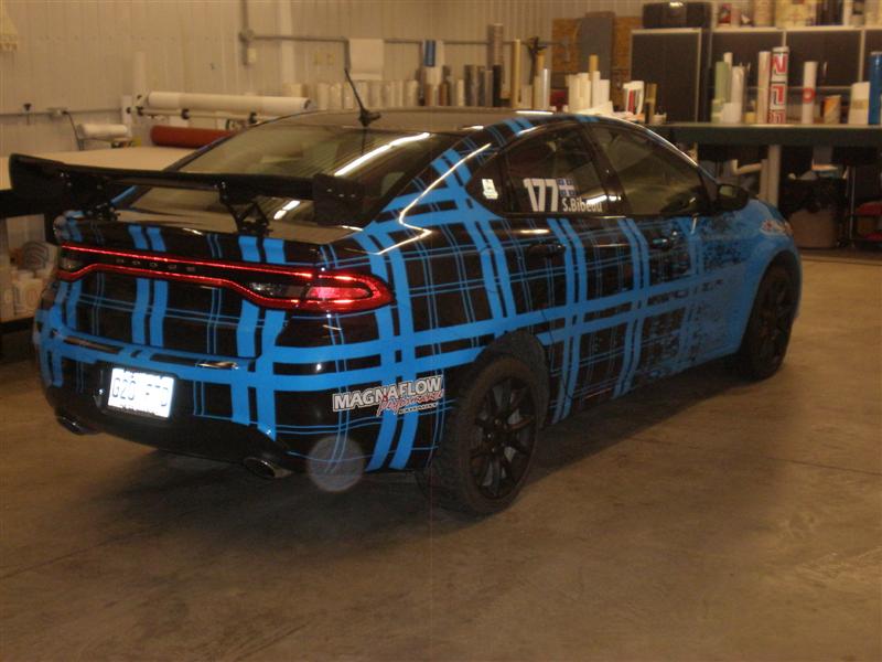

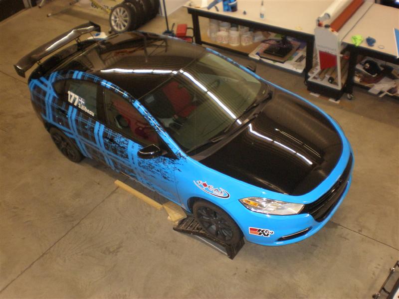

Attached is my challenging job made with "defective" 3751RA (not challenging by itself... the car was pretty simple curves... but the fact the vinyl sticks like crazy turned the installation into nightmare (and take my words, I'm really patient)

I hear you but as a matter of fact, it's not labeled on the box "crappy material inside" so 'had to try it by myself. I always had great experiences with Oracal's 3951 but as it may be a li'l too aggressive on some installations (initial tack), I was tented to try their "new lower initial tack" serie, the 3751. I have no complain regarding printability or durability (I have few big rigs done between 2005 & 2008 that are still looking very very good after all these temp changes and miles on the clock). Something happened with the migration of the ink to the adhesive and turned the application into endless extensive labour. The car was inside since 12 hours, washed, dismantled... evrything was set to start the installation when I discovered how much sticky it was. It's -20°C around here, snowy & slushy, so when you're in for a job, you go. I told myself: "OK buddy, it won't be an easy one but the job needs to be done NOW, no time or budget to reprint the whole wrap nor even the material in stock so..."

Ace, at my shop I print 3M and Oracal side-by-side with same exact results on my Roland printer. They both print great but what I hate about 3951 it's the adhesive's initial tack. I know they changed the "pattern" recently which may help a li'l but the previous batches in past years were harder to work around tricky corners. That being said, I trust these 2 brands, they never let me down (until last job with 3751). It was sticky as hell like if solvent had migrated into adhesive, turning a "regular" job into very challenging, vinyl ripping off, major static issues...

So tell me how you do it... I usually let the print dry 18-24 hours, rolled loose over a grill with small fan under it to help the solvent to vent out of the tube. I rarely install right after I laminated so there's a rest time there too. The particular job described above sat for like 3 months rolled loose in a corner of my office prior the get laminated. I wasn't sure I would ever heard from the customer so I thought it would be wise to save me from laminate expenses if the whole job to be officially cancelled. After I got the call from the client, than I went to laminator. The outgasing of 3 months should have been sufficient, don't you think?
