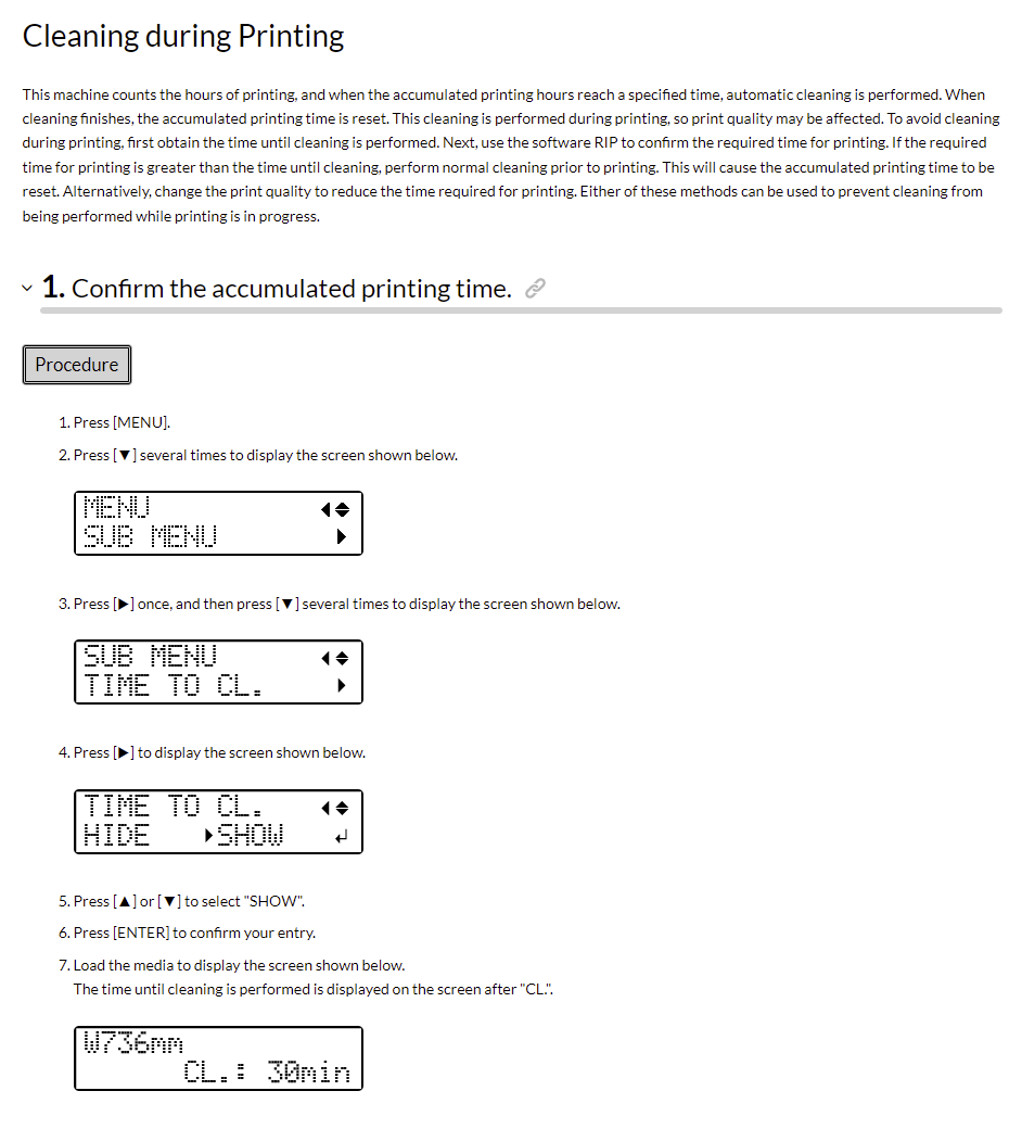

Oh geez... Our printer has started doing the exact same thing. It runs a cleaning cycle during a print. We've never run anything but Roland OEM inks. I've purchased inks from our initial dealer, other local dealers and online dealers. All official Roland products and dealers. Running a LEC2-300... I hope what the OP wrote is incorrect... 'once your printer thinks it has 3rd party inks, it's locked into this punishment cycle'
dreko
So just a *possible update to this thread
I'm running a LEC2-300 and it's doing a cleaning cycle during every print. My original owner manuals showed there was a menu option:
The manual doesn't state whether that 30 min auto cleaning time can be adjusted... it doesn't say at what time/point my printer has hit some internal Odometer on printing, then kicked this 'feature' on.... to start auto cleaning every 30 mins (default)
I go into the menus, and THANKS ROLAND. This section in the onboard printer menu is now GONE. Yep, at some point during firmware updates... it looks as though Roland has eliminated this from the LEC2-300, and I suspect this issue will happen with the LEC2-330, LEC2-640, LEC2-330S-F200, LEC2-640S-F200, LEC2-640S-F300, LEC2-640S-F400. They all are built on the
LEC2-platform release pre pandemic
My dealer/tech support has been waiting for answer from Roland... and I now play the waiting game. Burn the clock and days. I could almost live with this, however, when it starts the auto clean cycle during a print... it leaves a visual line break where it stopped... as well as slightly raised ink where it stopped.
I'm also not printing on an inexpensive substrate. I'm printing on metal. So, you lose ink on auto cleanings, you lose more production time becuase of the auto cleanings/loss, and finally you lose material expenses.
Sorry to vent, extremely frustrated with this situation and mad as hell. As a first time Roland owner, I could have lived with the slow print speeds.. I could have lived with the support structure Roland dictates (go through dealer, then wait from Roland)... but I can't help but feeling I'm getting nickeled and dimed from this company. I had considered
purchasing a newer Roland/Upgrade... but I'm waiting to see how Roland handles this..
BTW, my printer is under warranty still.
I get that Roland has very strict policies in place because I run their white inks... but putting this unneccessary auto cleaning cycle in... so it can protect the inkjet head from clogs... well I guess it's turned out to be quite the expensive printer to own and operate.
Any thoughts or sympathetic support from other Roland owners/users? lol
Which goes away once you cycle a functional chip back into the printer. Call your dealer, if you’ve never putt third party in, this shouldn’t happen. This is a current generation printer, demand the love.
Who’s your dealer? If this left regular mode, it has to have been moved to service mode, right? It has to be able to be turned off. The hard line from cleanings is real, happens on my LEC300A, so that’s absolutely unacceptable. Whoever sold and installed that printer should be called and bothered daily until it’s fixed.
My dealer is Central Paper. However, they are not willing to travel to my location as they've now deemed it too far and unacceptably out of their range. So, I'm currently trying to establish a new relationship with a local dealer. Still waiting on getting this taken care of , and a service tech on site. ... it's been quite a while.... that I've been dealing with this headache. :(
