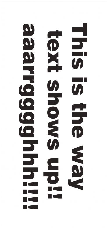

Never seen this before ... Anyone seen this one
R08
It's funny but irriating.
In about 18 years using Corel Draw I have never seen this. My default text is vertical like this:
It's a 270 degree rotation.
Can't seem to be changed using the default text feature within the corel window.
Don't see it in the 'customization options'.
Other default items have a normal orientation.
I'm using Corel X4.
Has anyone seen this before?
R08
Just noticed that even paragraph text does it.
Anyone seen this or have an answer?

I would have thought so too. But no.. this seems to be different. The default is set to vertical with no way of changing.
Even after rebooting the computer.
CTRL + . only sets the vertical text temporarily for the selected text.
Now that my problem is fixed there's no way for me to know for sure if CTRl (,) would have fixed it but I don't think so otherwise the Corel techician would surely have tried that first.
