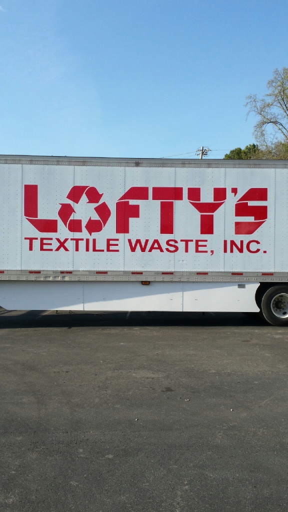

3M 1080 works great for this. Here is 1 example.
ExecuPrintGS
works great, just do a few cut tests before sending the whole job. Pressure settings will be a little different compared to regular cast vinyls.

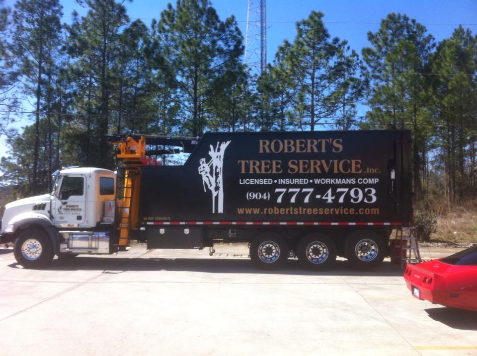

All by using 3M 1080 gloss black, and the amount of time just weeding the product was a pain in the.... Lol. But definitely great vinyl to work with
Sent from my LG-H831 using Tapatalk
d fleming
Yes, weeding and taping it are a pita but it lays and stays great.
