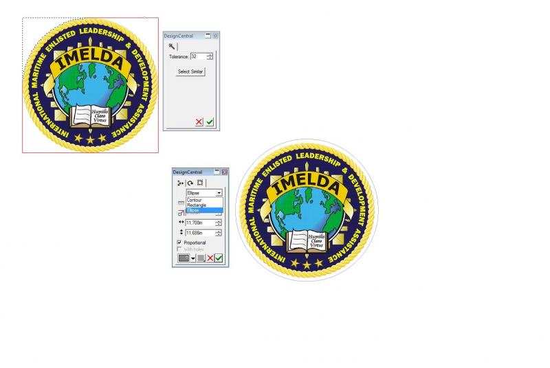

Was contacted to for some sub work...all i have to do is print, lam, and contour cut...the artwork is already done...well when i open the artwork there is a rope around it and i need to contour cut around the rope in the circle. but when i use the magic wand tool around it...it is jagged around it and not smooth where it would give me a nice contour cut...any help?

You can still use the provided jpeg and contour cut smoothly around the rope. After importing the image into Flexi, use the Make Transparent option found in the Bitmap menu. Hold down Shift and manually select the 4 corners of the design (select similar will not work in this instance since it will also make the white pages of the book transparent). Then select your contour cut option from the Effects menu. Instead of using the default selection of "Contour" which will make it bumpy around each hill select "Ellipse" and you can create a smooth circle around your job. Unfortunately, this will only work with ovals and rectangles. See submitted screenshot.
