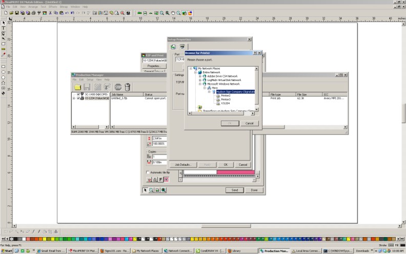

if i use the browse feature in production manager instead of only selecting tcp/ip and entering my IP address manually, i can find the printer on the network. if I ad it that way, the job rips, says its printing, deletes itself and a new job is created called "unknown.prt", and nothing comes out of the printer.

still not working.
i dont get why i cant ping the printer, but i can see it when i browse for it
ATTACH]56937[/ATTACH]
Windows can use a different protocol to communicate with devices on the network. It does not rely solely on TCPIP (AppleTalk, for example... or NetBIOS/NetBUI, WINS, etc..)
It is an indication that the physical connection may be OK.. which means that the problem is in the TCPIP configuration. Maybe the workstation, maybe the RIP setup, maybe the printer itself. Make sure they all match.
