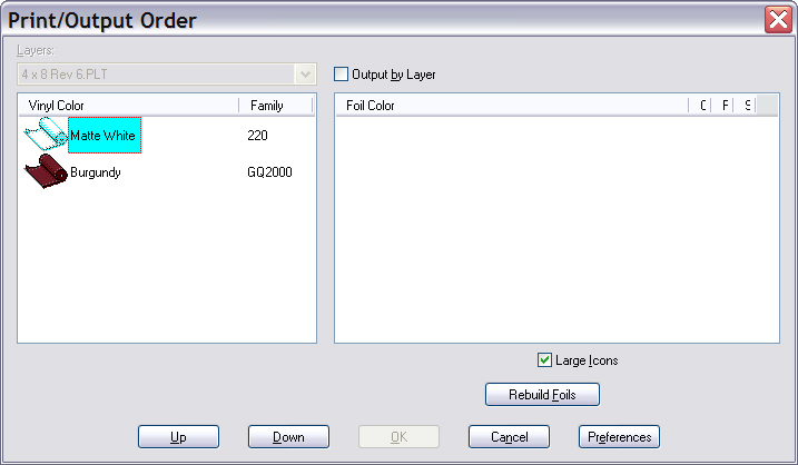

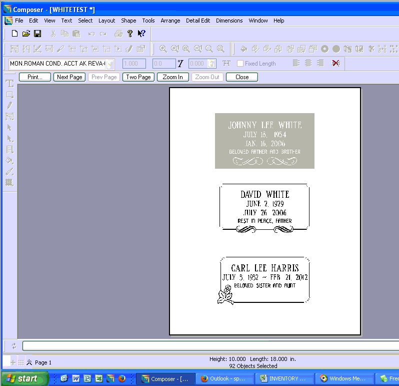

I am having an issue with my Gerber Omega software and was wondering if anyone could help me. I have an issue that when i create a design for a memoral stone, i go to print preview, and it only shows 1 image from each design but not any text or anything else. I can create a text image on a blank page..but when i go to print preview it shows nothing on the page to send to cutter. Can someone tell me where to go so that it will print what i see on the page? I am new to this and any help would be much appreciated. Thank you so much and Happy New Year!!
. Will know for sure if its right tomorrow. Thanks alot for your help! Your a lifesaver!
