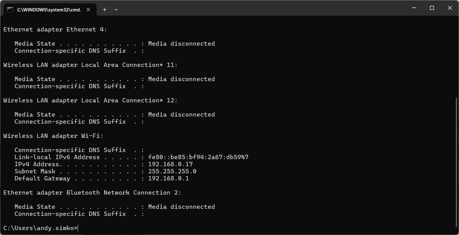

i still need to see what the computer settings are, BUT there is nothing you could put in on the pc to connect to that
(1) post the ip settings for the pc
hold down the "windows key" and tap the letter r (windows key is the one with the microsoft flat to the left of the keyboard
in the run window type cmd <enter>
type ipconfig <enter>
you will see something like
please post those numbers
ipv4 address
subnet mask
default gateway

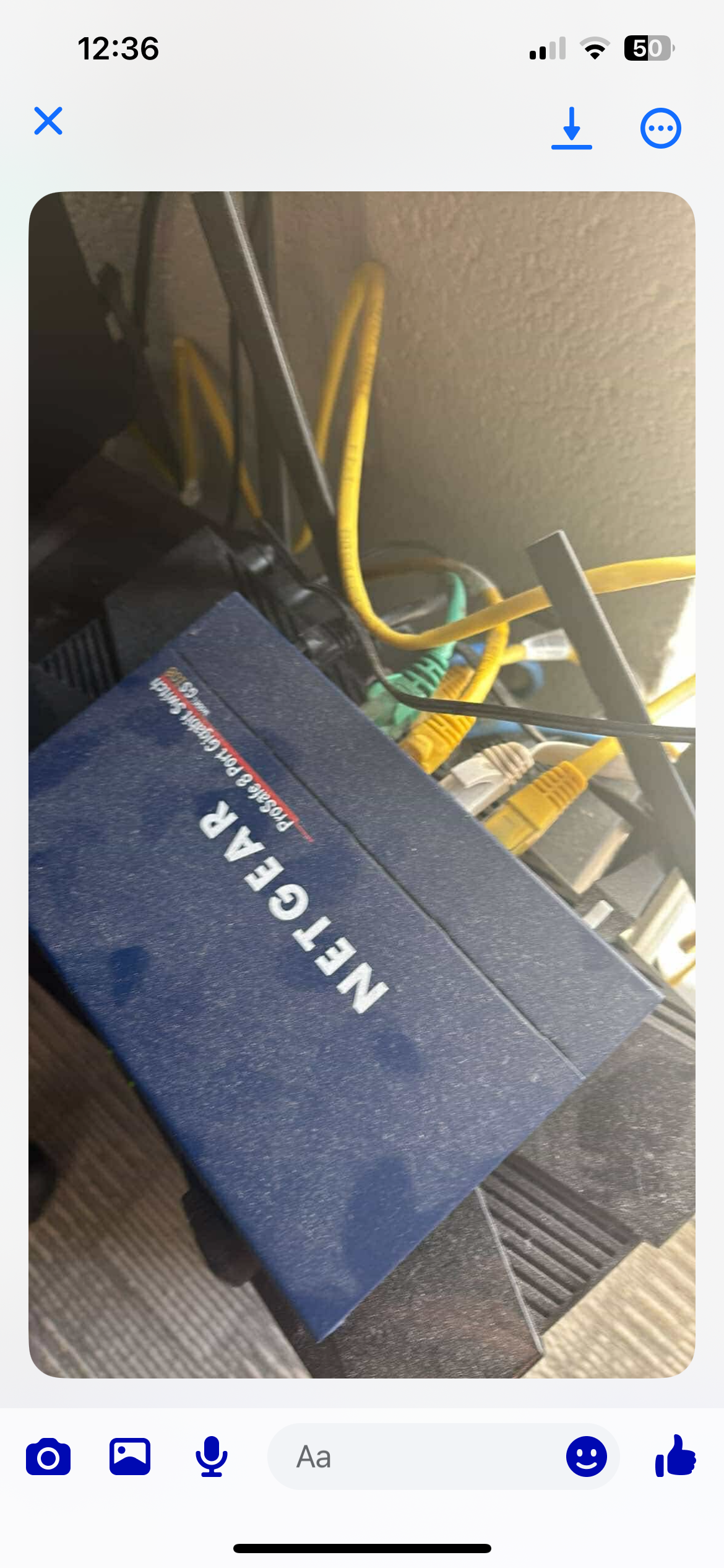

I recently had this issue, and tried everything under the sun. I wish I could remember exactly what I did, but it turned out to be a simple fix BUT I needed this network switch so that my internet and printer went through the switch and then had a Ethernet cable from the switch into my computer. I’m not saying that’s your problem but any other way would not work for me.
