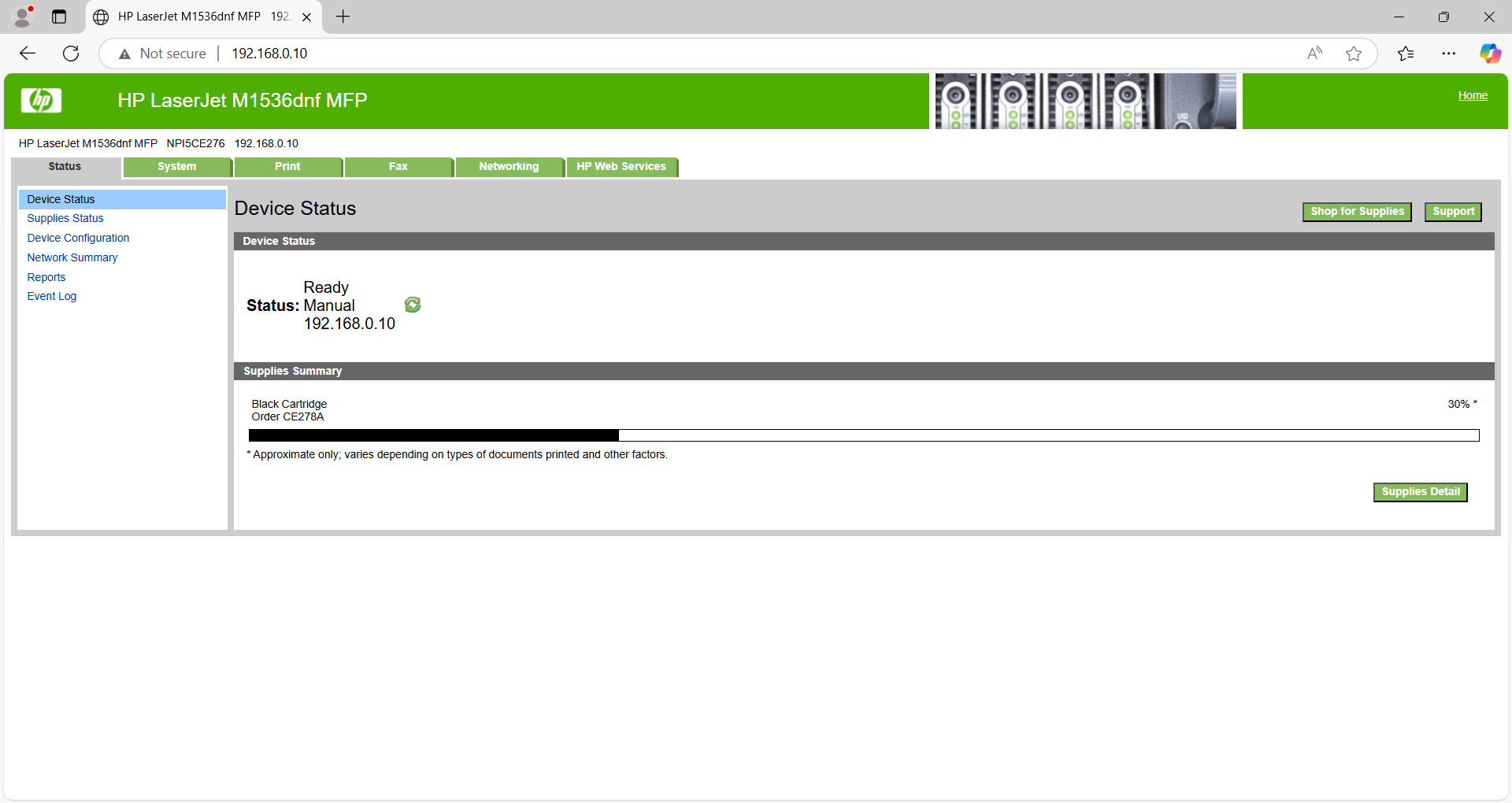

next open a browser and http://192.168.1.40
should look something like this
if both of these test succeed, it might be time to recreate the connection in flexi

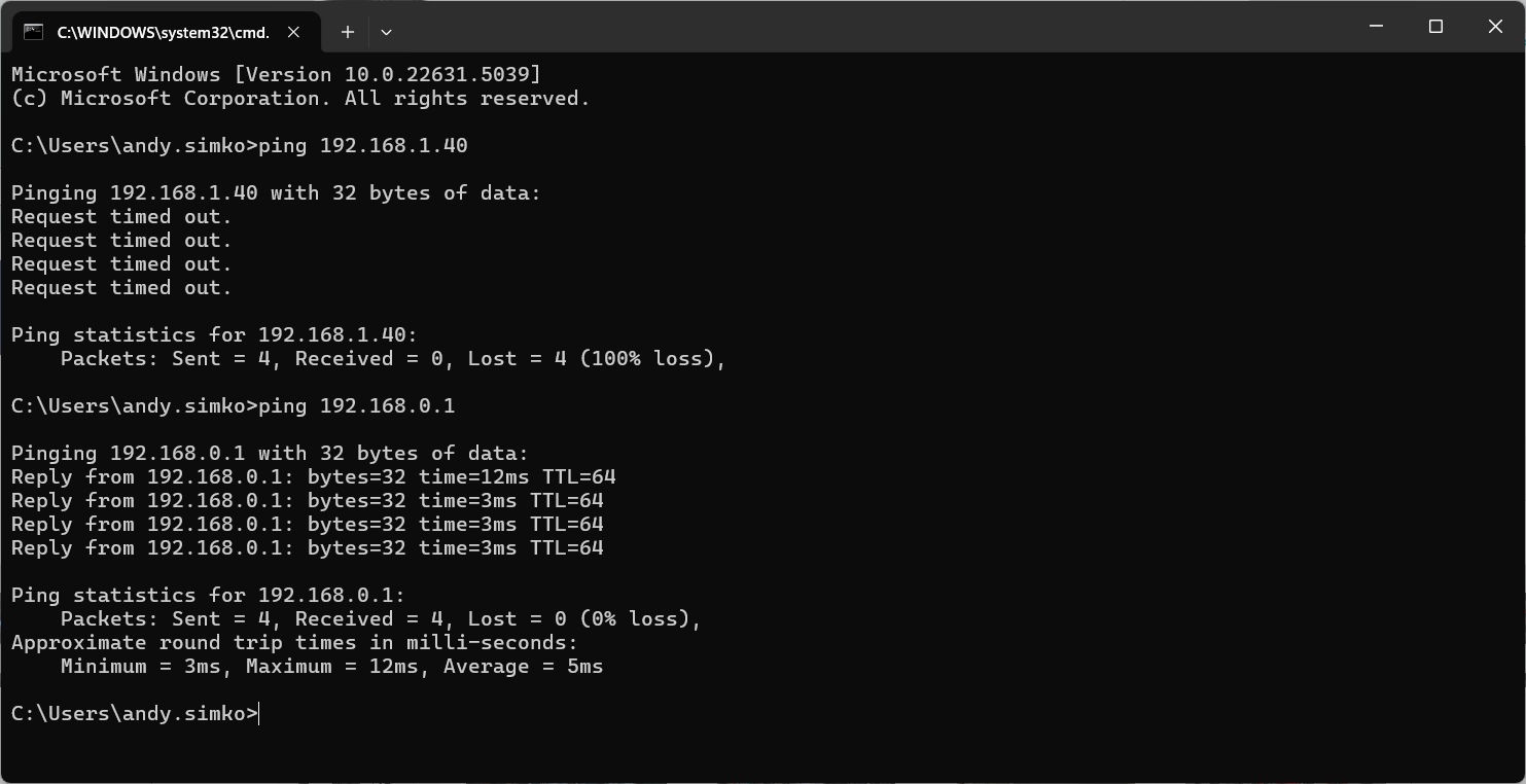

so, from the laptop open a command prompt again <cmd>
type ping 192.168.1.1
this is your gateway, the way out to the internet
press enter and you should see
then type
ping 192.168.1.40
press enter you should also see 4 replies
if yes you have communication with the printer's ip

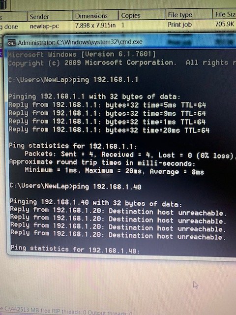

Neither is working.
Ping ending in .1 works.
Ping with printer .40 says unreachable.
Ip address bar says connection timed out.

I was not using a router. It’s a simple Ethernet plug out if the back of the laptop straight to the printer. I did change the settings to what you told me.

One small detail. I detail I discovered. This is windows 7 home edition Not sure if that will make a difference.
I was confused on which laptop I had running
