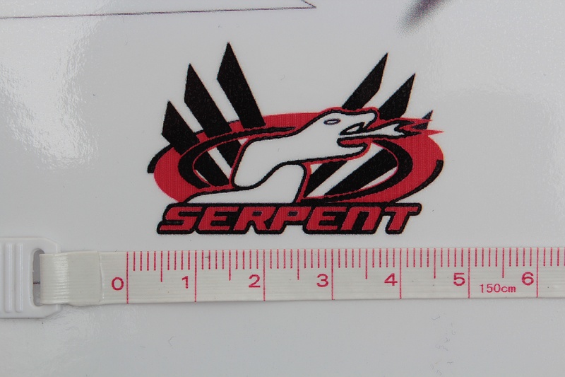

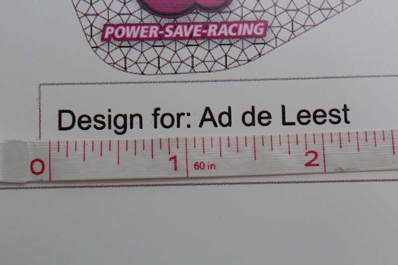

Two pictures of a troubled JR 38 machine :Oops: but still looks good on detail I think.
How does it compares to yours show a picture to make things more clear.

i see cyan and magenta overspray. could be an electrical problem somewhere or the head is failing. my particular overspray problem was caused by my head having problems with smaller dots. i re-made my profile and only used the larger dots. that fixed my problem.
kelly
