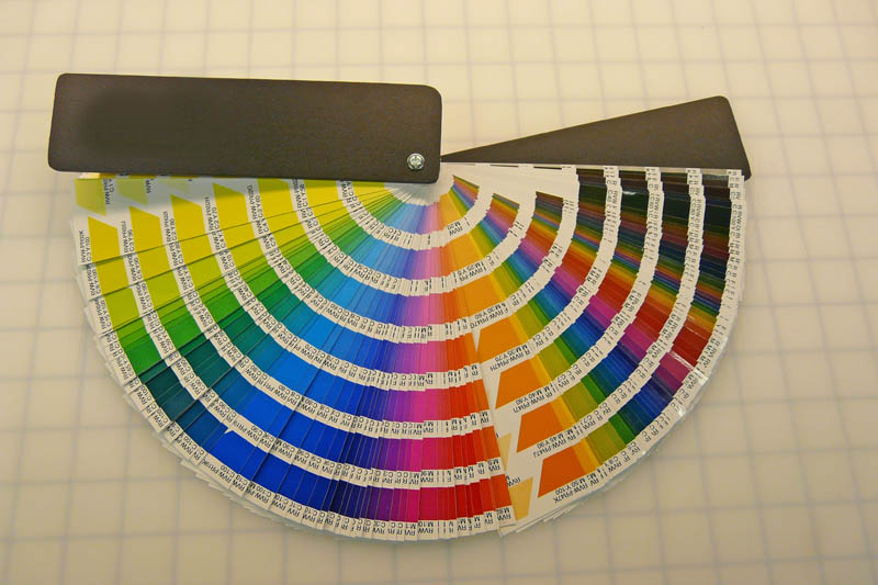

I'm also a new owner of that very machine. You simply must use the Roland color palette system. End of story.

Hey Guys, I like the Roland Color System but how do you get by with such a limited amount of colors? I just wish that they had an expanded swatch library, or maybe they do and I just don't know it?

Huh?

How does one acquire one of these? Is this something available once I submit my serial number for registration and can get access to Rolands dga site?

You don't acquire one, you make one. Simply print off the palette in VW and after it's had a few hours to dry, cut it up into pieces as indicated by the cut marks which are printed as well. Then put together as shown.

...and don't forget to print it onto the media that you mostly print on. Colors will change slightly on different media. You almost need to make one on each different media (canvas, paper, banner, matte vinyl, gloss vinyl, etc) but I never did.

I thought about that after I left. This is my first printer, so I will be asking about common material to use.
What did you do, make the plastic backs, drill holes and stick a bolt thru to make your swatch sample?
