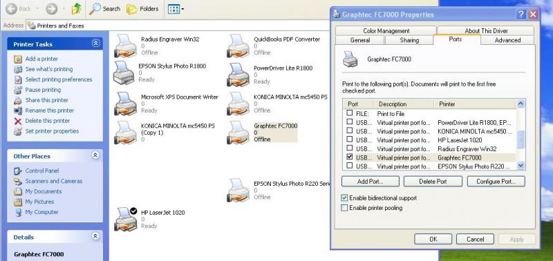

digitalwoodshop
USB Serial Ports can be a real pain.... I would recommend deleting the Plotter from the USB even if it shows correct. I have had the same problem using a Parallel to Serial USB on my Laser Engraver.
The Fix again has always been.... Delete the Laser and plug the USB back in and assign it from Comm1 to USB and your back....
Good Luck,
AL
