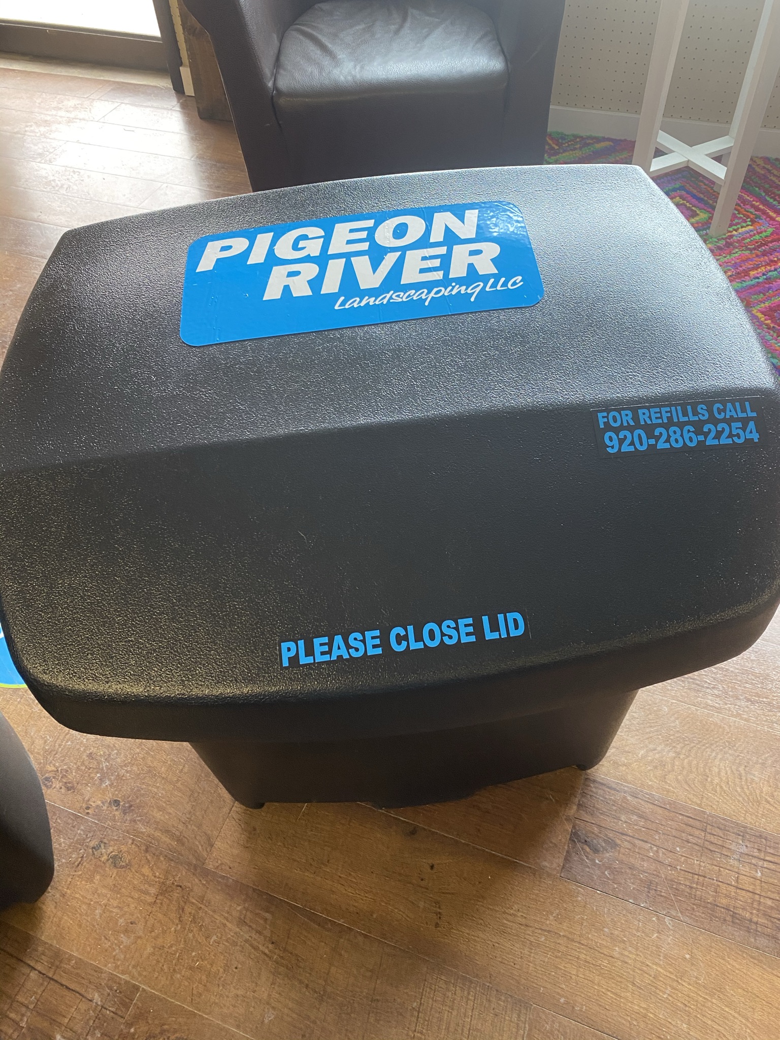

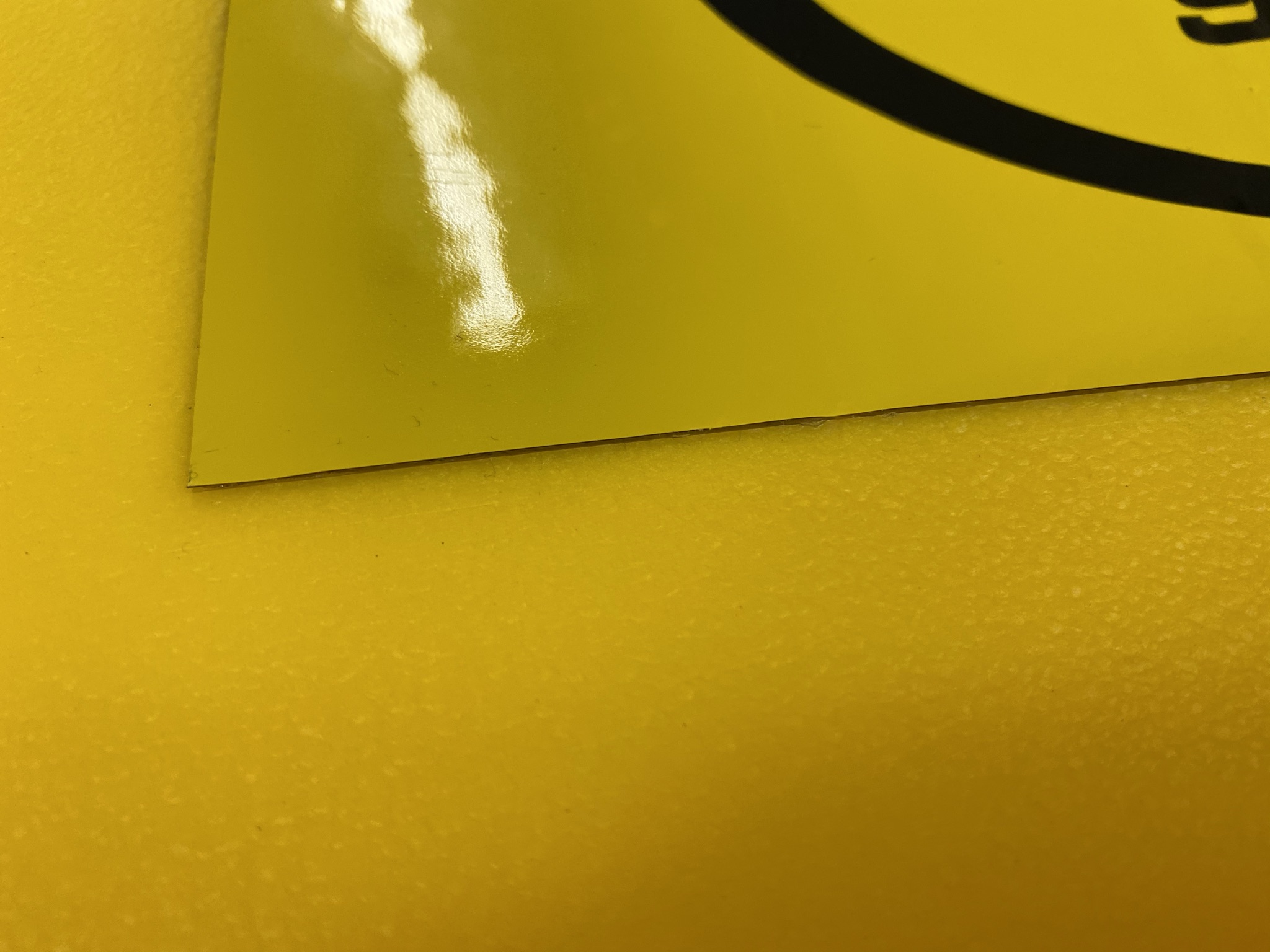

My good customer/friend (yellow bin) found these great salt bins at Home Depot. We couldn't find anything that stuck to it, as I suspected. My suggestion was to make a plate for it and use bolts to attach. He brought me in some Flex Seal and said just try it, if it doesn't work, it doesn't work.
It worked...a little too well, what a sticky, messy thing to work with. It's a little wrinkly but vinyl sticks to it so we are going to see what happens. We left it outside for a few days and it seems to be holding up. He bestie came in and then brought me 8 more bins in black :eek:.
If you need vinyl someplace that vinyl doesn't like to stick and the end result does not need to be perfect, Flex Seal might work? Not sure how much it will shrink and if it will cause problems with the vinyl but these guys are my friends so they understand it's an experiment.
