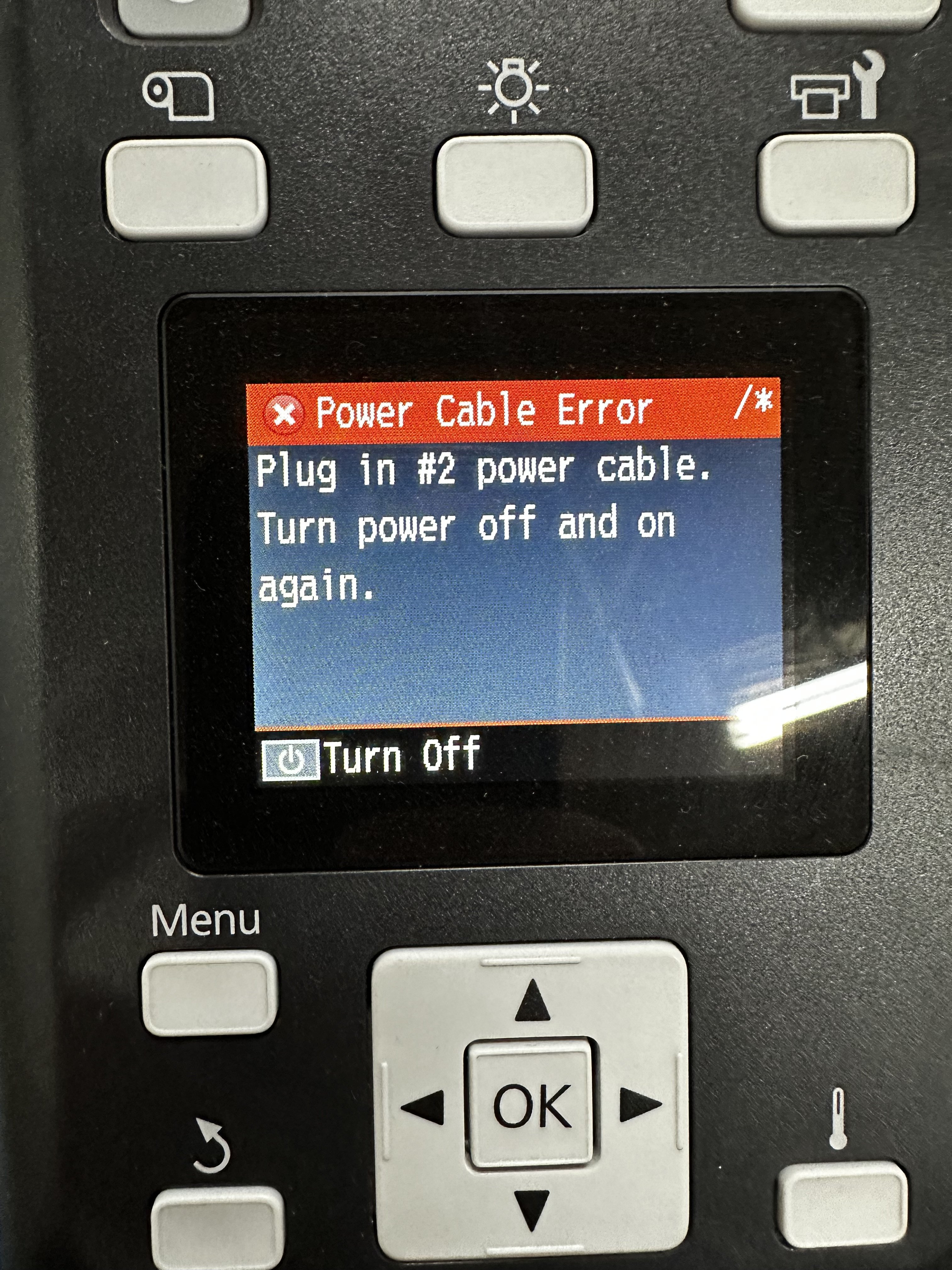

Hello,
I just got purchased a used S80600 and I’m pretty sure it has never been used. It came with clean cartridges loaded in all of the colors. When I went to start it up it asks me to do choose the color setup (9 color / 10 color w/ white or 10 color w/ms) no matter what I choose after that it goes to an error that says “power cable error - plug in #2 power cable. Turn power off then on again”
Anyone ever had this happen?
Any ideas on what to do here?

jharler
There are two power cables, one for the printer itself and one for the heater. Both of them need plugged in.

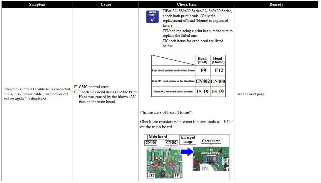

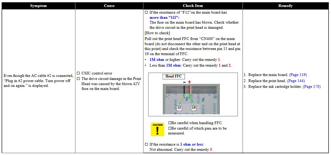

cmoist
Cause:
•CSIC control error
•The drive circuit damage in the Print Head was caused by the blown 42V fuse on the main board
Check Item:
Check the resistance between the terminals of “F12” on the main board
If the resistance of “F12”on the main board has more than “1Ω”:
The fuse on the main board has blown. Check whether the drive circuit in the print head is damaged.
[How to check]
Pull out the print head FFC from “CN400” on the main
board (do not disconnect the other end on the print head at
this point) and check the resistance between pin 15 and pin
19 on the terminal of FFC.
• 1M ohm or higher: Carry out the remedy 1.
• Less than 1M ohm: Carry out the remedy 1 and 2.
If the resistance is 1 ohm or less:
Not abnormal. Carry out the remedy 3.
Remedy:
1. Replace the main board.
2. Replace the print head.
3. Replace the ink cartridge holder.
