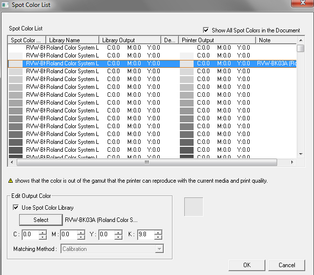

You can get the files here, along with the latest firmware updates for your machine and the latest version of OnSupport. Lot's of media profiles can be found on that site as well. I just installed the update and poked around about, 2 things i noticed, well 3 if you count the new splash screen, but the 2 new features I noticed:
1. Under Queue Settings > Job Management, there's now an "Action for Incoming Jobs" section. See the screenshot for all the juicy details. Also note that you have to go into your Queue Properties to adjust these settings, just like how you adjust the .eps margin.

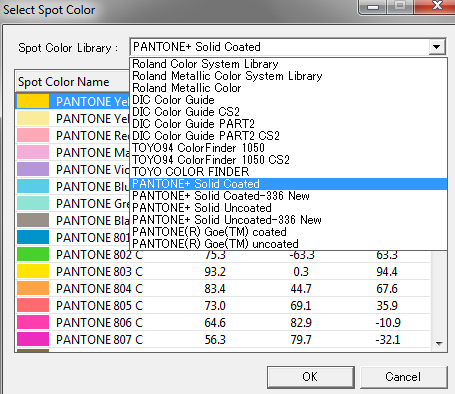

2. This is the "big one", under Settings > File Format > Spot Colors > Details (second screenshot), you can now select a spot color from your Spot Color List, and then under "Edit Output Color", you can choose to replace it with any color from the new Spot Color Library (last screenshot).
