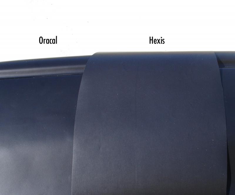

GypsyGraphics
I think Hexis calls their's super matte, it's slightly less shiny than the Oracal. It looks like black licorice... yum!
I haven't pulled the Oracal off the rear bumper yet, so maybe tomorrow in the light of day, i'll take a close-up of the bumper and stick a piece of Hexis on too.
Then i'll start a new thread with the finished job.
I have some pics of the Hexis.

The Hexis does seem a lot flatter, but I'll reserve my judgment until I see the pics of it on a car.

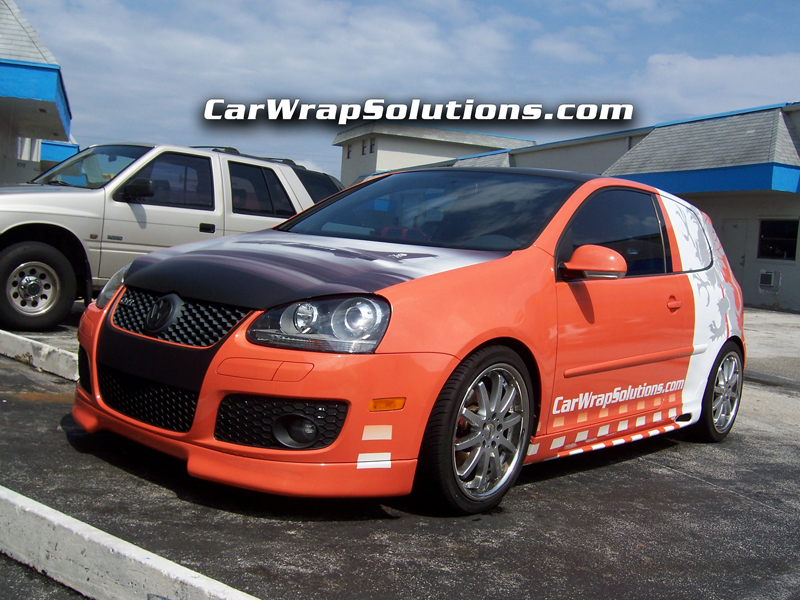

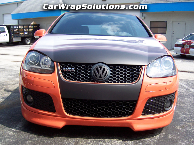

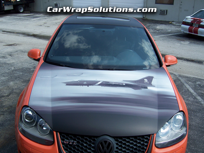

perimage
Matte Black Wrap on my Orange and White Volkswagen GTI, Ft Lauderdale, Florida
The black matte in the middle is the Oracal Matte Lamination. We printed the black on 3951 rapid release and laminated with Oracal Black Matte lamination.
Even though I am a bigger 3M fan when it comes to their wrap products this particular combination looks very nice. The hood takes a lot of stress from this crazy south Florida sun and road debris, and has been on here close to a year.
Oracal gets my thumbs up on their matte lamination.
