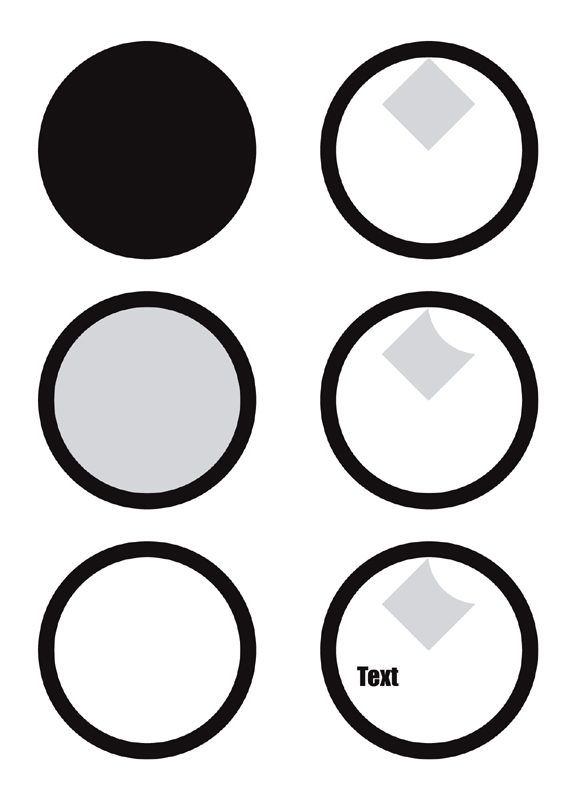

Charlie, whether or not you reproduce this logo, you are still going to need these skills in the future. Rather than use autotrace, I encourage you to think of the logo as simple shapes that you can draw and combine. A couple of circles form the outline. A square rotated 90° forms a diamond that you can edit to form the shapes in the logo. Then you can find a similar font for the text. Or if you can't find the font, combine and edit simple polygons to form the text. Practice, practice, practice.

Amen! I agree with thewood here Charlie. This would be an excellent opportunity to get a little practice working directly with necessary design / sign skills. Hop right in there, give it a whirl and pretty soon you will be whizzing thru Corel like an old pro.
Good Luck!

Hey Dave. Ya I got it taken care of. I just go into this business so I have A LOT to learn. I took the advice of some others on the site and basically constructed it using simple shapes rather than just auto tracing or downloding the logo. Thanks for your help and everbody elses to! Charlie
