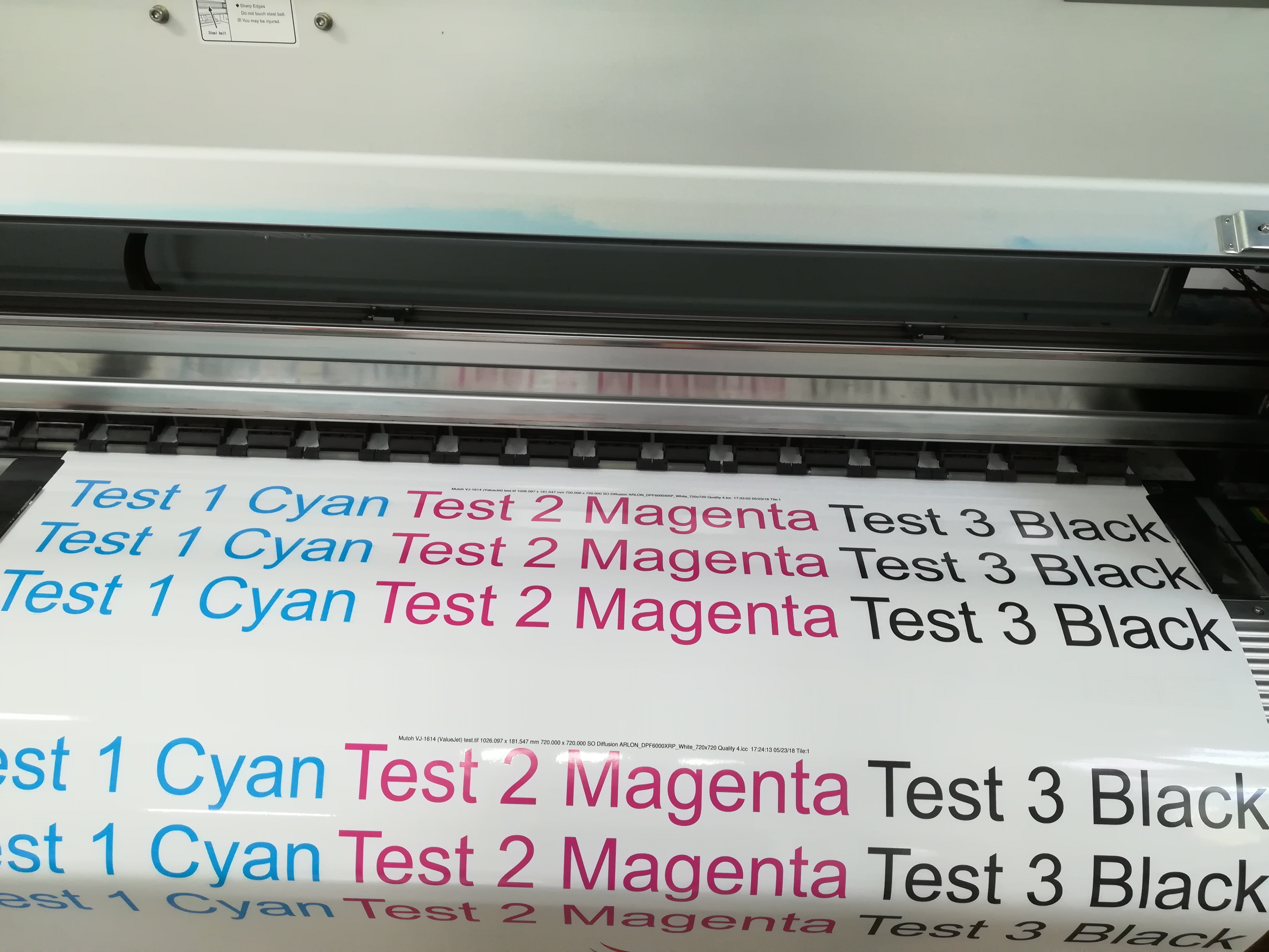

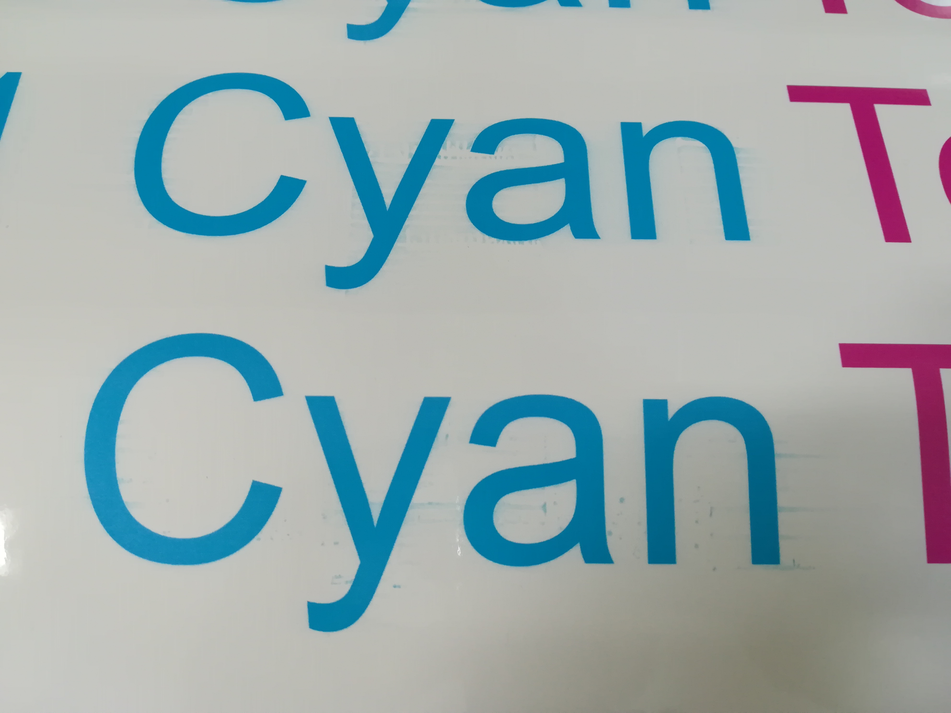

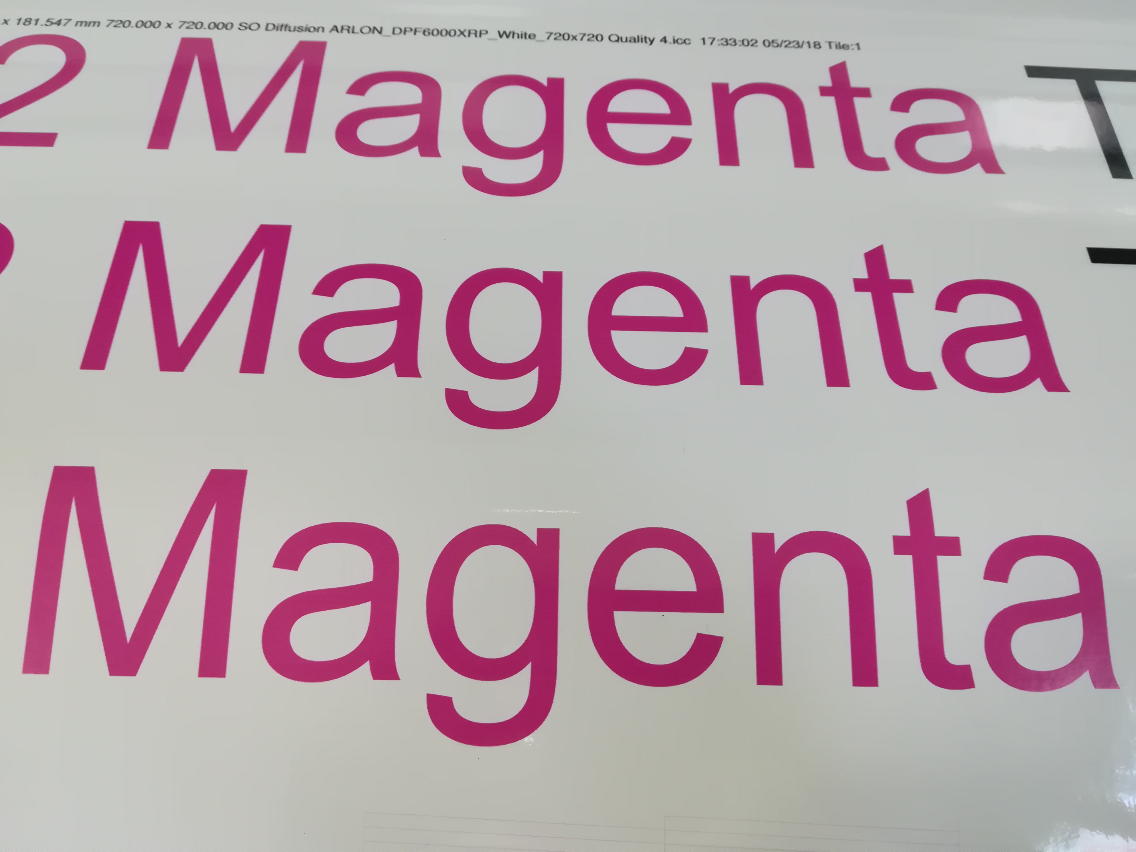

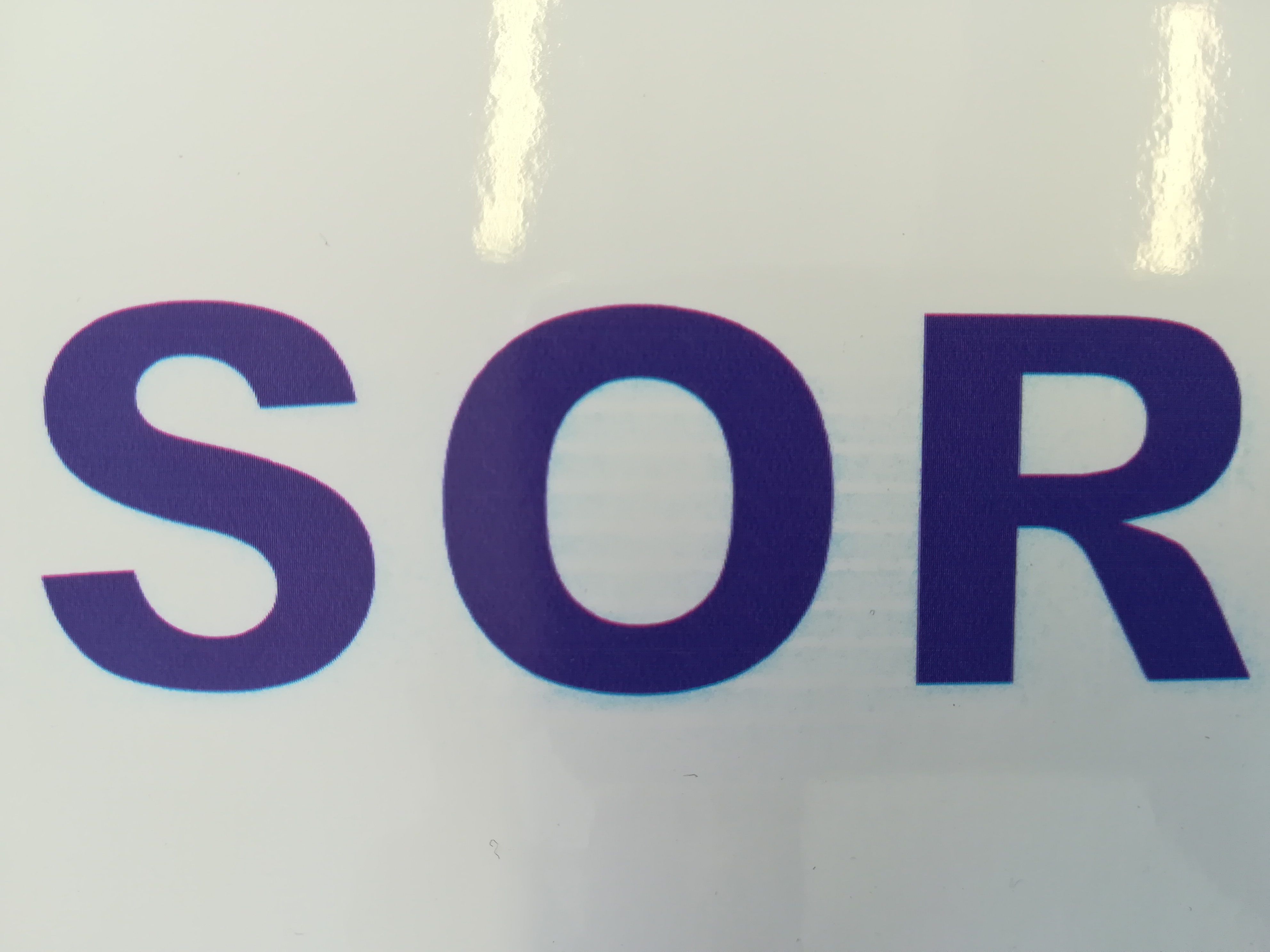

On a second note i have been having sataliting issues, would this be from my print head being to high. If so any recommendations
Pitzu
If it's a static like issue, you could try to lower the print head and see if that resolves the issue.
But before taking the head height into consideration, you should make a test to see if all the colors have this problem or only one of them.
To check this, make a test like in the attached pictures. The fill colors should be Cyan(C100,M0,Y0,K0), Magenta(C0,M100,Y0,K0), Black(C0,M0,Y0,K100), save it in CMYK mode and send it to print. I didn't put yellow since on white media you can't see much of the yellow.
In my case, the rip color profile did an override and made full Black(C100,M100,Y100,K100), so it wasn't conclusive.
As you see in the pictures, cyan is the problem, magenta is ok.
If it's just one color, it could be an air sealing problem (probably around the damper connections), ink with changed properties (viscosity, surface tension).
