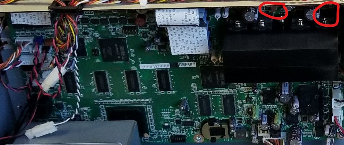

So the printer goes thru the motion of printing but doesn't actually jet any ink? You can see ink going thru the maintenance station when it is cleaning?
If both of those statements are true then you most likely have a blown F2 fuse. The F2 fuse on most main boards is just above the black heat sink in the top right of the board. It should be a 750ma fuse and should be easy to replace.
You mentioned in your first post that you replaced the cables, are you sure you followed the folds from the old cables on the new cables? Also make sure that the cables are centered when plugging them in, if not they can make contact with two cables and cause issues. I have attached a picture of a 628X main board, the fuse location on the 1624 should be in one of the two circled areas.
i checked all the fuses
i took the new cables off and put the old ones one
still the same result

It is very rare that a CR Board would cause this issue. It is almost always a blown F2 fuse. Did you try to test the fuses outside of the main board? We have seen false good readings when it is in some boards.
