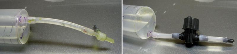

    also i attached a pic of two types of syringes used in printer maintenance.
    the one with the valve is so you can shut off ink flow whenever you get the right amount of ink. it is not a necessity.
