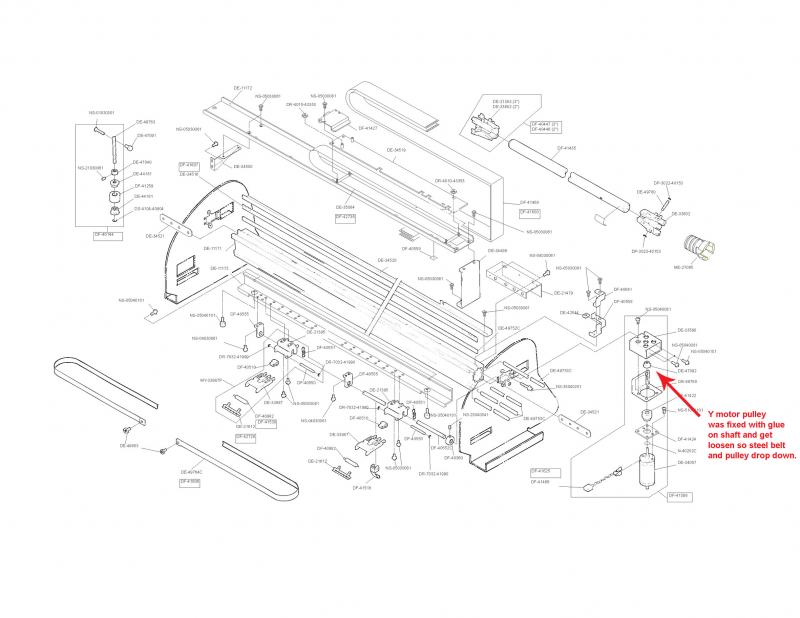

Y motor pulley was fixed with glue on shaft and get loosen so steel belt and pulley drop down. Printer still has warranty so I`ll change Y motor assembly. Probably it is factory defect.

Y motor pulley
Sorry about late. I attach parts list because I dont have original photo. I sent original motor to service and forget to take a photo.
