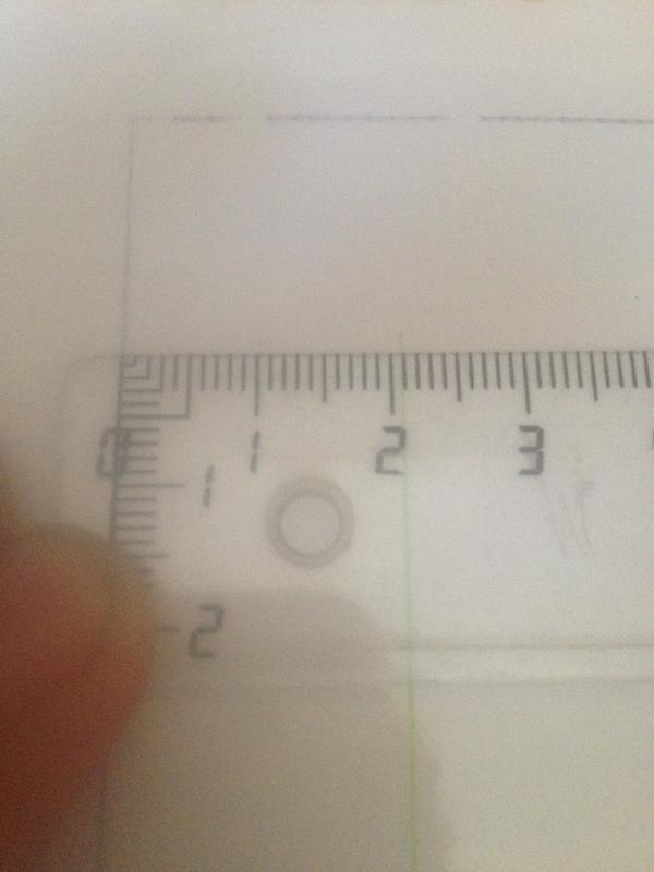

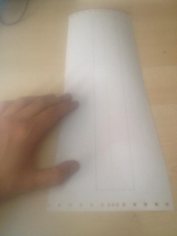

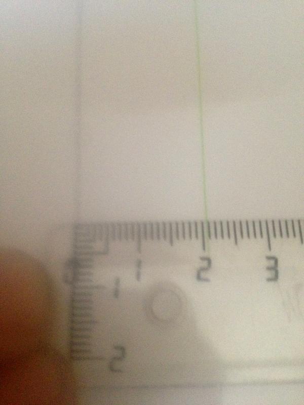

Well, I did a "rudimentary" check......I ran "print head aligment" test from the Printer Set Up Menu, this test print a fine line trought the Y axis (lime line on the pic) then I put the vinyl on my GSX15 plotter and fit a Pen Holder, I draw a "parallel line" (pic 1).
The measures are identicals, above and bottom of the vinyl, about 21mm....(pic 2).....so there is not problem with the plotter......
Conclusions.........I have notice that the plotter cut right the "arts" near of the "register mark", if you print the "register marks" on the "left-bottom" of the vinyl, the cuts on the Top of the Vinyl is "off" towards "left-up" if you put the "register mark" on the center of the vinyl the cuts is "off" to "right-down".....
