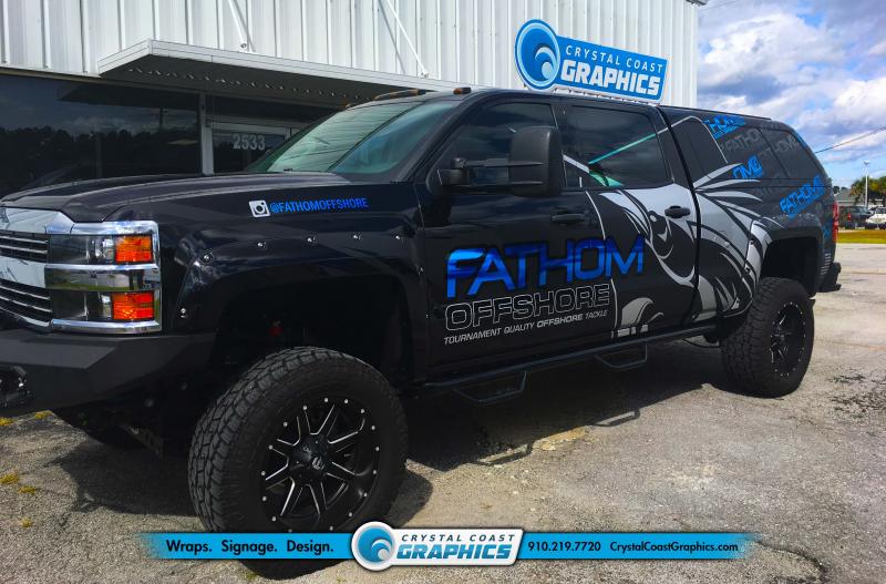

Photo Oct 27, 1 22 56 PM.jpg We did a bunch of overlays onto avery matte black a few months ago. It was a little hassle to get them to adhere, but with some heat, they have stayed on well. This photo is showing it. It was gloss black, silver, and blue chrome overlays onto the matte black. All the films used were sw900
