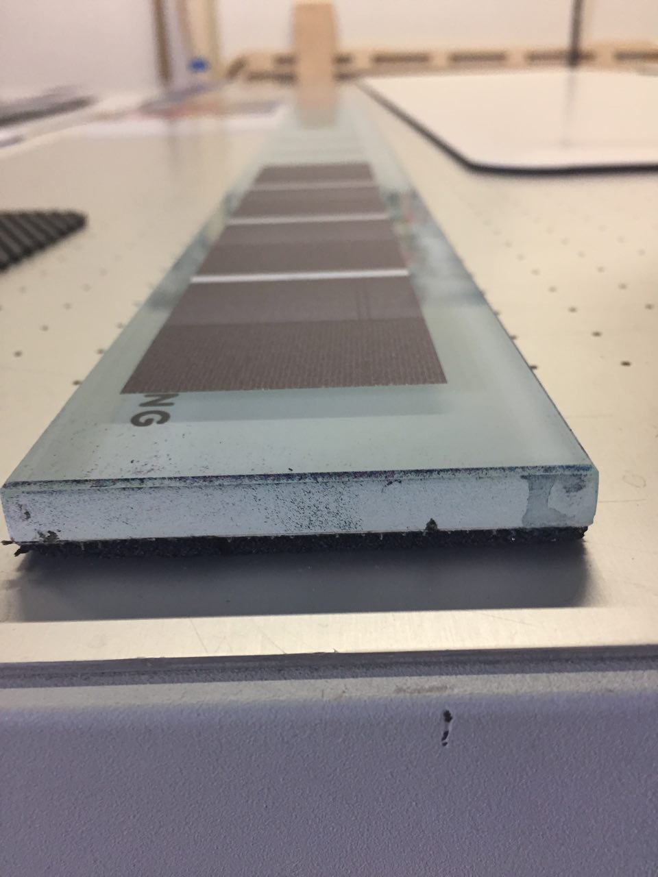

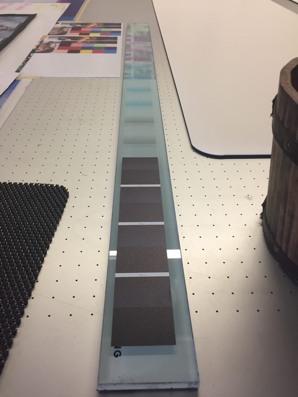

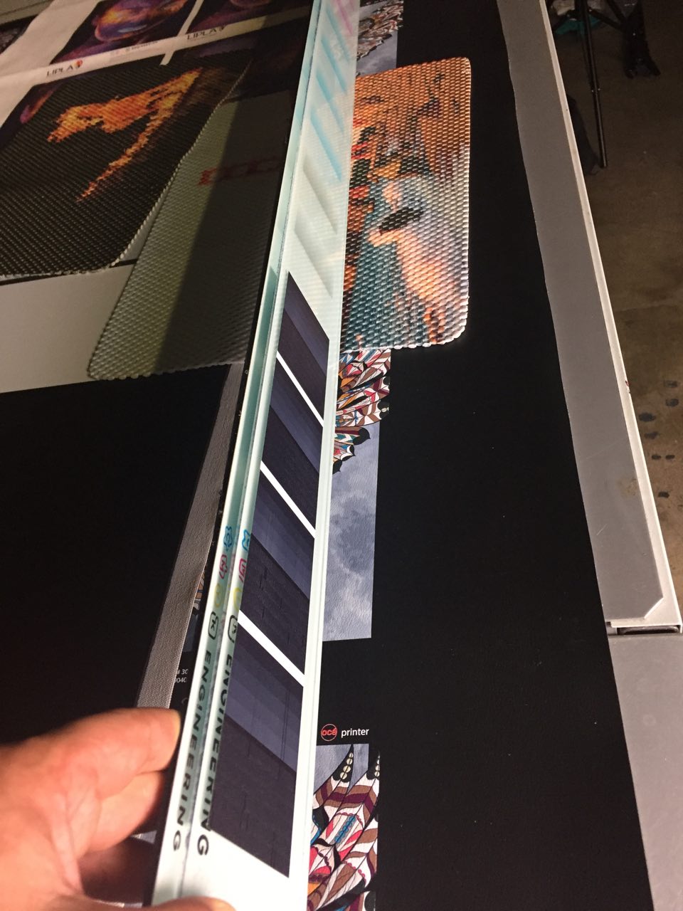

    You are guys do not look for easy ways. go to any glass shop and order a piece of glass in size to fit the check. Profit! 2018-10-10 20.30.49.jpg 2018-10-10 20.30.32.jpg 2018-10-10 20.30.40.jpg
  5. Pauly
    Pauly Colour Guru
    1,046
    168
    63
    Feb 14, 2016
    Melbourne
    what?
    so you do a test print on the piece of glass? then what? Clean it and do it over again?
    If that's what you do, man what a waste of time.
    i do a minimum 2 nozzle checks and before that i have a small test print. gets everything firing right up.

  6. CMYKENGINEERING
    CMYKENGINEERING Member
    75
    18
    8
    Jul 29, 2015
    Santa Monica
    =)) a waste of time ...
    We do the nozzle check maybe a couple times per day.. And it is just in case to be sure. Usually, the nozzles check looks perfect since the first attempt. You should better to change the ink and forgot about the vacuum cleaner =))
  7. GregK
    GregK Member
    68
    19
    8
    Feb 21, 2009
    Hungary
    I must say, you are right. If you have the perfect vacuum settings, and good ink version, you do not need printing checks before every work.
    I have another solution for nozzle cleaning what uses less ink than original purge. Also it can be doing under printing, if you need it.
    Print to glass is a good idea, but only one time forget to change the carriage height...
    Modificate the files is only 5 minutes.
