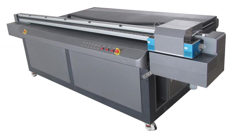

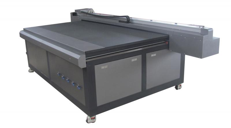

i'll be in china in three weeks at the china sign expo looking at the new dual dx5 LED flatbeds. of all the chinese flatbeds, the winwin/ntek looks the best. over the next five years the overhead metric will be greatly altered by shops running these printers. from a speed/resolution/serviceability/replacement parts cost it will be tough to beat. a 6x10 dual dx5 LED costs $38k.
i have a video of last year's model running if anyone would like me to email it to them.
artbot
attached are two photos of the 4x8.
there are four different sizes.
i asked the company to print on some sintra and film it for me. of course
in china, i'll be bringing my own sintra, coro, gatorfoam, petg, polycarb,
pmma, glass, dibond, aluminum, canvas, styrene..... the works.
i'm not sure if i have "complete" permission to post upload this video but
they didn't express that it was private. i believe this is a printer that is the chinese model (RED!). i'd assume that what i see in china in three weeks will be similar.
all in all it looks like a confident machine. gravity feed just like a roland or mimaki, cheap ink, white and varnish capable without "upgrading", the sales staff speaks excellent english (i'm quite impressed), i believe the service manual will be available to all and edited by someone with a master's in english from what i'm told.

that was pretty impressive. dual dx5's with LED lamps?
THK Rails?
I like it. My only complaint is that the sheet metal on it looks like it would bend if you looked at it wrong.
Please get a good amount of detailed photos when you're there. I'm interested.
artbot
stock build is hiwin rails. a THK upgrade is available but i don't remember how much. i think i read that you could pick which rails. of course the gantry would be the main place to upgrade. THK on the x rails wouldn't seem to improve performance.
the rigidity is one thing i want to look at. i plan on printing on a lot of very heavy glass. i might have them add a "slide out" that can be bolted in to the table for heavy objects.
it will be really interesting to see all these printers up against each other. the trade show is massive. i also like the longrun konica printer for $42k. but then it's the subtanks and negative pressure and expensive heads low res'.
also, i'll be looking at the ink cure. i'm not at all concerned about the machine itself. but i do want to confirm that the LED is beefy. the mimaki jf's had so much trouble curing they later added a "post cure" lamp.
