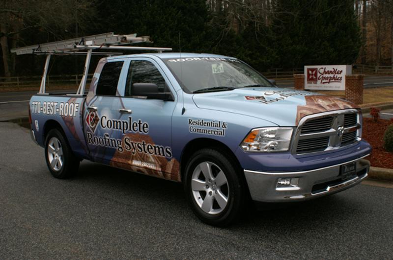

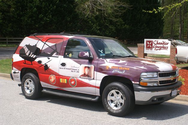

Our company prints the wrap material for another shop and I get hired as an independent contractor for the install and do the installs on my weekends. Our question is, how should we help the other company with the warranty on the wrap? Just for show I am posting pictures of some I/we have done.
