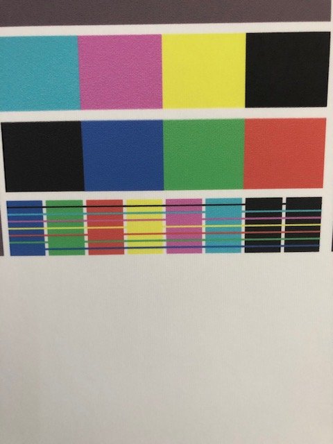

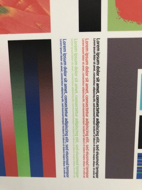

I lowered the ink density and increased the optimizer to 40% then I ran the image test. no joy. See mid section of small text in image 1881. Everything else looks fine, images color etc... could this be a printhead?

I'm surprised no one mentioned this yet, but what is your ink density? After printing on phototex and other fabrics for year's, that inconsistent haloing is actually the ink bleeding into the fabric. It can be solved by reducing the ink density.
Being a fabric product the fibers can draw ink into them. I bet if you print the same file and same profile on a vinyl substrate you will get different results.
I do know what you mean but if you look really closely I think you can see that it's not bleeding but in fact it's a halo from movement.
You need to start posting better pictures mate. And forget the optimizer, it doesn't help past 25% and probably even less on fabric sort of surface.
When it prints that spot you need to look at what's going on.

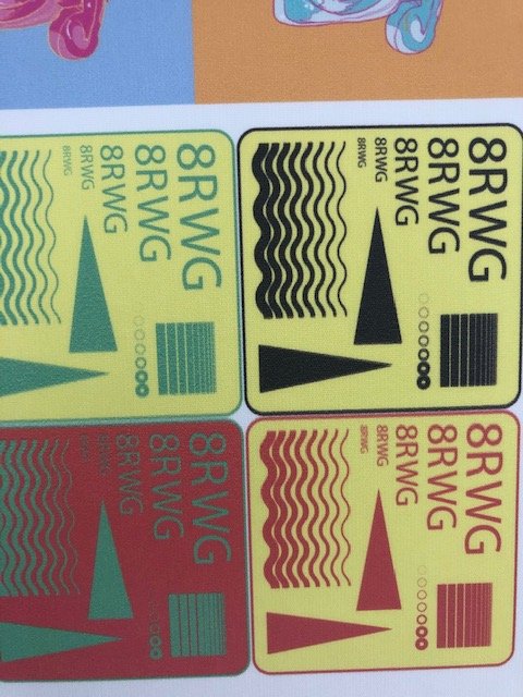

I figured out the problem. The black type was a process black. I went into onyx and rest the black to 80% with all other colors to 0. Problem completely solved. text is crisp and different bolds and light fonts are perfect in all sizes

tHe problem is back, after many rounds of the same prints, I had to do a large mural printed on vinyl almost 4 rolls of material color photograpsh. That print went fine, now I am back to printing these small labels on phototext and the haloing is back. So far I have tried all my tricks that worked in the past. Increase text to pure black at 80%. Different profiles, increase vacum. On tke up reel off take up reel. Clean the printheads 5x, check the nozzle drip count. WTF is casuing this problem and why is it so erratic!
