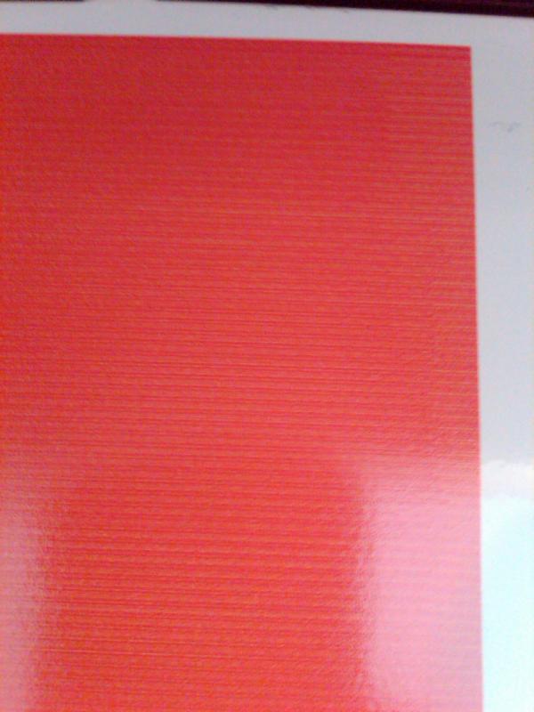

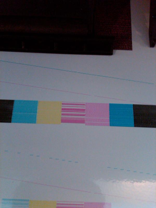

So I have replaced the print head, and damper, pulled ink through, made sure the damper is full, etc. I have run several heavy cleanings, tried soaking the heads. This is what my test print comes out like and I dont know if you will be able to see it but I also attached a pic of a solid red box to show the "lines" in it.

IE clean it more...it has half of the nozzles missing. you will never get a good red from it...to make sure its not a media feed compensation issue, print a green box (only using C and Y) - if no banding, the nozzle drops are culprit - maybe soak it a bit more?
randya
Start a soak and rewet with fresh cleaning solution every 20 minutes or so.
If after a couple of hours you get no more new nozzles, the head could be damaged or unrecoverable.
Headhunterx
Try warming your cleaning solution in the microwave for about 30 seconds and then let the head soak while the solution is warm.
