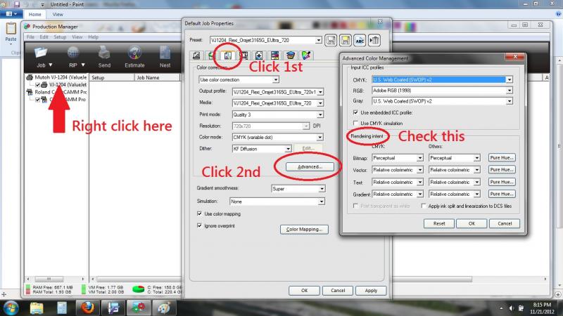

thewvsignguy
make sure you are using the right profile and check your rendering intents.
in flexi production manager on the left side, right click on your printer.
select the default job properties, then click on the color management tab.
next click on the advanced button or advanced color management, in there under rendering intents make sure under vector or text is not set to "no color correction" try the relative colorimetric instead.
this should get the colors closer to what you see on the screen and it you change your colors to RGB instead of CYMK might help too.
You will have to play around with the settings to get the best results.
The screen shot is using flexi pro 10 so your 8.1 might be a little different.

Matt-Tastic
more to the point on his screen shot, make sure you have "use color correction" selected from the top dropdown on the third tab.
That kind of thing often happens when no ink limiting and no icc is being used. make sure you have that selected.
