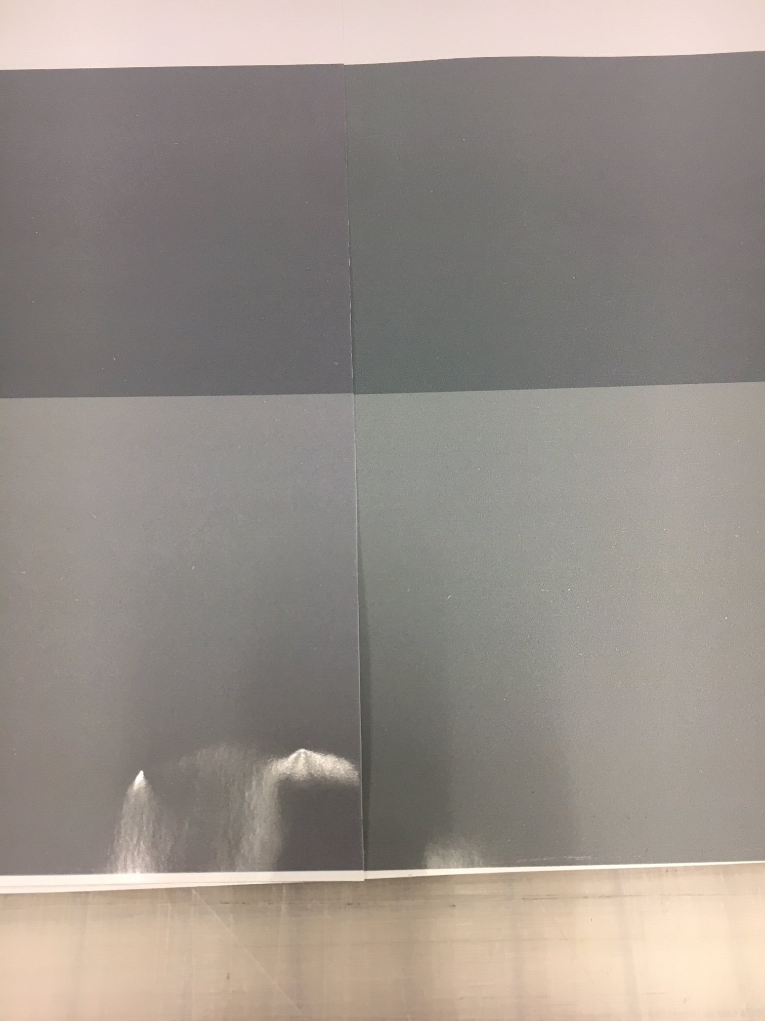

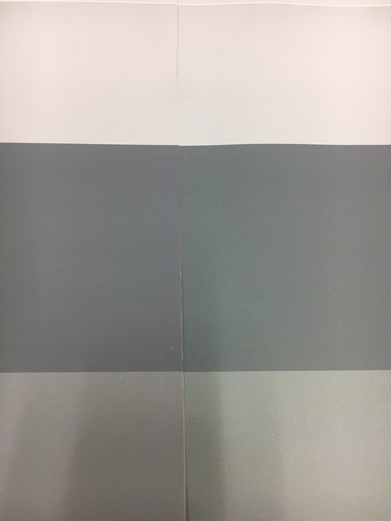

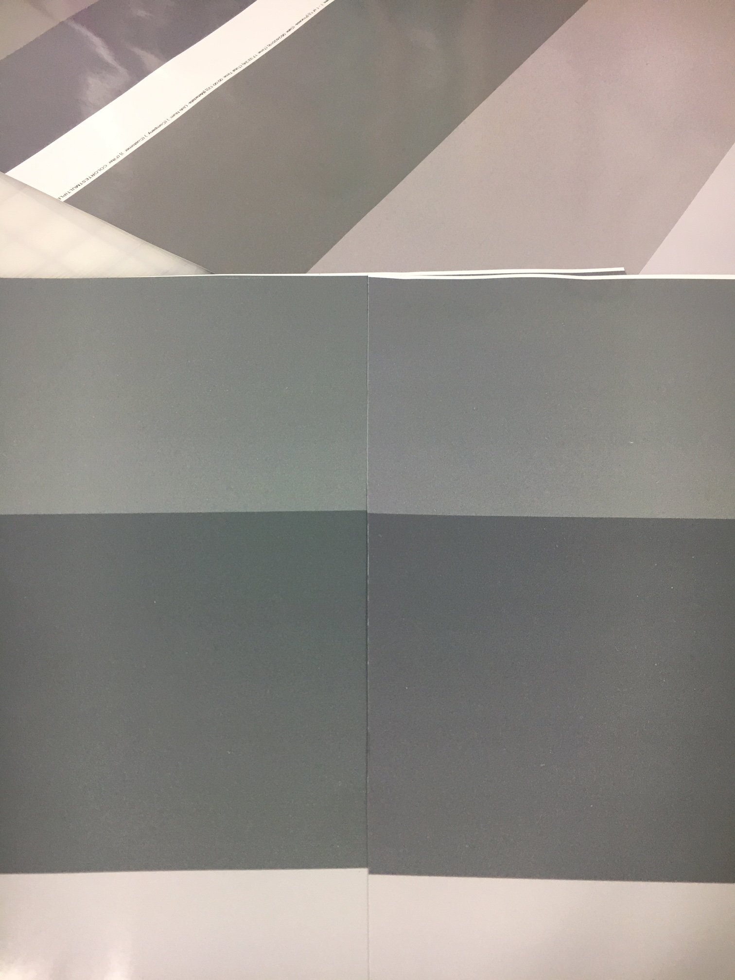

    Attaching a few examples of what OKI considers the norm for its printers on a standard quality mode. The side by side prints are of the same color bars slit down the middle and overlapped. They are supposed to be the same color all the way across like they used to be.

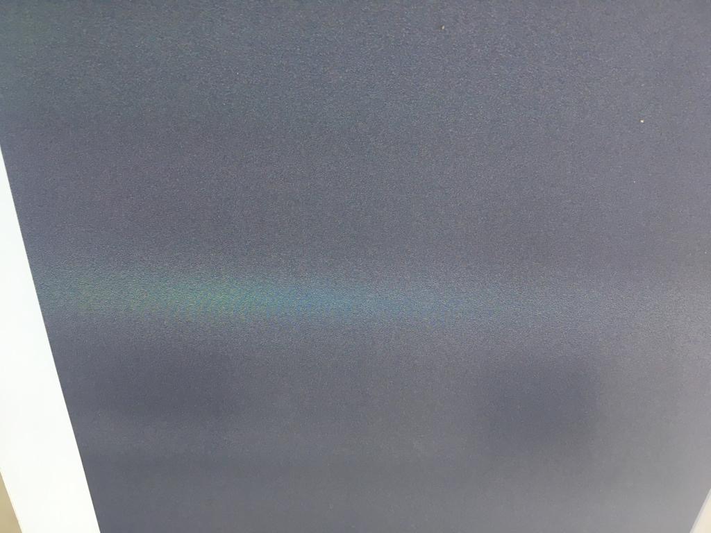

    Dear all,
    we have a similar problem like Boss Wraps. Horizontal stripes in colors like grey and blues. Stripes in HQ are cca 9cm. We tried to mix heads without results. Printer is new (E-64s). Tried different materials (most vinyls), different resolutions, different temperature. Humidity and temperature is normal. Solid colours are stable. What do you suggest?

    Sounds similar to what we are dealing with. Our variance in color isnt as drastic as that image though. Weve tried different heat, materials, profiles, even rip software and the same thing happens. I honestly dont know what is causing this issue. All I know is that the machine is under warranty and it should be addressed with urgency from the manufacturer.
    Sorry your dealing with this as well...

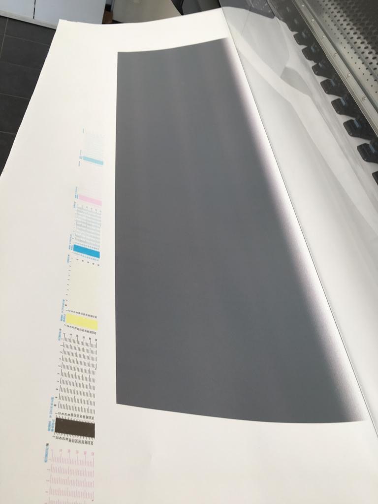

    It appears from your pics light cyan is dropping out. Turn on Color Stripe in CP manager so you can see exactly what’s dropping
    • Like Like x 1
