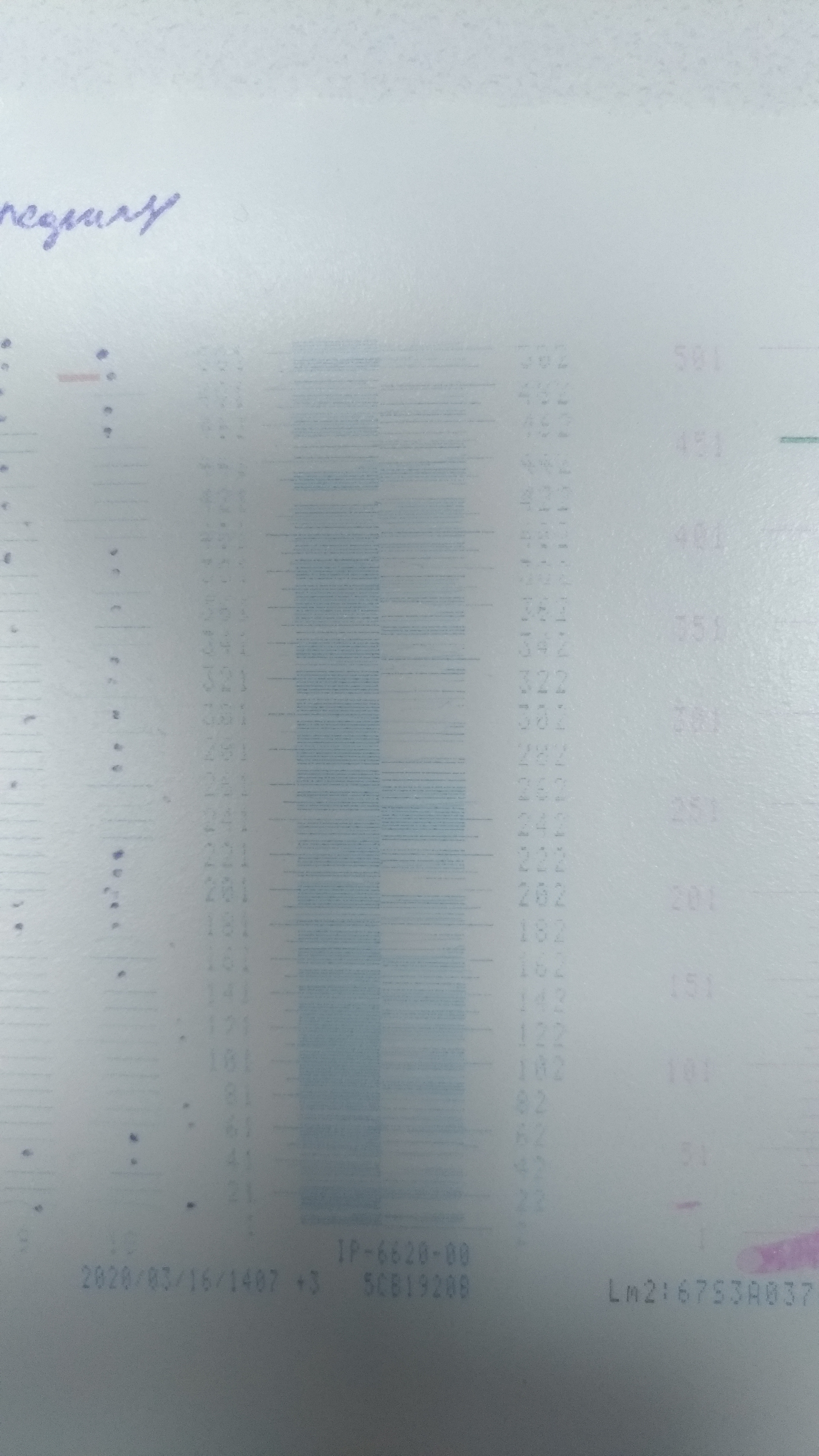

Hello,
Please help me with the problem on the ColorPainter M64s printer.
Nozzles began to disappear on the print head in Lc color. When printing the test, you can see how the nozzles were not completely printed, a drop flew to the side, more than 20 nozzles were completely absent. After printing especially gray and halftones on the test, almost all nozzles from the top of the head were not printed, so the nozzles disappeared directly during printing. Ten washes on STRONG did not help.

I am attaching a LC nozzle check to this post.
Are there any other cleaning options?
Is it acceptable to use rinsing solution + DMSO to clean this type of head?

Joseph44708
I Drink And I Know Things
Dont Waste Your Time.
My W64 did the same thing on the Magenta print Head. I tried all the cleanings and soaking, nothing helped. I bought an new head from Digi Supply. I'm back to printing full speed.
