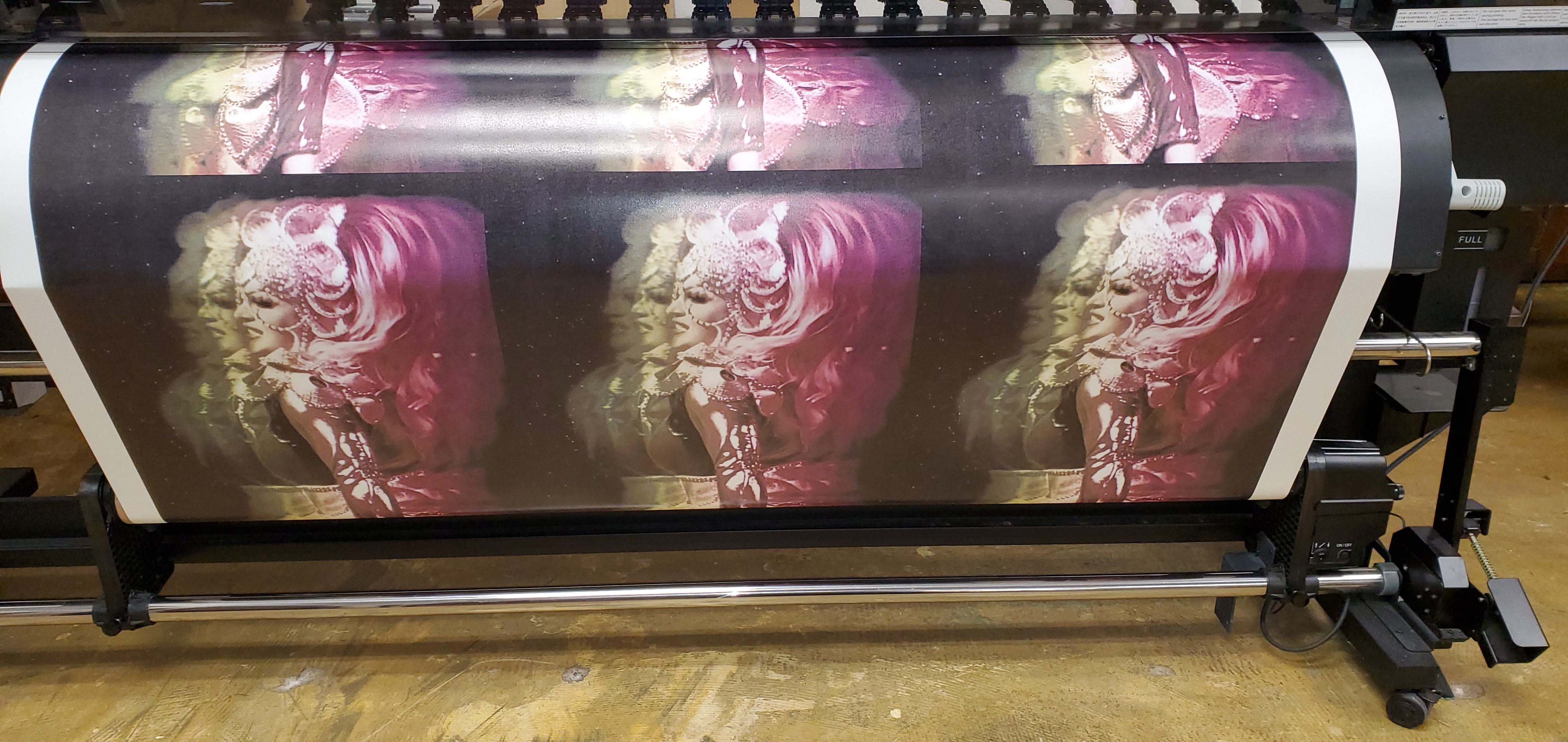

    Hey fellas, I just recently purchased a mimaki ts300p-1800 and a practix ok12
    I own a fabric store and have for the longest time wanted to get into fabric printing. so i came across a great deal on this used equpiment.
    The printer has some issues with the nozzles, and for the most part it prints great. but there are times when it leaves blue streaks across the images. There are quite a few nozzles that are clogged but the nozzle recovery works well. but the streaks are causing me some issues.
    im able to do some head cleaning and that clears it up for a little while but it returns after printing about 10 or so yards.
    Any suggestions and advice would be greatly appreciated.

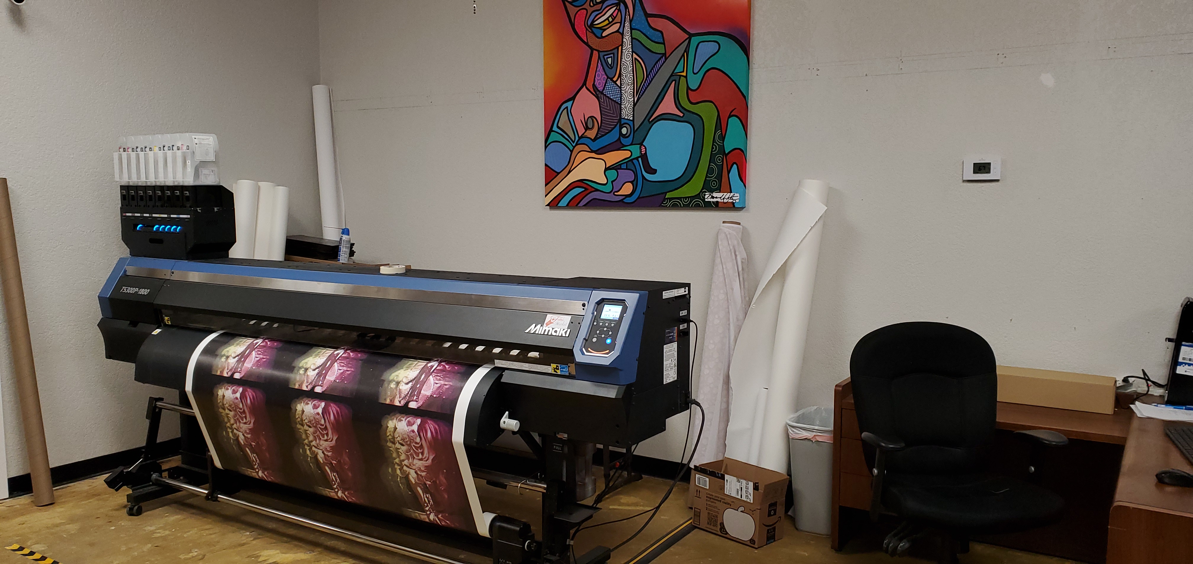

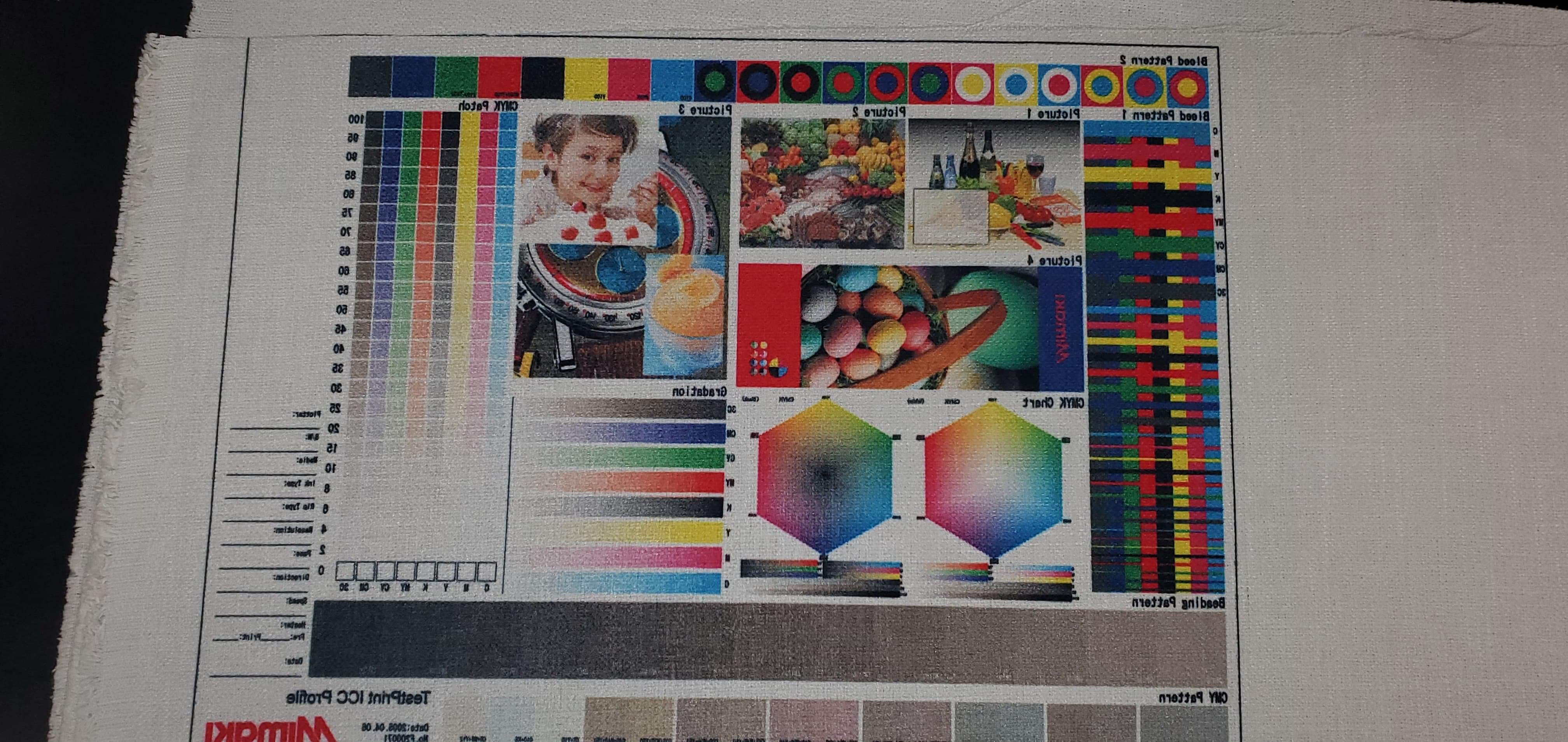

    This is my printer, mimaki ts300p-1800
    This is my little heat press

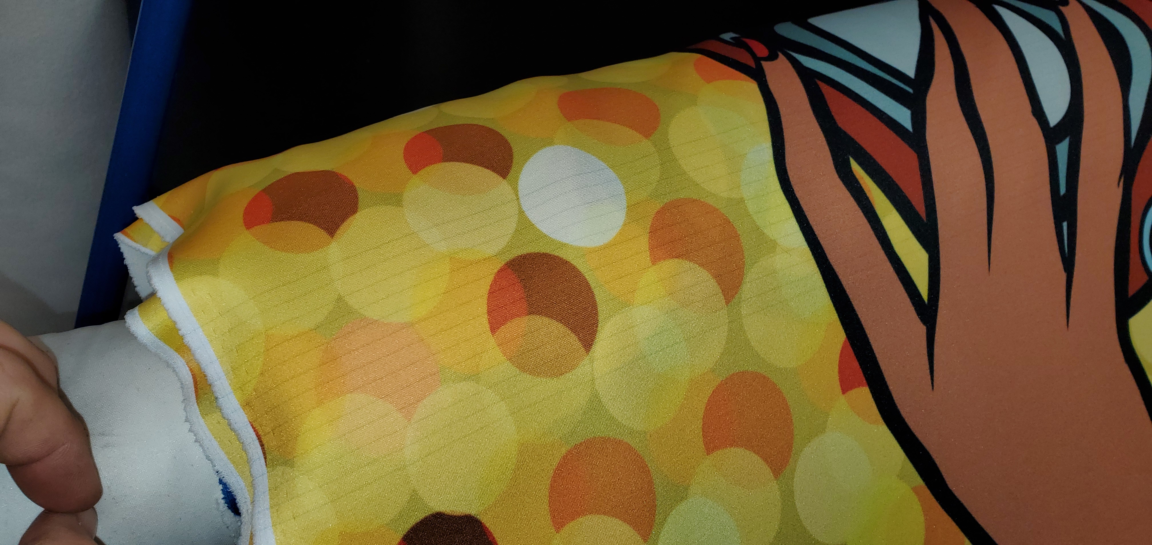

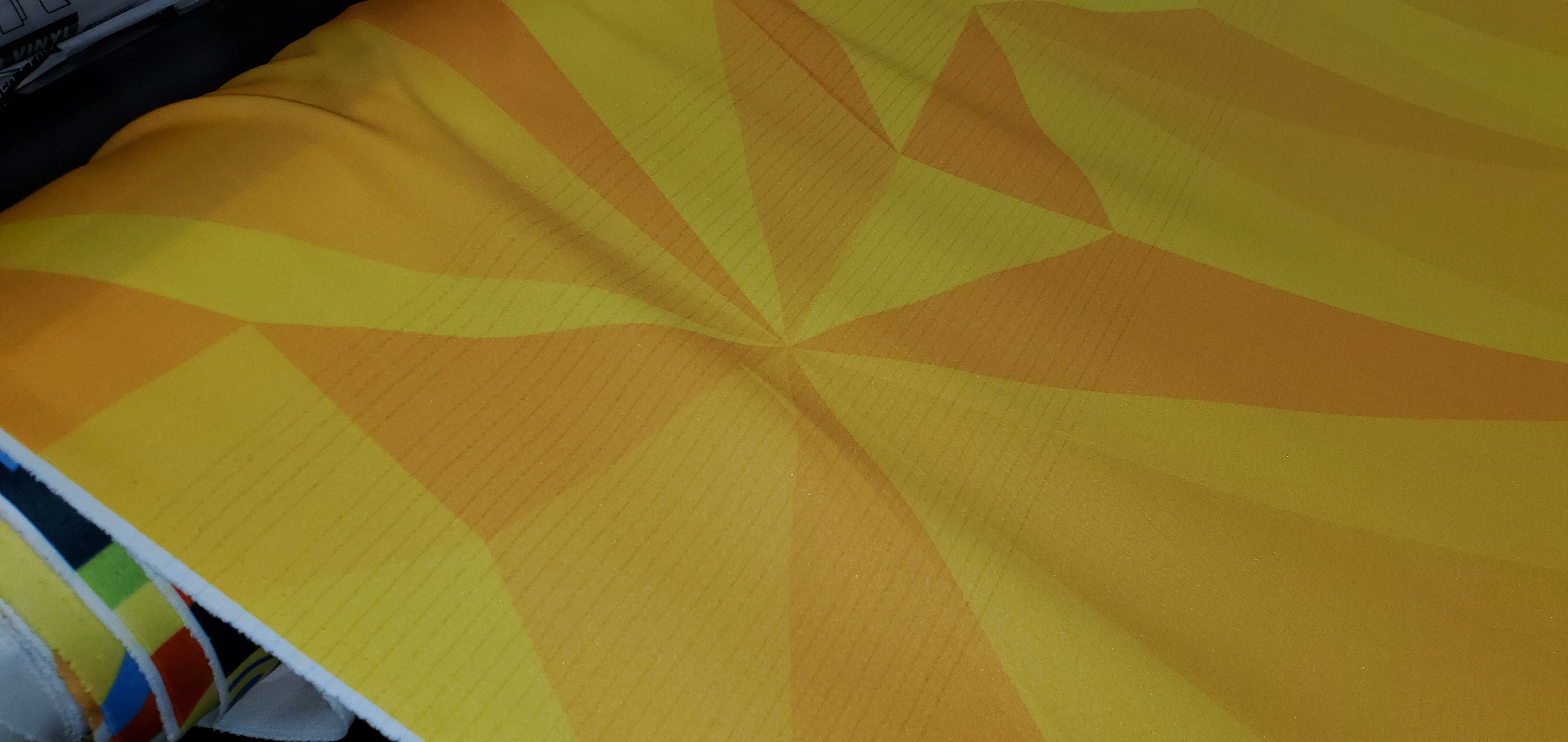

    And this is the problem i'm talking about.. this i didnt catch until i pressed onto fabric.

    From who did you buy the printer and did they offer you any kind of maintenance or warranty package when you bought the printer? Normally when I see banding like what is present in the sample photos I would suspect a faulty print head. One of the ink heads might be going South. Obviously the first trouble-shooting measure is to run a cleaning procedure on the printer. But if repeated cleaning steps don't solve the problem the next step is to visually inspect all the ink lines or anything else visible to check for clogs or anything else that could be an issue. Then it comes down to print heads. They do wear out, and wear out in any kind of printer. We have a pair of HP latex printers we swapped out heads on just this week. And we have a Mimaki flatbed that has, so far, been holding up pretty well. Still, it's a fact of life we're going to have to shell out a good bit of money frequently replacing parts on these printers.

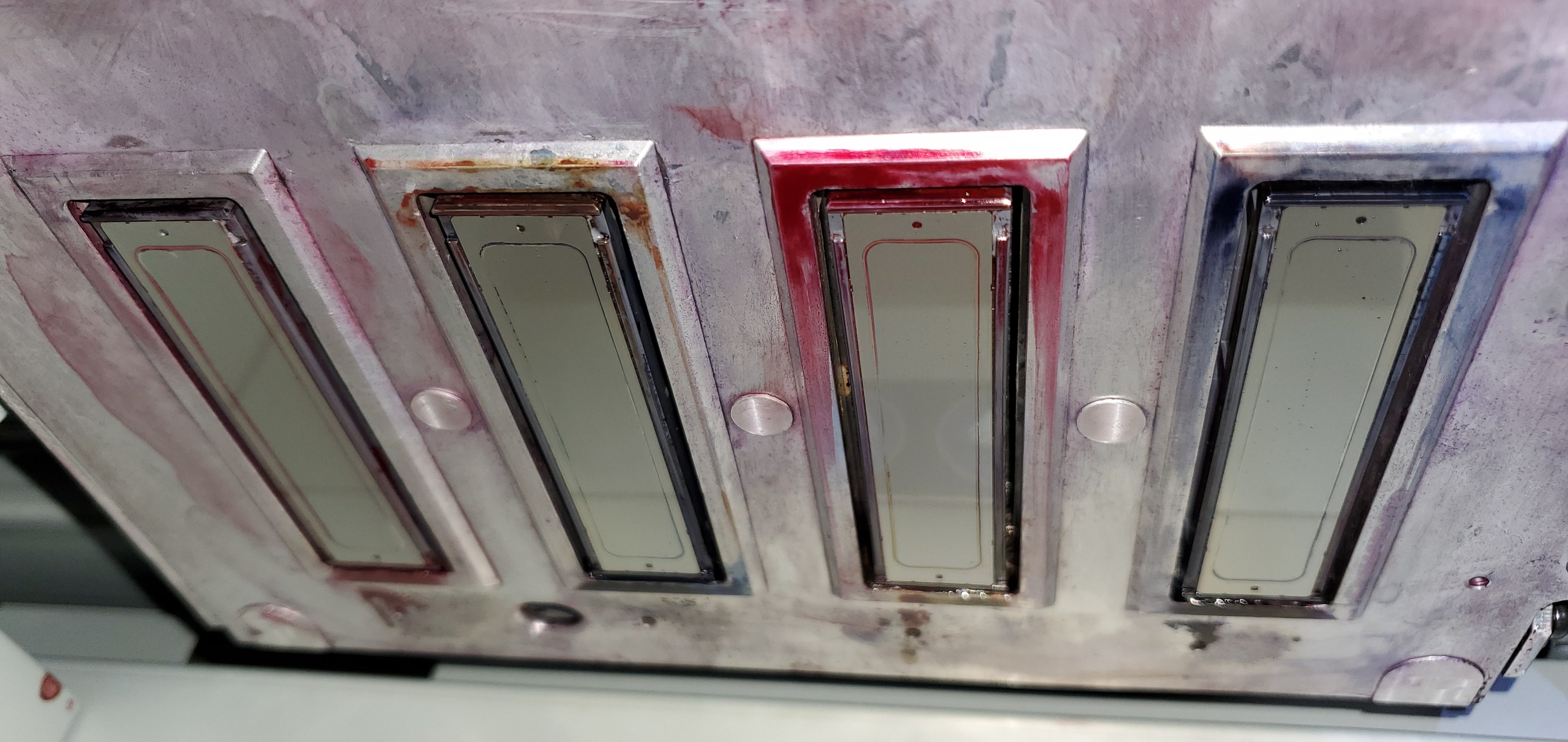

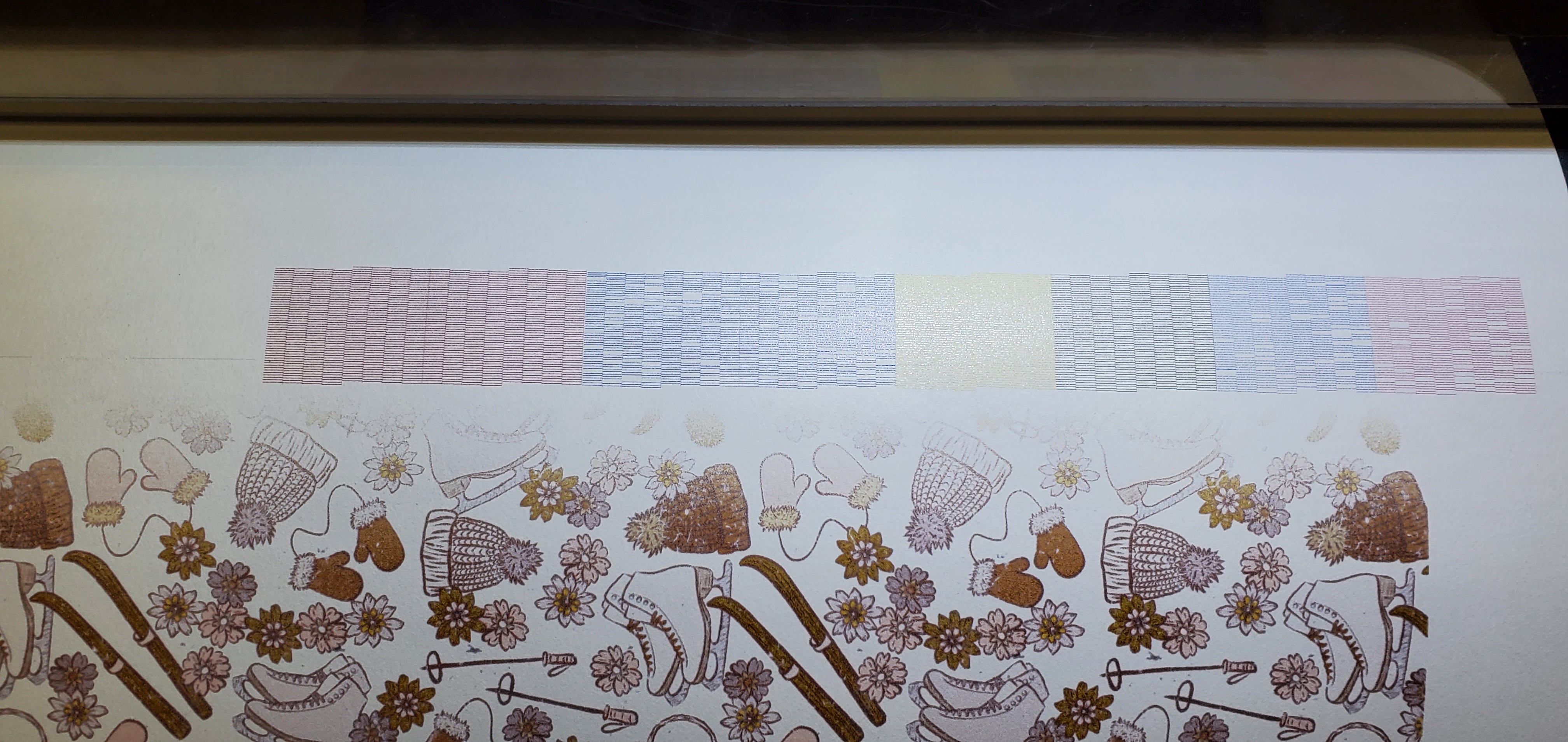

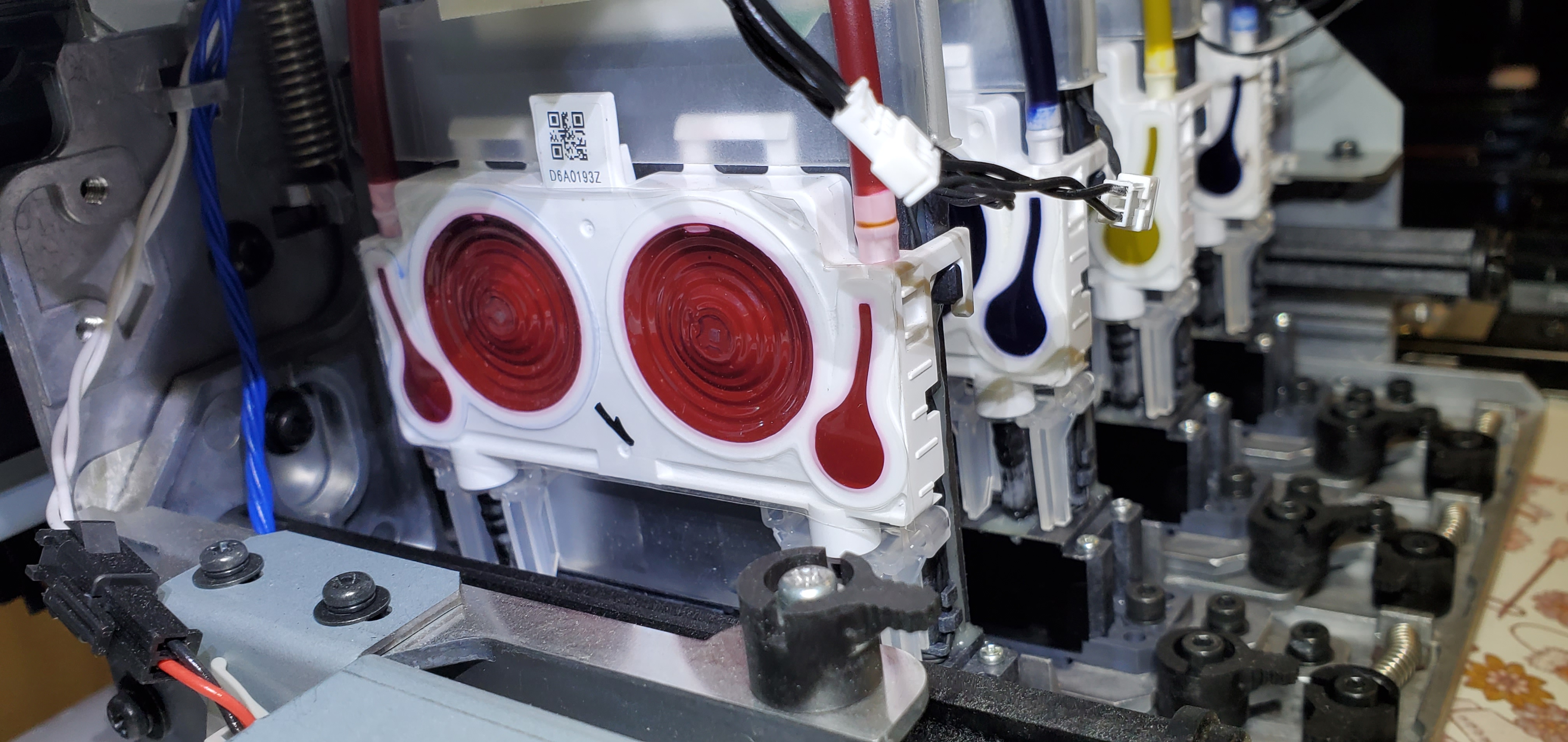

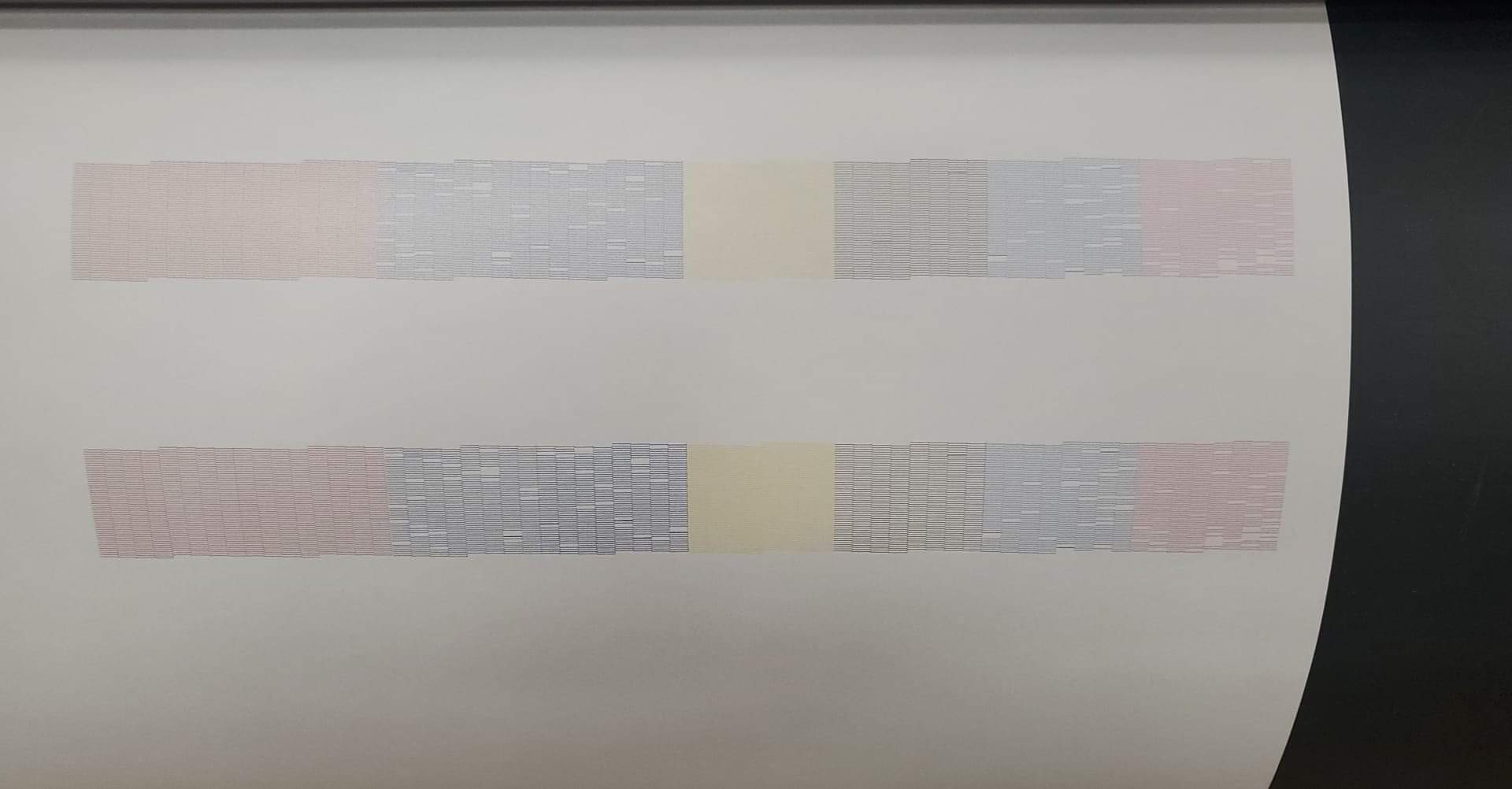

    This is how the heads look after printing 30ish yards
    The streaks are much more visible here
    The test prints show a lot of nozzles are bad, despite multiple cleanings, washes and pretty much all I can throw at it from my limited knowledge
    However despite it looking bleak, somehow it prints beautifully and has done so, its just that leaky blue ink.... received_1092290397889752.jpeg

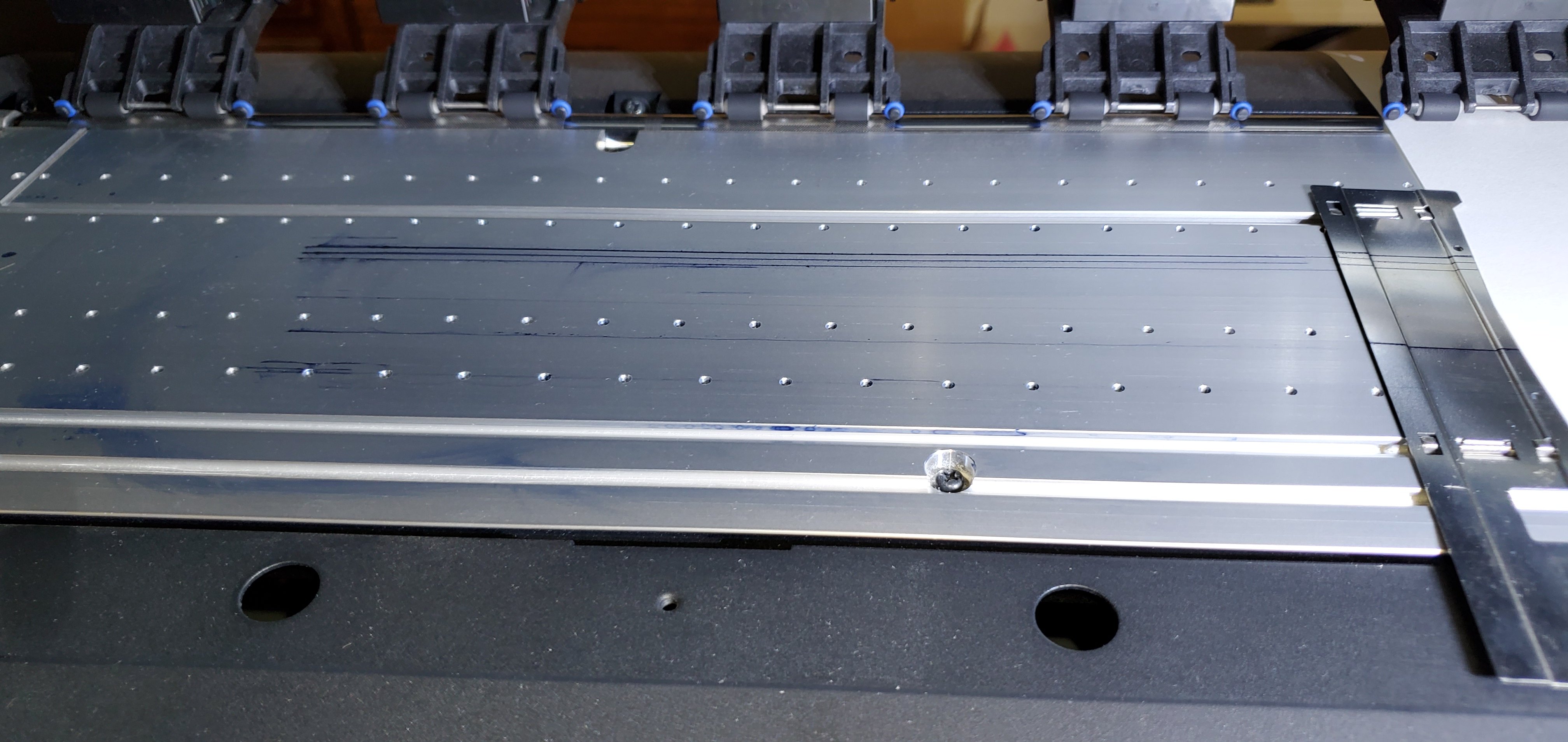

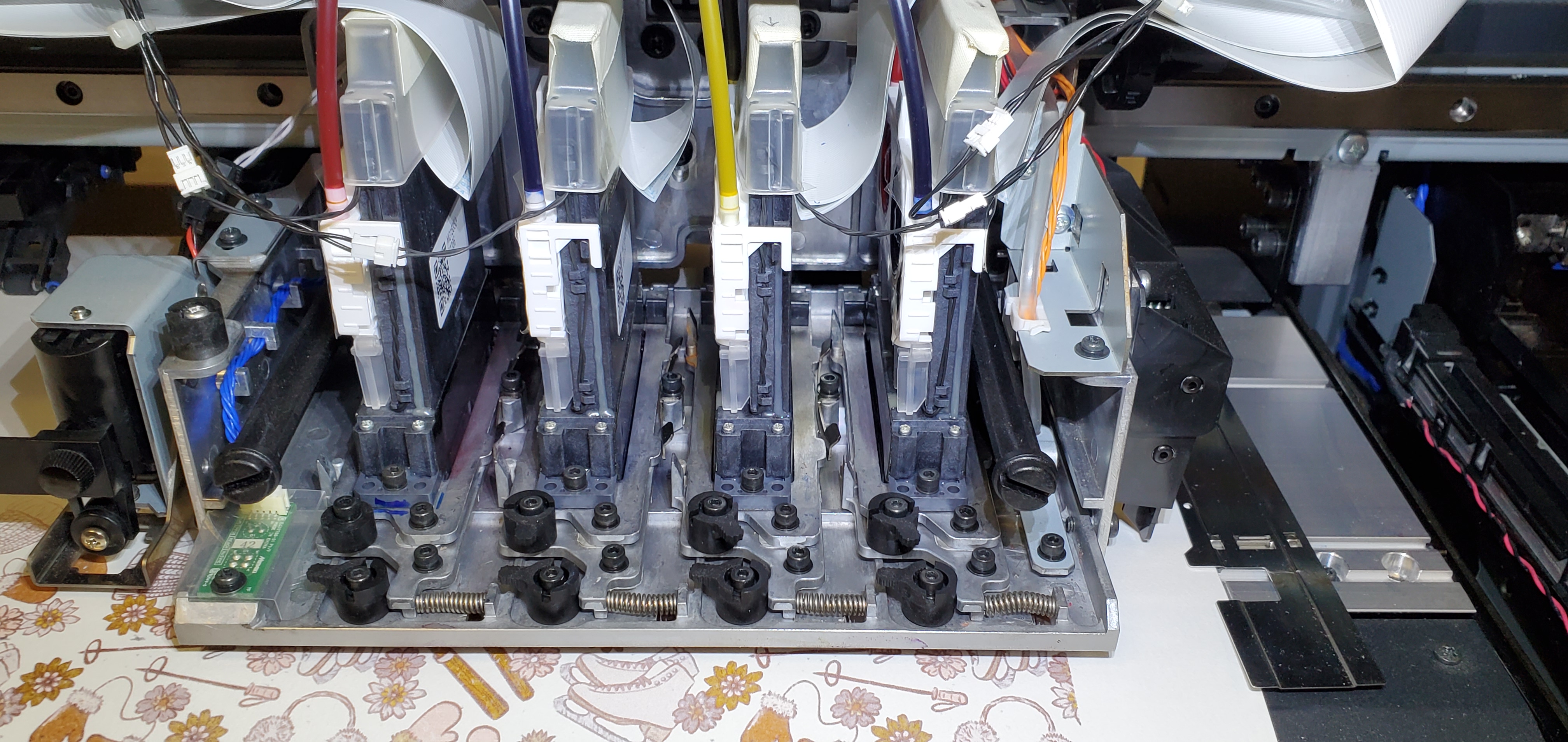

    It looks like after many cleanings, both manual and via the menu, it is not getting any better.
    Any techs in the OKC area or nearby willing to travel?
