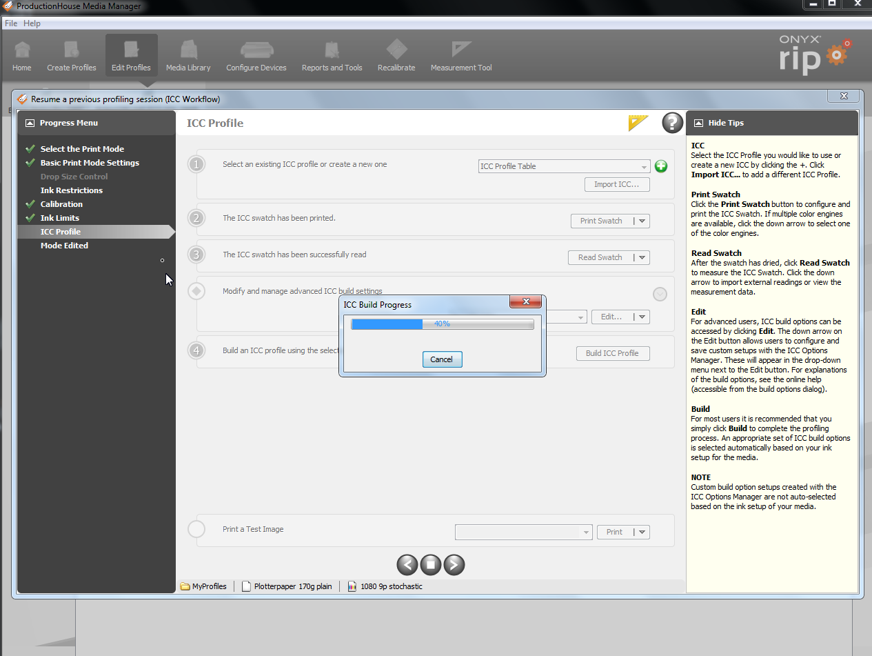

I've started to create a custom profile....
The thing is when I click on "Build ICC Profile" the process stucks at 40%. I spent two hours in vain... nothing has changed.
There are two screenshots I took....

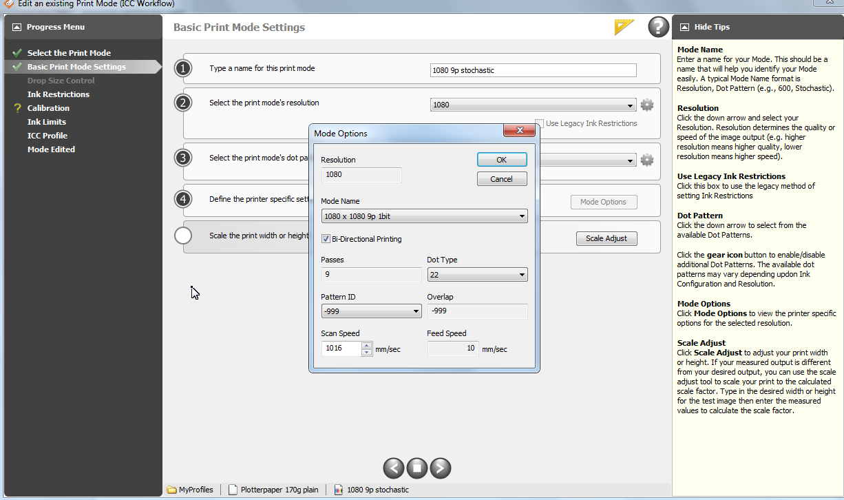

What I'm confused about is that ID and Overlap have negative values.

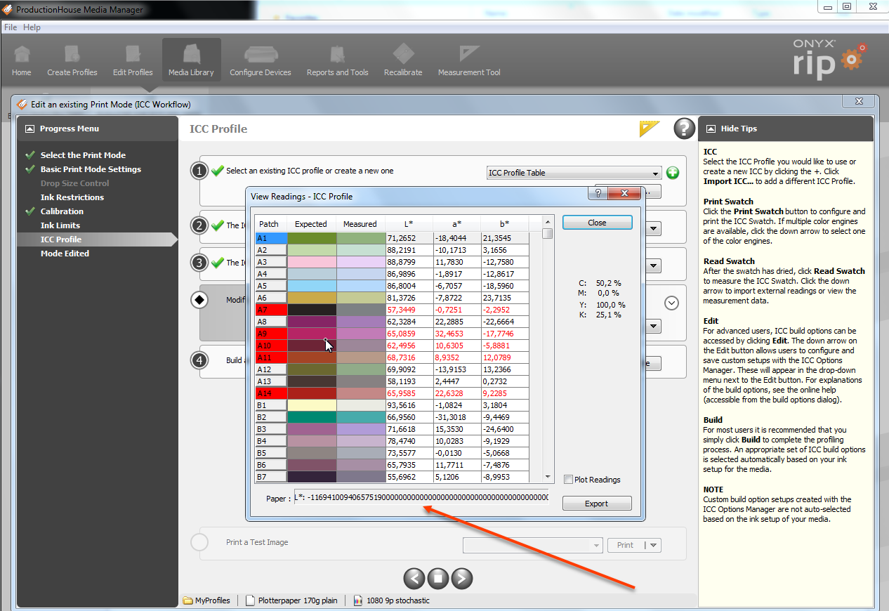

if you notice.... Paper has a negative value as well, additionally the number is huge! Each time I close and open it again it changes... I assume that it should be a constant
Dunno if it matters, I reads patches with i1Pro 2

Bly
It looks like you have a lot of patches that are not reading within range of what's expected.
All your readings look too light.
Does v11 automate restrictions? If you're setting them manually try increasing them until the patches look closer to what the software expects.
hazartilirot
Bly Thank you for your reply. Yes, it does. I was playing with the ink restriction since a graph I got wasn't smooth. Nonetheless.... Could those negative values be a culprit?
Bly
I can't remember the profiling process in 11 but you need more ink.
Try going back to the defaults and try again.

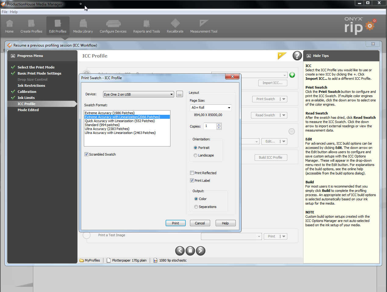

Could anyone tell me as to how to print Extreme Accuracy with Liniarization (2066 patches) swatch on A0+ format?
When I select the prefered option my printer complains that the paper size is narrow. I tried to continue the process anyway though a half of patches weren't printed....
Why does the application want to print all patches in a row? I expected the Onyx would divide swatches into many rows if the total amount of patches doesn't fit into the paper's width so that it could then be cut it into strips and read with a spectrophotometer.
I was able to fit just 994 patches to my width which is 914mm . Is there any settings in Onyx that should be changed? :(
Thank you.

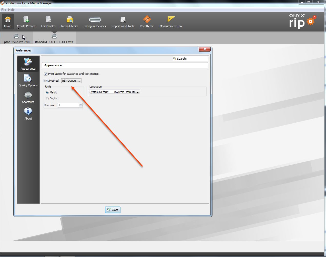

hazartilirot
Okay, thank you very much! I spent a half hour on looking for the right parameter I needed to change....:) I've eventually found it! I thought that the parameter should be in RIP-Queue..... I'll check it out tomorrow...

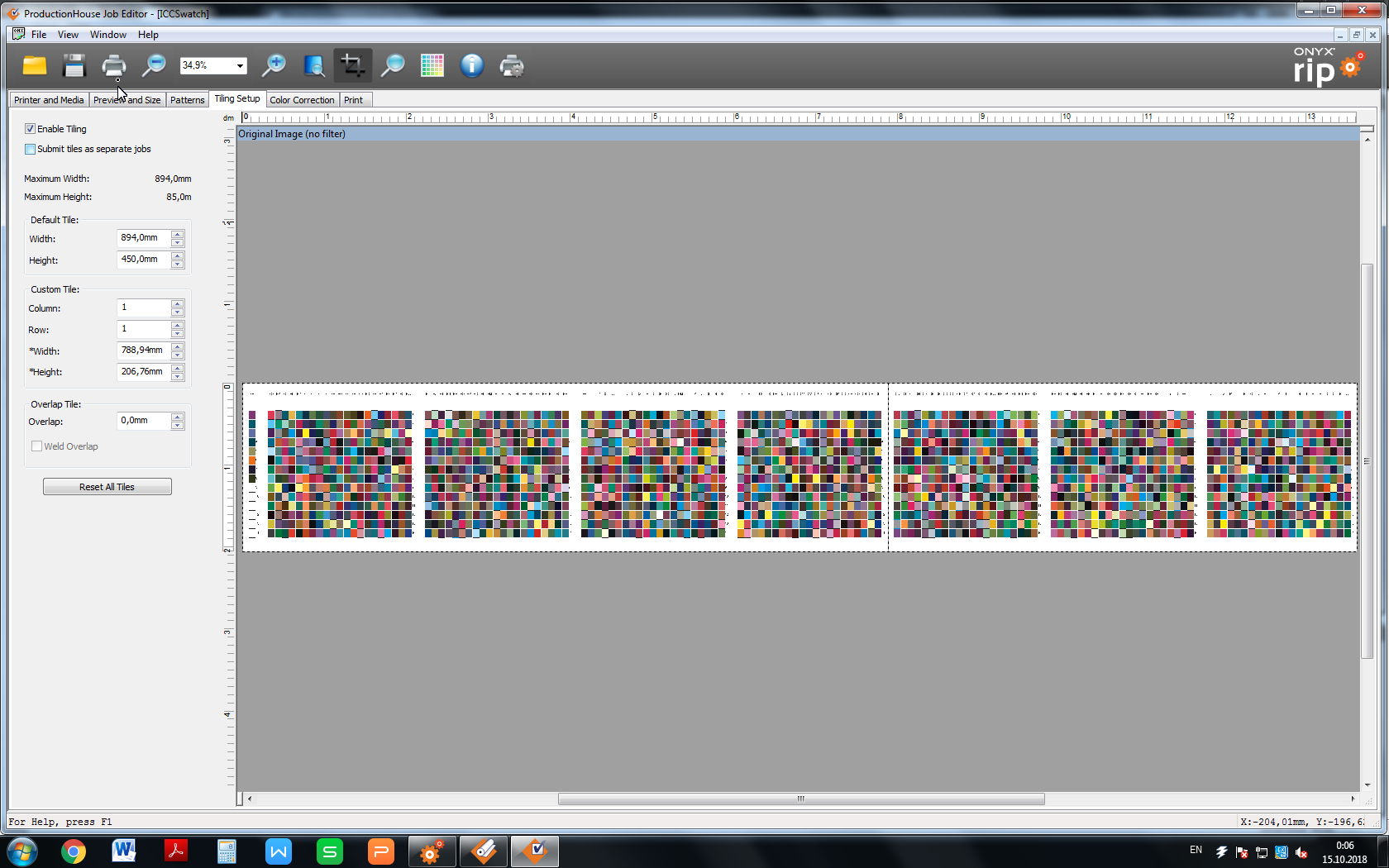

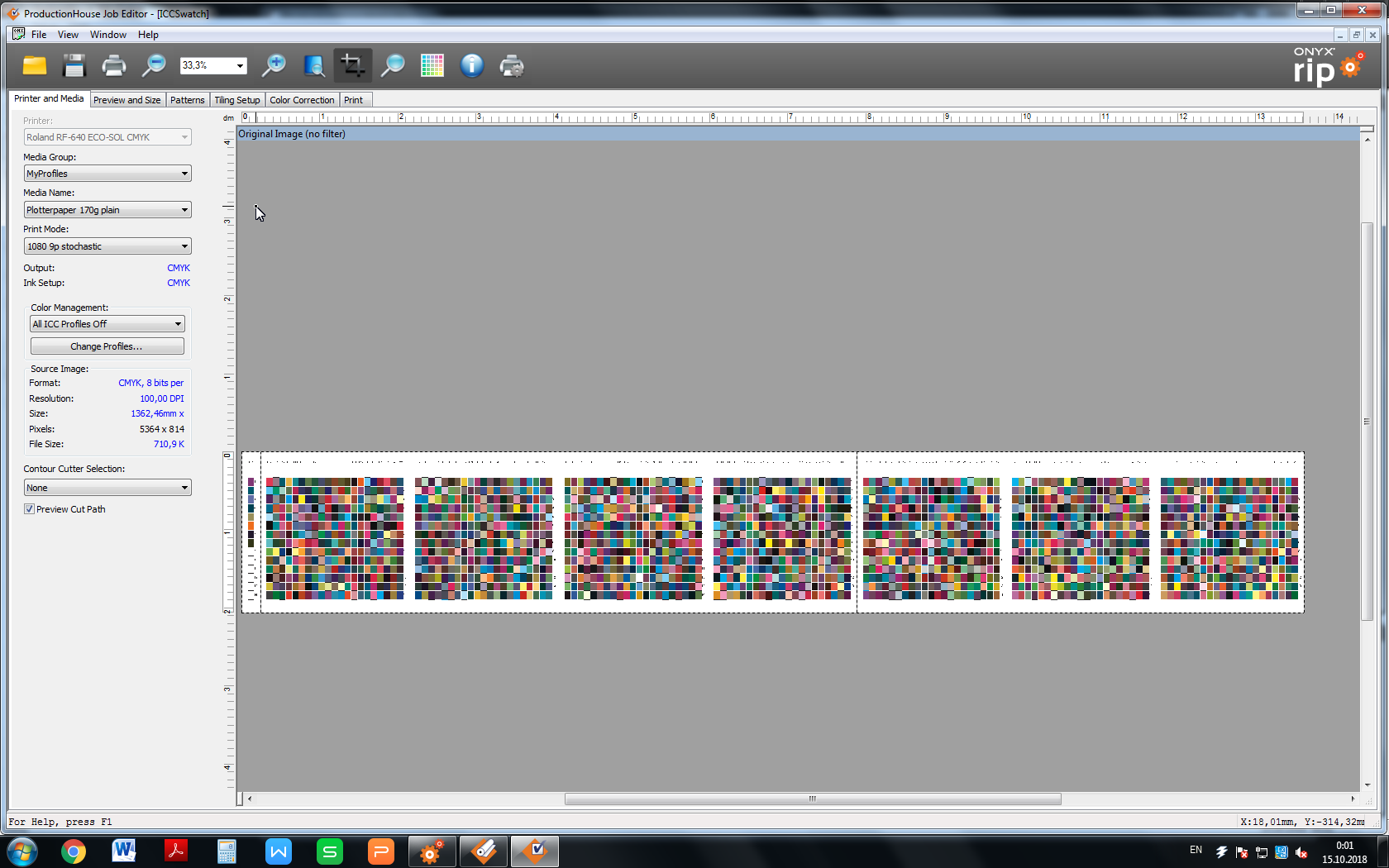

hazartilirot

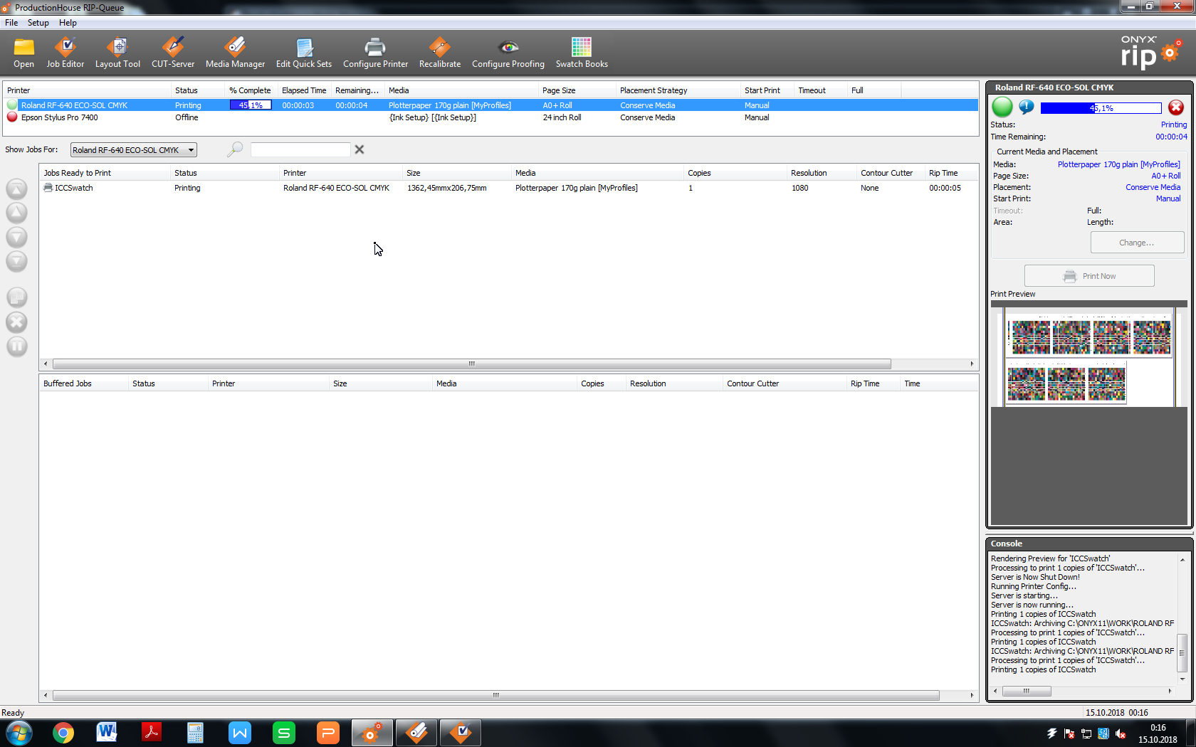

Yep....
However, the last question is Color Management. Before sending the job to print.... should I choose "All ICC Profiles OFF" so that there won't be interference?
Bly
Yes. You should just open in Job Editor, turn on Submit Tiles As Separate Jobs and click submit.

Thanks! I've worked out the issue. The culprit was the material I had been working with. The plain paper is low quality. As soon as I changed the material to a vinyl film - everything was been processed smoothly... I tried a couple of times... and each time there were dozens of mistakes in readings, mostly in dark colours.
