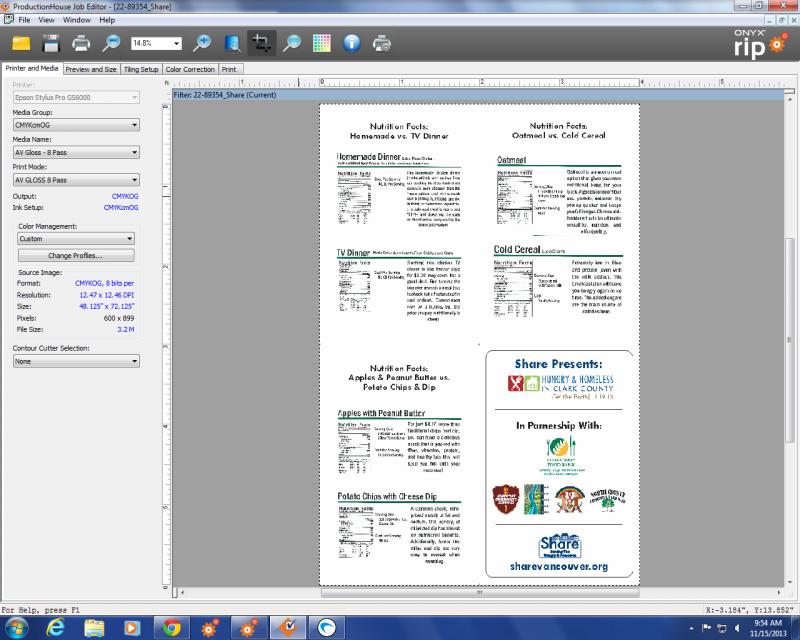

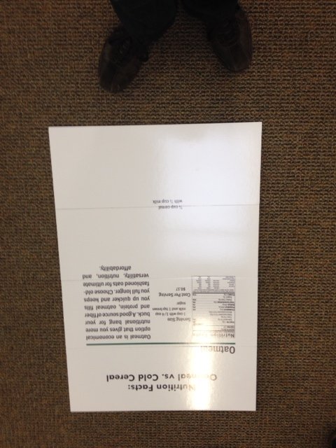

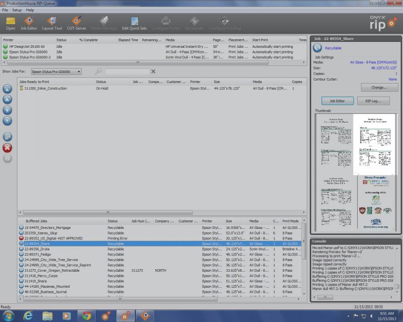

In Onyx 11 we have about 25-30% of our files print with large portions of graphics dropping out. Logos, images, backgrounds, and text all see to be prey to whatever error it is. The most aggravating part is that you cannot detect it in the preview. All jobs will preview fine, then pop off with half the file missing. I have attached some photos for reference.
