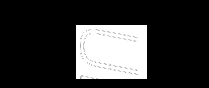

I'm sure it's just some stupid setting I'm missing. Anything I export from Corel works just fine and has 1 cut line, but from illustrator it'll cut the inside and outside of the stroke. It doesn't seem to matter if I set the CutContour line directly on the object or create an offset and set it on that, fill or no fill... Can't figure it out (I haven't been using AI long).
Screenshot included to give you an idea.

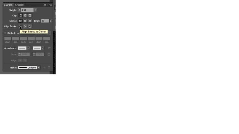

Stroke Alignment in Illustrator
Hello XtremeXccessories,
Double cutting in Illustrator is a known issue and there is a fairly easy fix. The solution is to align the stroke to center as opposed to the inside or outside. Please take a look at the attached thumbnail for a screenshot of how to change the alignment. STROKE ALIGNMENT IN ILLUSTRATOR.jpg
Christian @ 2CT Media
For Onyx to cut properly you need to fill your cut layer as the CutContour Spot color do not stroke or it will cut on both sides of the stroke.
So essentially your image should be covered by the cut path color.
