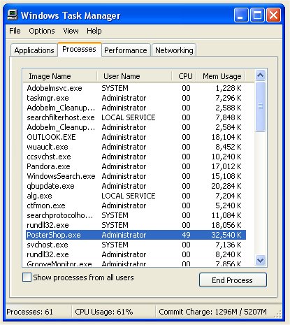

When I try to close out and restart, it then tells me that there is already a version of it running, so I open up the Task Manager, and look through there, and I see that it's still running, and taking up 50% of my processing. Does this make sense to anyone? I'm waiting for Onyx to call me back, but that generally is tomorrow sometime from my previous call to them.
Just wondered if there is a folder where these "rendering" files are stored, where I could go in and delete it and see if it unlocks itself or something like that. I just can't do anything.
attachment.php

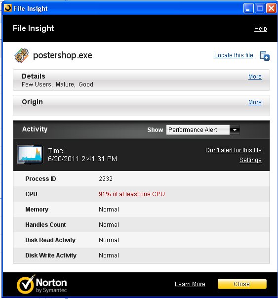

Ok, now I don't even have it open (except I assume it's running in the background) and I got this from Norton.
attachment.php

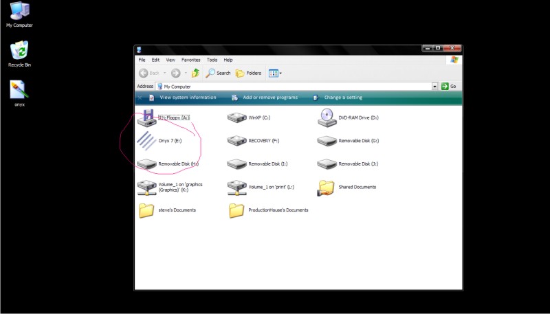

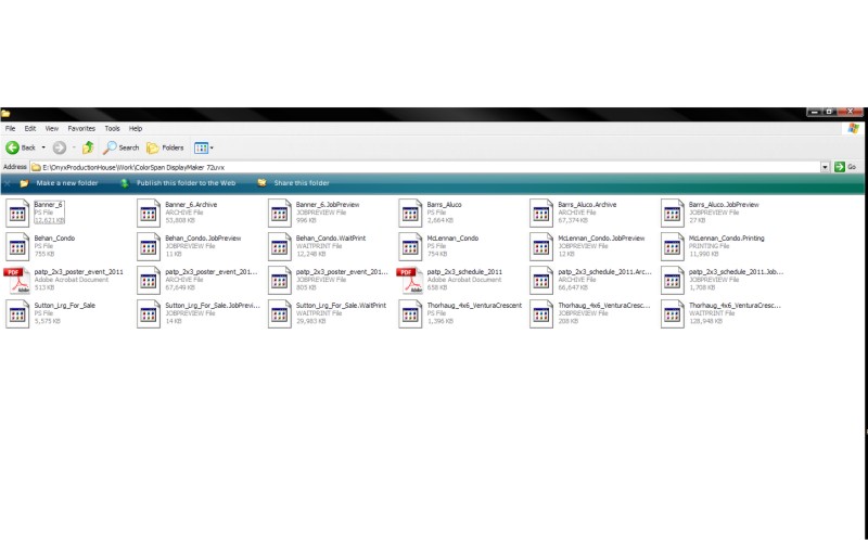

Yep, I found that folder...and deleted it, all was well then. I actually heard back from Onyx (which is totally awesome). They said that with this version (7.3.2.16) that you can't print to the maximum width on it. They didn't figure that out until they already started on version 10, so there isn't a fix for it, unless I just upgrade to 10. So basically, I just reduced the file I had by an inch, and all was well. That explains why I was able to print everything else this morning.

Kill the postershop instances, delete the job files from the Work folder, restart onyx. Rerip files, print.
And you shouldn't have virus protection like Norton running on your RIP computer, at most run MS Security Essentials. Active anti-virus really slows down RIPs.
