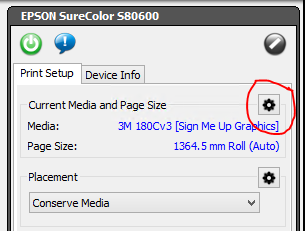

Load your media and wait for the printer to stop doing its song and dance routine, then...
Click the gear on this menu on the right hand side of the RIP-Queue:

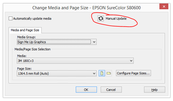

Then click the Manual Update button:
It will probably throw an error about being unable to synchronise media that isn't official Epson... ignore it and click OK.
Next screen will ask for roll length. We just leave it at the default length which is around 30 metres.
It should then return to the same screen as above, with an automatically adjusted Page Size reflecting the correct width of the loaded roll of media.
