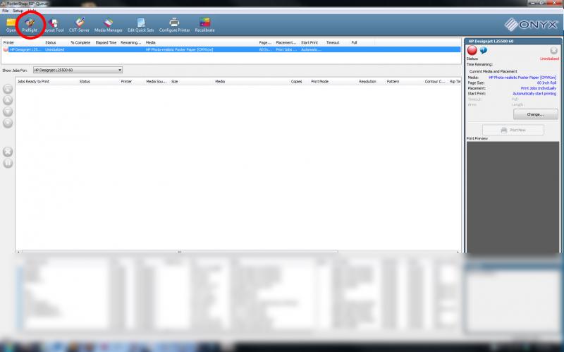

I don't have preflight.. I'd love to ditch this thing but this is the only way I see to open up files to rip them

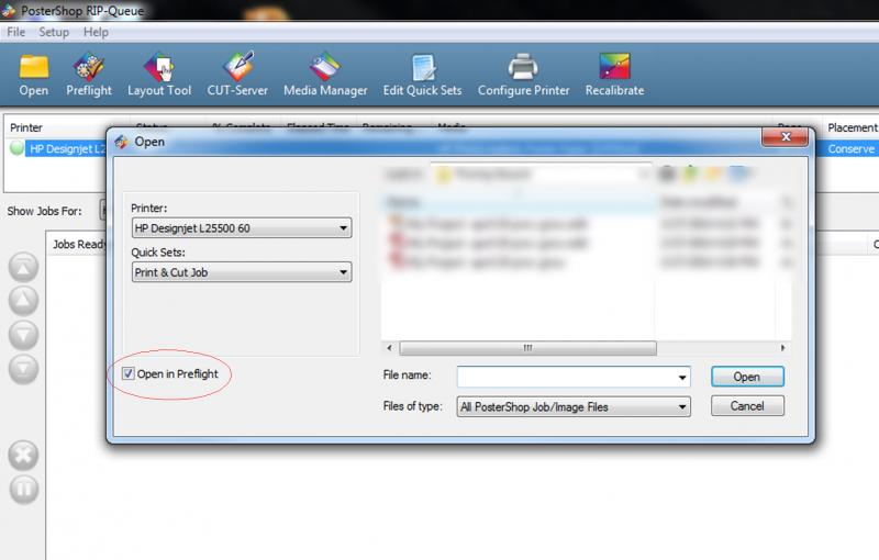

You don't have this option?
Or when you click the open folder make sure this is checked and it will automatically open in Preflight

I swear that button was always dark and I couldn't click on it... I was going to take a screen shot to show you and then of course I can now click on it.. Thanks God it's Friday..
Thanks that's exactly what I wanted to see.. I feel much better now about using Postershop.
